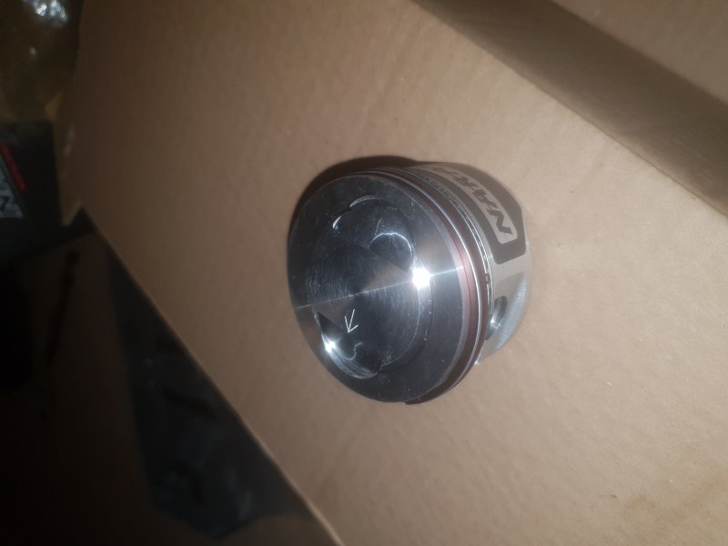

Scootboy87#3
Could someone confirm that the arrow should be pointing to the exhaust, also one ring was labelled t and one ring was labelled t2 I presume t sits at the top right?
scubabiker#4
Yes and yes. The T will be the top side of the ring too.
