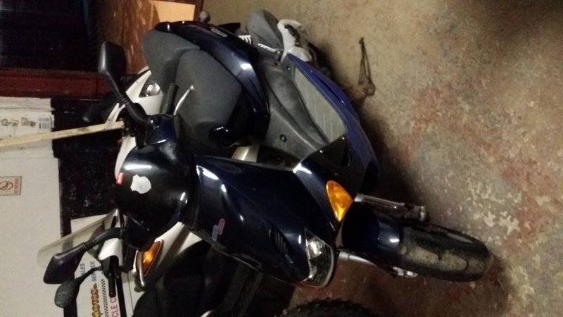

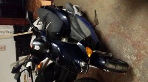

Hi all. Currently have a aprilia sr125 2000 model that im setting up for stunting.
Going to do straight handlebar conversion
Lighter rollers
Maybe 172 kit.
All comments + advise welcome!
More pics + details to follow!

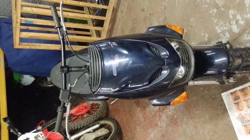

so got the straight bars fitted. I used a tnt stem that is for an aerox 50. I had to have the centre of it machined out from 23mm to 26mm to fit the SR fork stem. Then used a clamp around the bottom of the stem. Bars i used were from bike-it. They are low road style bar 740mm in width, which i trimmed 30mm off each end.
tdr125#3
Pic of the bars fitted
romain#4
Wow that does look really wide
If it s for stunt, the first fall the bar will be the first to bend
Are you planning to put some sort of crash bar?
