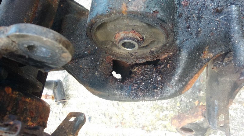

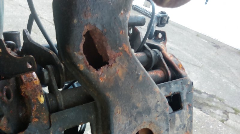

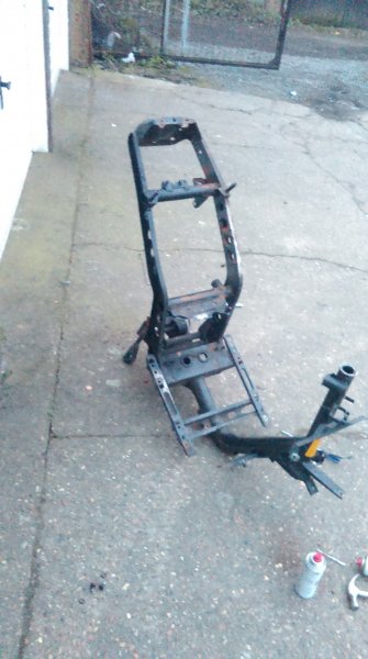

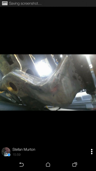

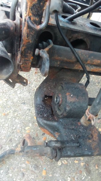

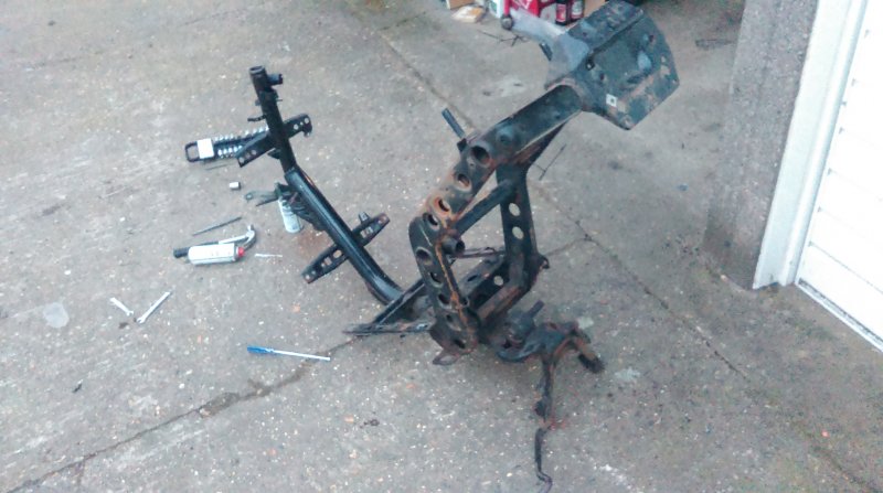

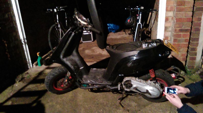

Right here is the little barging I brought for £130 I knew the kid who owned the bike b4 me and I did get put away running (put away in a leaking shed ) yes in a very sorry state and boy iv only dug the surface and found narstys Am literally saving this from the scrap man Well as any build I got tucked in straight away and started stripping the bike down Was all going straight forward Then bam found the wet fish to the face I wasn't happy as I'm sure you all can understand so I had to strip the frame right down to get it sent off for repair And after a week of waiting and 20. Quid later Very pleased with it and while I was waiting for my frame I tackeled the engine and I will have to save for tomorrow as my phone battery is going to die Hope you enjoy any questions don't hesitate to ask

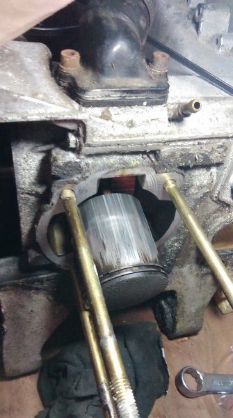

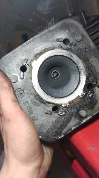

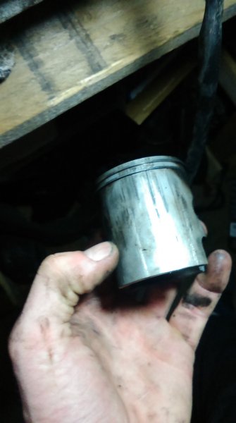

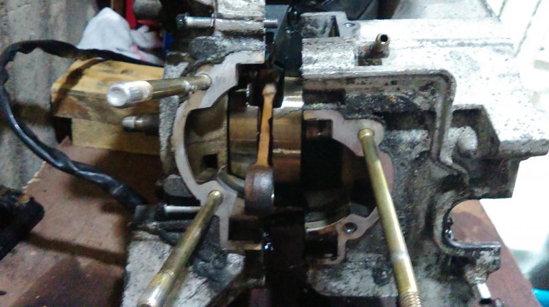

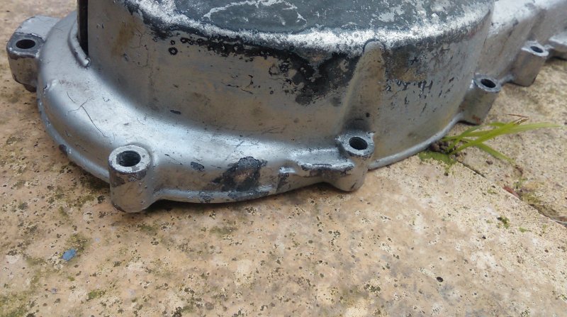

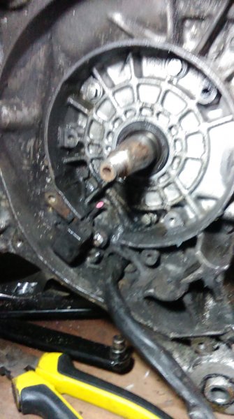

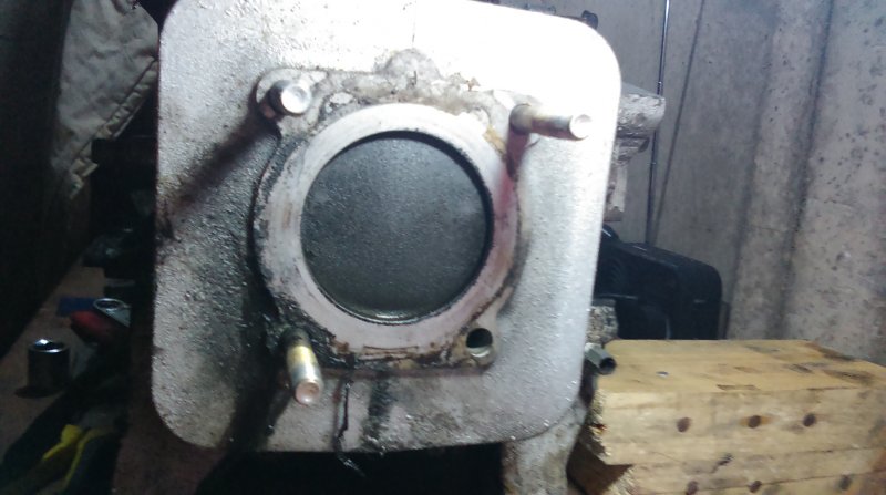

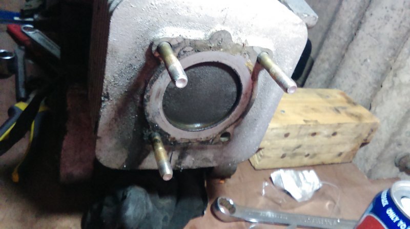

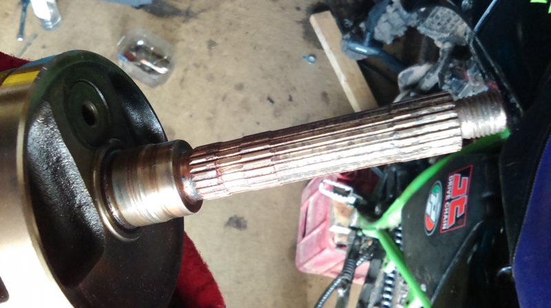

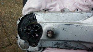

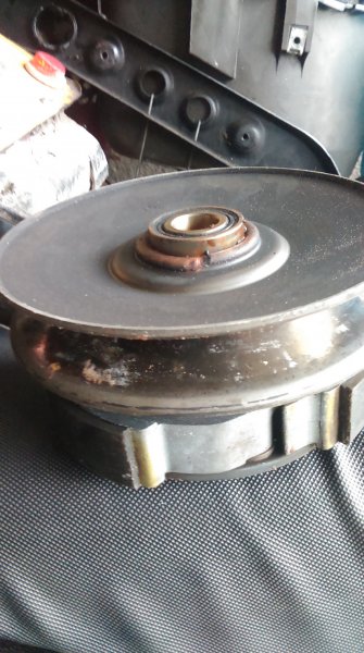

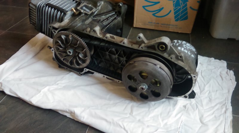

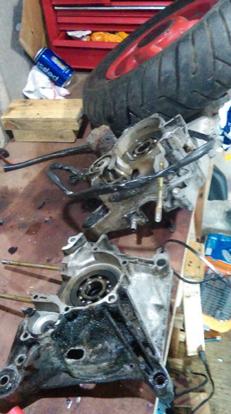

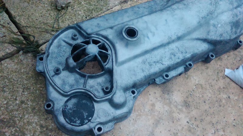

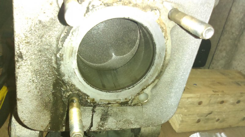

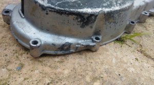

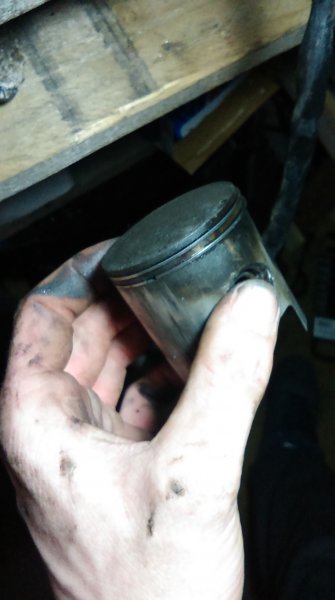

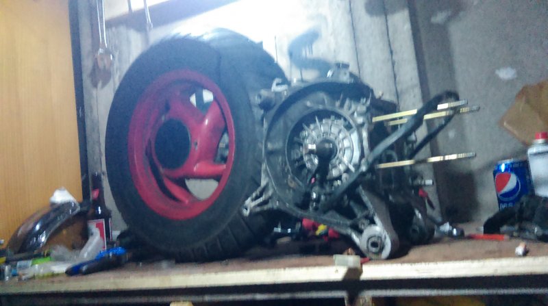

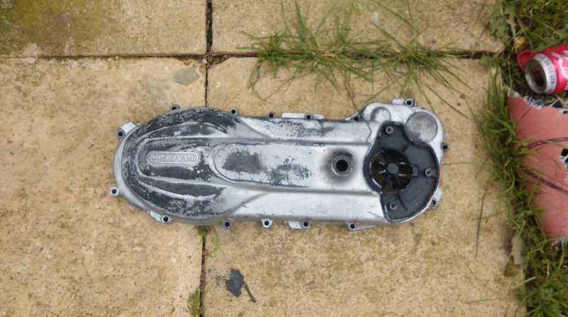

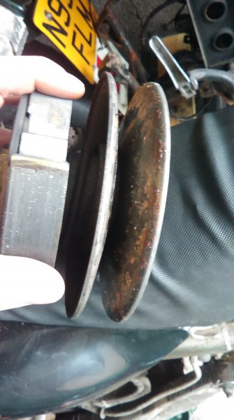

So wide awake and phones on 83% battery So I got up to the engine well as any thing I took transmission cover off to see the damage to the splines on the crank and again and just getting to it found some nastys This is pitted way to much to use would just keep shredding belts so fit for the bin (obviously not the clutch) and then some pitting on vari not good but still 130 quid bike what do I expect So after checking all them I whipped the top end off so I could split the bottom end to be fair the bore is still in useable condition well the bike was running when put away but was put away a long time ago The piston is worn and was probably on its way out and the head was fine just carbon deposit and tiny bit of detonation So with all that off the big end on the crank in fine I just need a proper look so I split the cases Right now wouldn't advise useing this crank again as it is pretty worn but as I have 4 engines with 4 standard 125 bores I'm gonna go mad and build something to muck about on hey will cost me nothing why not And way so all that split and done at the time I didn't have 4 engines this was my only one So I brought a near perfect engine off eBay for £200 as it had all the transmission as well so worked out cheaper then me buying new crank bearings variator rear pulley so yer I brought that But the idiot didn't pack it very well and the bottom mount snapped in delivery so he knocked off 40 quid still gutted tho Can't get any other pictures at the moment but if you look at the bitten left of the engine you can see where it snapped so iv got all the internals and a spare top end for my other cases that's sweet and for ;£160 so still doing good so I thought I'd treat her as price was still low to a BOMB PROOF scorpion second hand no dent or dinks £70 but got lied and it had no baffle in it but still good nick So I got creative and am in the throws of putting the red pm end can that came with the bike and modding it to fit the scorpion exhaust So any way this has taken me half hour or so to do this i ill carry on when I have time got to get ready for work Peace out If any one is actually reading this
