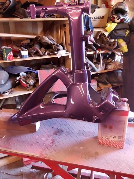

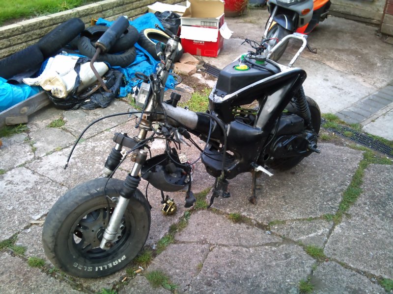

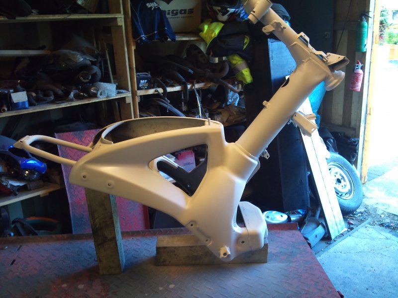

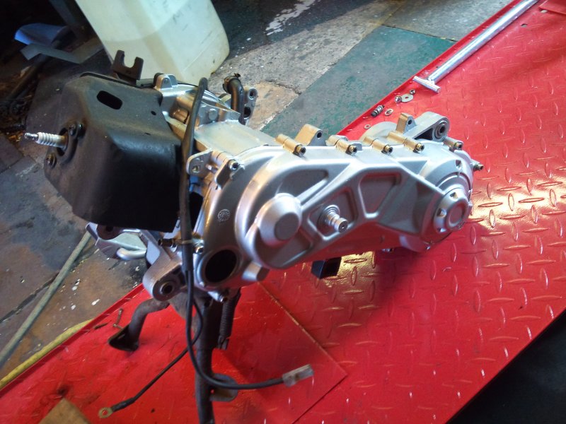

Wasn't going to start a build thread on this, but what the hell. Bought this a few months back along with 3 vx125 engines for £100. Quirky scooters are the Ice. Skeletal frames. I could see the potential of it again. I thought about putting the Runner SP125 LC lump into it, then doing the 172 conversion, but after a little digging around at DVLA have found out that there are only around 200 left registered on the road in this country. So that is the making of a little rarity maybe. So that info has sent me down a different road. Keep it as more or less standard, a bit tuned obviously, for a bit more grunt, I know that it will do around the 55mph mark, de-restricted, with the Hyper2 engine. So let the stripping commence. No good having a nice looking scoot if the heart isn't beating so......... Whipped the engine out, new piston and barrel, new crank bearings and seals, cases shot-blasted and painted, all new gaskets, belt, rollers, oil pump belt, new gearbox bearings as well. Eh voila! Then onto the frame itself. It had been spray can painted very badly so got stripped down to the metal again. Took me a couple of days to get into everywhere but was worth it in the end. Thought I'd go for Suzuki Purple for a change Things have moved on over the weekend; wheels are now stripped ready for priming and painting, came to a bit of a stop, discovered that the fork seals are leaking so they will have to be changed as well. Never mind, good excuse to strip the legs out, and they are. Chroming is good on the legs, no pitting. New wheel bearings will be fitted. New seals sourced and will be here in the next couple of days

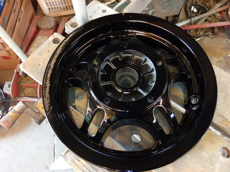

Moved on a little more, wheels and fork legs all painted, as is the bottom yoke. Fork seals arrived, will post pics a little later...............tomorrow maaaaybe..........

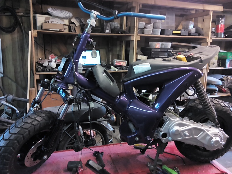

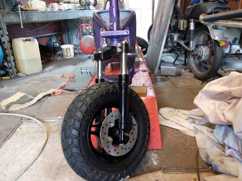

Managed to get a few hours into the garage. Forks re-built with new seals and oil. New wheel bearings and tyres. New disc and bolts. Although the disc bolts will have to be changed as the heads are a smidge too long. Need domed ones. New upper and lower steering bearings. All fitted into the frame. Looks a bit strange at the moment. Back tyre on tomorrow. This photo makes the wheel look like it's got loads of crap in the paint; it hasn't, just dust and bits flying about because the doors are open and there is a lovely breeze coming through
Managed to get a bit more done to it over the last couple of days. Oil tank in, oil pump bled through, engine in, loom in, new ignition front and rear, Renthal bars with the Artek stem adapter, electrics need looking at towards the rear end but nothing major as yet. Debating whether to get the fill in panels for the frame sides or not................ Starting to look ok

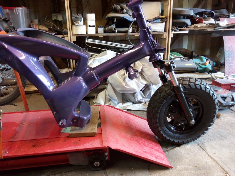

Previous lady owner of a friend of mine, she had it when she was 17. Passed her car test at aged 20, used her dad's car after that. Bike just sat under cover in the garage ever since. She loved the bike and wouldn't sell it for all those years. Despite all the badgering from her parents even after she got married and had her own kids, the bike just stayed there. But, the garage had to be taken down for various reasons, and the bike was put outside under cover and was getting in the way. So my mate eventually told me about it, and because i said i'll restore it and not break it up or scrap it, she said £20 and its yours. She actually cried when I took it away. Looking forward to the day I show her the restored version. She'll probably be in tears again.
