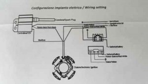

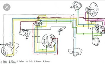

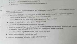

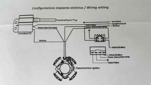

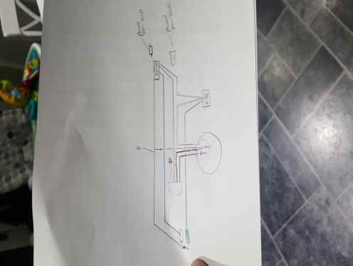

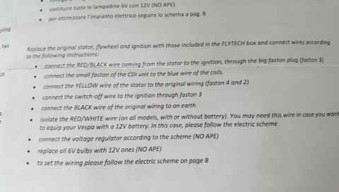

hi all I've got a 50 special with a primavera 125 engine currently in this is my 1st project so hoping for a bit of advice with the ignition kit I'm fitting. the original loom is no good so looking at making my own the original stator had three power cable the new one has one. if I was to take the feed to the brake switch the the light switch everything can be powered from these points I believe? I drew a quick diagram of what I'm thinking and information about the kit I'm putting on any help would be appreciated
MARSH#2
I don't think anyone on this forum will be able to help you with old vespa wiring. If there not wired as per original diagrams, they just don't work ! I always ring Phil at Grand Prix scooters. Leicester for info on vespa's.
