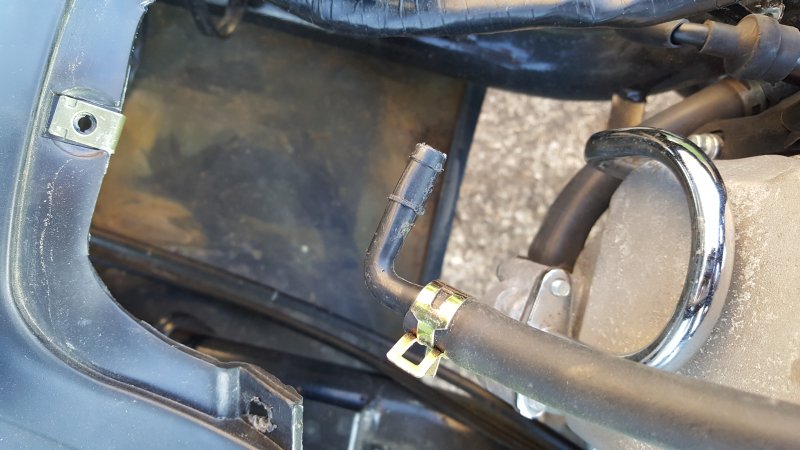

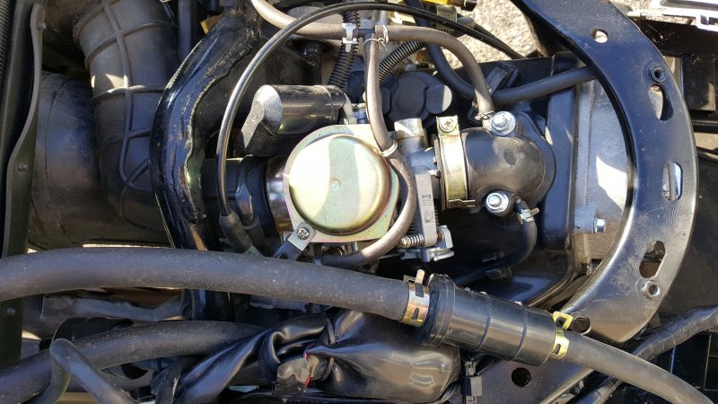

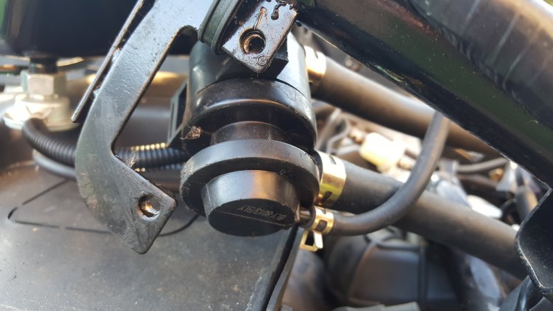

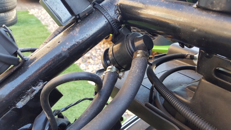

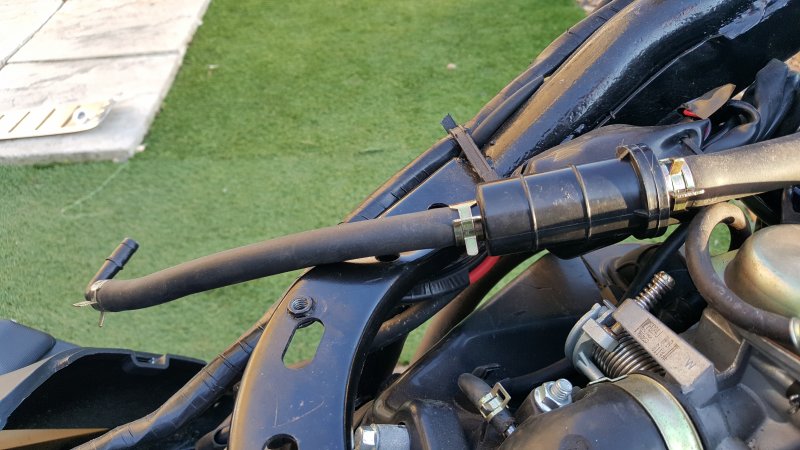

Wife's scooter randomly stopped, now will not start. Check plug all OK, good spark, starter works, but engine does not turn over, fuel just runs out of air box after few seconds. Stripped bike to find out if something has come loose. Found random pipe that looks like supposed to be connected to something, looked couldn'the find where it should be connected to. I have attached pics, any help please.

EGR aka PAIR
thats an emissions unit buddy . the connection you found is the open air feed, look on the airbox see if there is a port hole that plugs into . or an area tucked up around the seat area where it fits to , sometimes they have a filter on like a small box unit that allows air in.

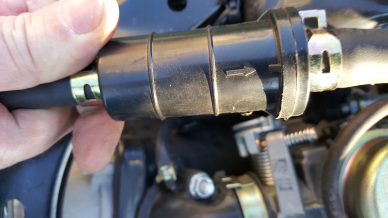

It would help if we knew the make/model but that looks like the fuel filter with the arrow on it so you have lost the supply to the carb.
Have a look around the carb float bowl. Let the tube rest where you found it and look around the carb in that area. There must be another open tube for that to push in to and a clamp if it's still there?

the OP has mentioned when scooter is turned over fuel pours from the airbox. so its not a fuel lline thats already on the carb otherwise there would be no fuel to the airbox via carb. im putting my bets on the pair system and thats the air intake that feeds to the rocker head.
check this video by Vert at the start he shows the pair system and where its hooked up, then shows how to remove it ( this is a gy6 50cc motor but the pair systems are near on exactly the same for the 125cc and 150cc models to )
Well there you go that tube goes to open air according to the video as he pulls it out near the start of the video.
