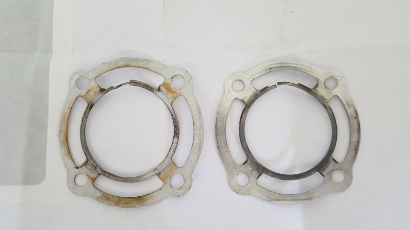

"Breaking"?
Do they have a black or burnt mark around the break?
That's my thoughts - overheat - head warped - causes burn-through on the head gasket.
"Breaking"?
This is what they look like
I had a lucky purchase on ebay won a brand new bigbore kit for 99p got delivered today should I replace the whole lot or just use the head and gasket?
I'd replace the whole lot. That will get the bike running then you can work on the old head. Those pictures show severe burn-through of the gasket by combustion gases so it's definitely warped and needs lapping back to being flat. It can be saved.

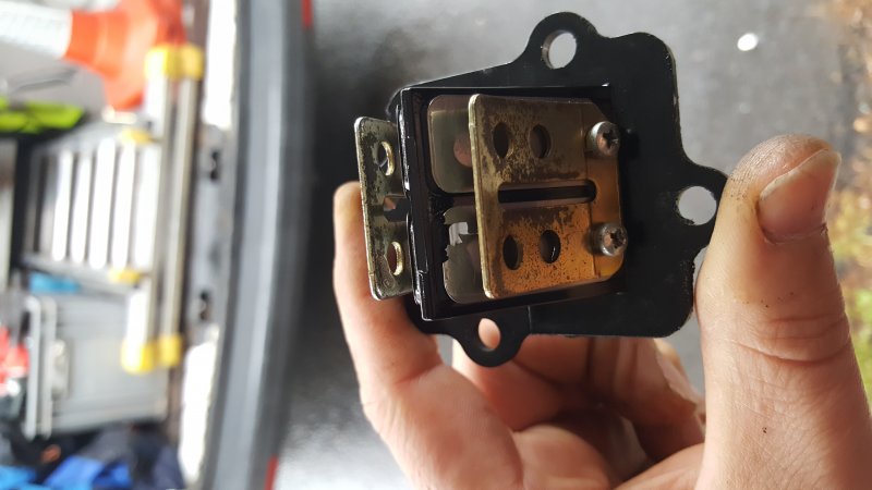

Ok tried moving the needle with no joy so checked the reeds and low and behold they are damaged
