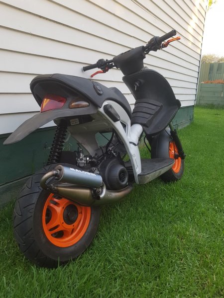

hello, so far I have installed a malossi 70cc kit, multivar, dellorto phgb 21 stage6 filter.
got it all together and have been going for small trips. however took it up a big hill today and it straight up died and won't start now, when it died it smelt hot, how can I tell if I have leaned it out and popped it? and what's next new piston and gasket? cheers all
MARSH#2
What main jet have you got in the carb ? What's the plug colour ?
kiwiscoot#3
main jet is the standard size the new carby came with, 95 I believe, I was told to put in a 140 and it didn't run for shyte, would bog down like crazy, plug was mocha color
