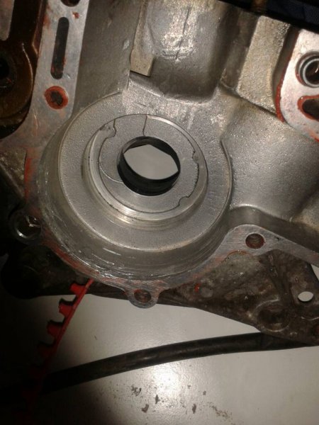

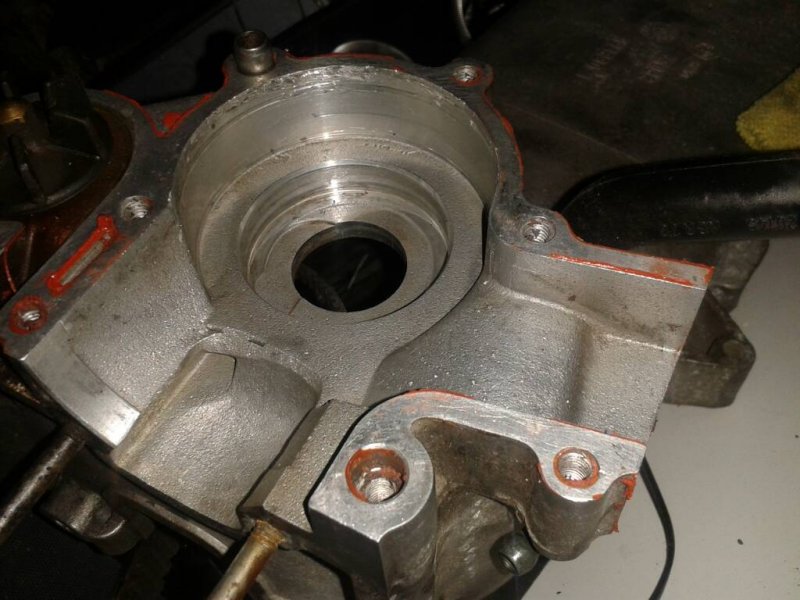

The crank housing are a right state from a poor rebuild
Had tons if metal chunks etc
So im planning on smoothing them out fitting new bearings crank water pump and nice think sealant beed
Will this work ??

What about the rough suface and indents along the bottom would it be ok for me to smooth ?? What tool would be best

So here are some pics after I put a new 70kit on as I was told old one was the problem anyway so I go ahead it ran for few seconds then died did that few times then all of a sudden it wouldn't start then it locked
So I stripped and found tons if metal chuncks etc
So ive ordered a racing crank water pump repair kit lighter rollers heavy duty bearings and gasket sealant
Just need piston and gasket set and starter motor left to order
But im hopin that its not gonna create another problem smoothing rough area ??

Have you rebuilt this twice now on those cases ? From the damages visible, it seems like those marks will create no issues, like MARSH said, the gasket sealant will be fine. I dont see why it would trash again ?
Maybe the crankshafts flywheels could be too big ? Heat expansion and all that, maybe....

So ive skimmed over to top with a dremel witch now gives me a clean surface I also went over quickly with a brass wheel to polish it up a tad
So now what recommend way to rebuild ie put bearings in etc u was good gonna make sure tons of 2t oil ib every thing?
