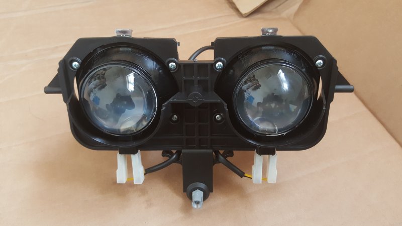

Garren#12
This was the passable set you can see a big difference is the part. Considering they are piaggio parts they should of just sold these.

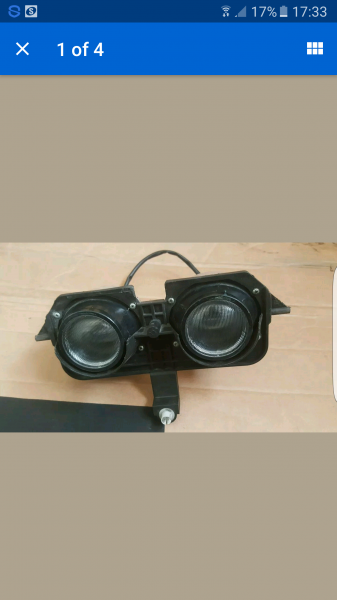

Garren#13
Second photo was the impassable set.So the old set is up for sale :)
