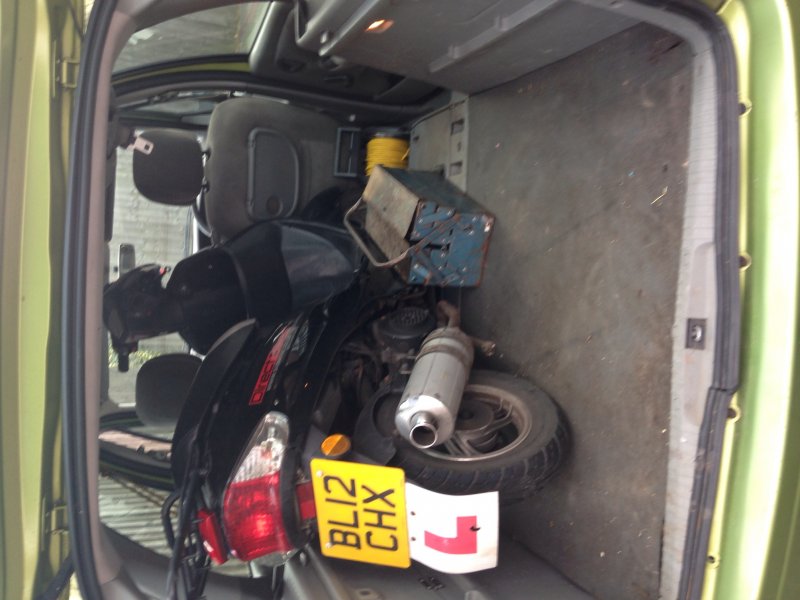

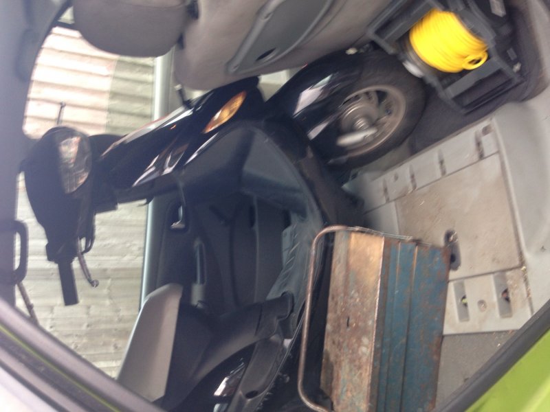

Adam kelly#1
I brought a direct bikes scooter for £90 crank shaft snapped got it for a bargin with tax and mot fitted it in a renault megane scenic 2002 1.4

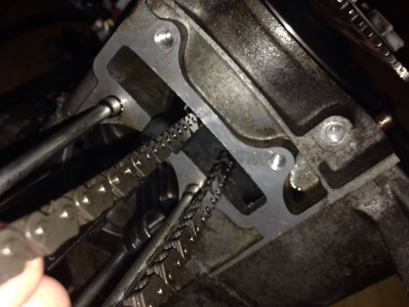

Ah well just to get me started off I'm only 14 ;p and yeah cost me £40 but I've put new crank in but can't get chain on the sproket thing were the oil chain guides go
Mark farmer#5
Oil chain? Is this four stroke or two stroke?
Adam kelly#6
Four stroke it's oil cooled
Stevep#7
Patience grasshopper, patience
Mark farmer#8
Have you put the new crank in? Is the timing all set up correctly? Oil pump drive chain?
Adam kelly#9
Yeah the chain that goes on the crank that goes thought the head and turns the cam shaft
Stevep#10
Thats the timing chain. You need to slacken the chain tensioner, put chain over cam sprocket, put sprocket onto cam shaft in correct position, tighten bolts, then adjust tensioner.

Adam kelly#16
There's a sproket in there I can't put the chain on
Mark farmer#17
I believe that's just a guider sprocket?... Does the sprocket pull out?
Adam kelly#18
Nope the sprockets on the crank shaft and it's all the way down there I need to get the chain on it, I know about the guilders that's no problem
Mark farmer#19
Should this not have been done when the casing was off?
Adam kelly#20
Nah on youtube they put it on when all the bottom ends together I can't get to it even when the case is of
