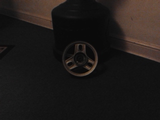

Got a 'ped that's up for mot -» apr./14 + selling on for july/14 -
an thought i'd have the wheels off an give them a nicer paint job(think they've been brush painted!),
More than likely be via spray-can an just a nice clean simple colour
but would like advice esp.on preparation/preservation.mk

Mark Emerson Trentham#6
You guys are killing my budget,
Think i'll go the old fashioned paper,prayer,sweat,route -
nice shiny clean like new?,good base coat,spray black or silver
keeping it simple but clean/tidy. :) .
