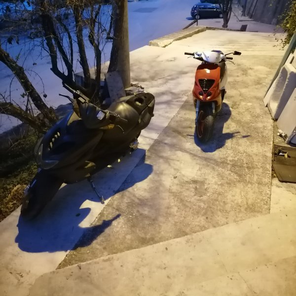

Hello i have piaggio nrg mc3 2003 LC. I have problem with acceleration. Yesterday i bought malossi multivar and polini kevlar belt. I put malossi multivar with My 4.7 malossi rolers from original variator and i put polini kevlar belt. Acceleration was very poor. On hill he couldnt drive. On straight road he have bad acceleration too, but after about 5 seconds he finaly accelerates how he need to and goes really fast. Ps My clutch system is all original, i tried White malossi spring but its even worse so i put original spring back. So i want to know are malossi 4,7g rolers problem or polini kevlar belt is problem or maybe the problem is clutch. Thank you!
