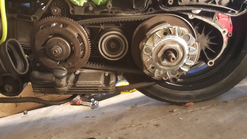

    Basically i got a 180 reg 125, been told by a mechanic hes certain its a 180 head but it makes some wierd noises when accelerating and it seems a bit too vicious. Could it be the bike 180 gears? Is there anyway to check as ive never taken the gearbox out on one of these, isit easy?
    Attatched is a pic of the bike and inside my transmission case is anyone can see a problem there?

    The belt looks a bit slack/worn?
    While the belt is off check the rollers in the variator.
    If you do not have the knowledge or equipment to do this I would suggest you find someone who does.
    It's a fairly simple procedure but you'll need an impact driver electric or air.

    Cheers for the advice, yeah im not too bad with mechanics im a paint tech by trade so i know bits and bobs. I installed a new variator and clutch not too long ago but did think the belt looked long, is there a difference between the 125 and 180 belts? Yeah im thinking of finding a mechanic to change the gears for me

    Leave the gears until you have changed the belt and rollers.(if needed)
    Chances are the rollers are worn and combined with the worn belt are causing it to "snatch" if that is what you mean by vicious.
    Belt should be the same.
    Yeah I noted on the pic that the clutch(rear pulley) seems to be in good condition.
    What weight rollers did you put in. If you bought standard ones or a standard variator that's fine especially as the engine is a bit of a puzzle.
    Always best to start from the beginning if anyone has been fiddling with it and you don't know the history.
    The belt is as important as the variator/clutch. Chances are it's not engaging until the revs are causing the variator to grip when they are quite high.
