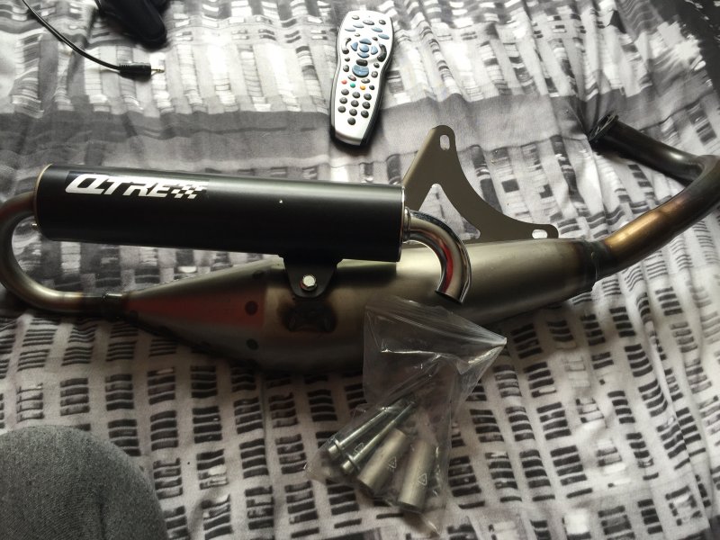

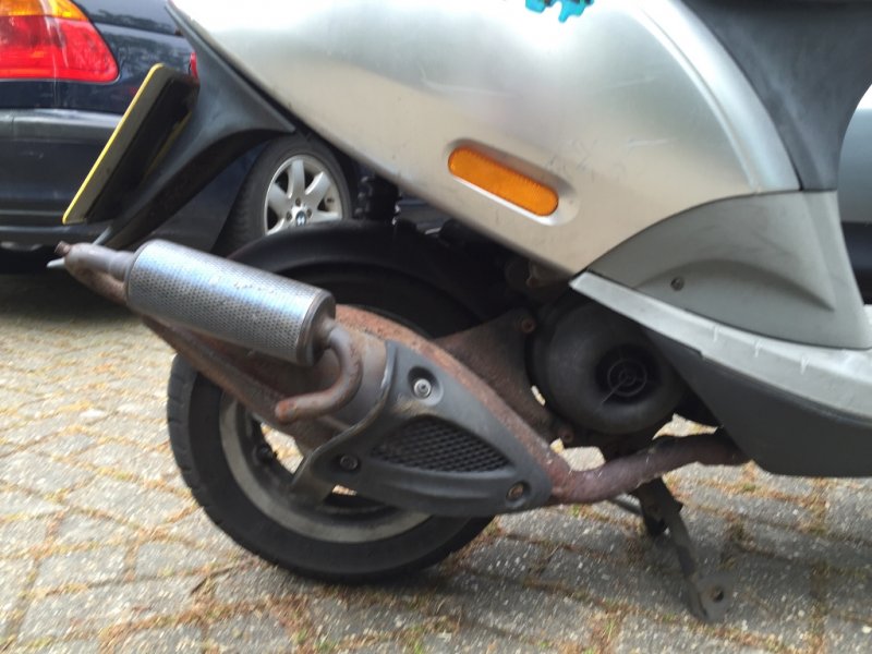

So, my current exhaust is on it's way out (parts of it are more gun gum than metal) so I'm looking to replace it It's not a standard exhaust, but I've no idea what it is, as it was on it when I got the bike 3 years ago. I was looking at a Technigas Q-Tre exhaust, and now it's on offer it's a good buy. They recommend I change the rollers to 5grm ones, a 6mm jet and uprate the clutch springs. Is this exhaust restricted? I presume my current one isn't, due to getting an indicated 40+mph on the speedo, although being Italian I'm sure it exaggerates wildly! Also, to have it all fitted, anyone any ideas at how much I'd be looking at? The exhaust I could do but the rest I'm not confident in doing. Cheers!
If you buy the Q-Tre don't get the chromed one. It rusts really quickly. Get the self colour one and use high temp paint. Also change the nuts on the silencer for locking ones and use stud lock as well, they will come loose. I fit loads of them. Took one back on monday because it blew a massive hole through the back near the support mounts, and that was fitted on November 27th last year. The Technigas Silent Pro might be a better option for you, I think it has a restrictor in the mouth with a couple of welds that can be easily ground out with a dremmel. Put one on a runner not long back, quiet enough and still all the power.
As I said, already ordered the Q-Tre and other bits, otherwise I might have gone with the Silent Pro, as I was considering it for a more hassle free option, but they Q-tre went on offer at Pedstop

Ah right, thanks for that. A guy from Pedparts said it was a standard exhaust but looked nothing like the standard ones I've seen, so that makes sense.
