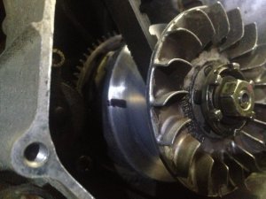

Evening! I have recently purchased a 2001 yamaha neos and had a stage 6 pro exhuast on it and a TNT covered airfilter. I got the scoot cheap due to it not running correctly. ATM it has 4.25g rollers and size 95 jet. Just wondering if this sounds about right to you? Cheers
Try it but you might need to try some lower jets as its a covered air filter but your better off with the standard air box, open air filters just cost more in fuel and don't make a difference in speed with a 50cc
The long term plan is a stage 6 70cc kit. ATM the bike runs ok but if you go along an turn the choke on it accelerates away which leads me to think its running lean ATM. I tried 100 size jet but it didn't seem to like it. I'm puzzled!
That's a deal for £50! It shouldn't be running lean if its got a 95 jet, maybe try the air mixture screw

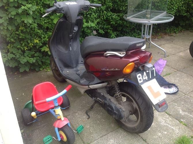

Ye the plate is worth £150 over here alone. It's looking abit better than it did! Ill try that then cheers

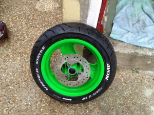

Sort of.... From guernsey in the Channel Islands. No letters and black/silver plates are road legal on any age car/bike My front wheel with new tyre My variator at max travel with the current rollers
