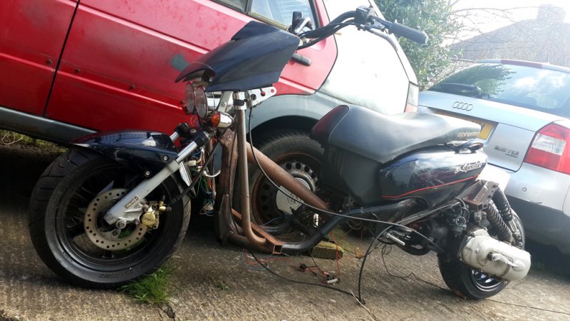

    i think the tubing is 30x30mm and about 2-2.5mm wall thickness. There's some smaller (15mm) square verticals to join it to the frame up by the old suspension mount to keep things rigid too.
    yes about that
  2. BunnyMum

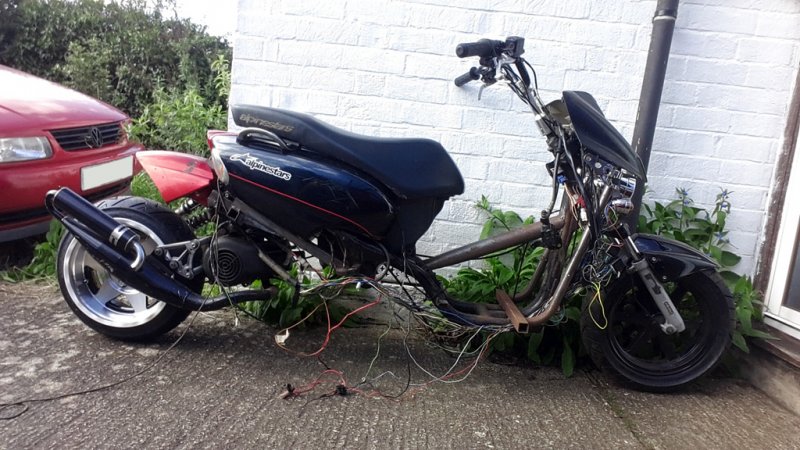

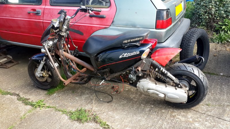

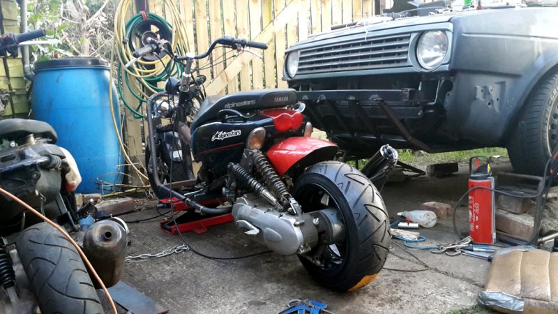

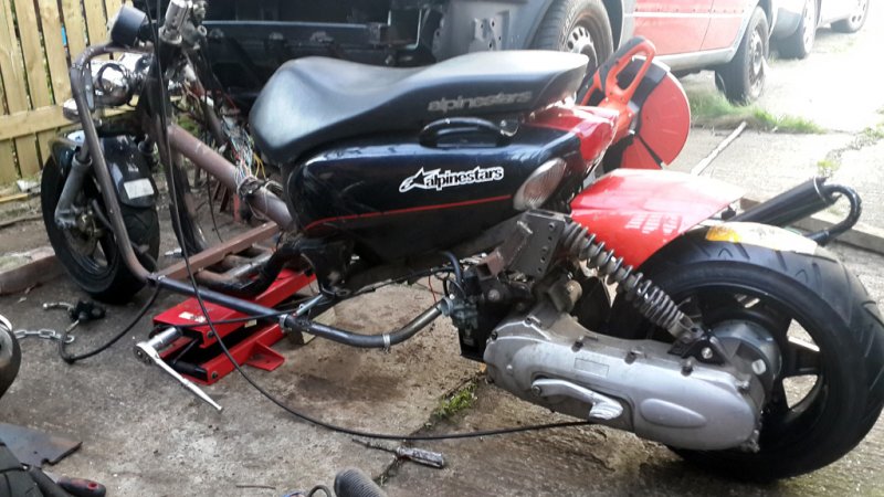

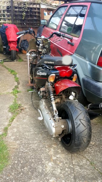

    Few pics from recent progress...
    Been working on trying to get it as "together" as possible, all trim, bodywork and stuff, before putting the floor bars on to get the best idea of how to do them. I think know what I'm supposed to be doing and now just have to actually get them in. Hopefully I'l get into that this week, weather permitting.
    The back rides up when there's no weight on it which makes it look a little odd, but when you're on it, it all lays flat and lines up right. Last pic is with me on it and both the rear mudguard and the exhaust come into alignment. It's very, very long for a scooter but looks to be headed the sort of direction I was hoping.

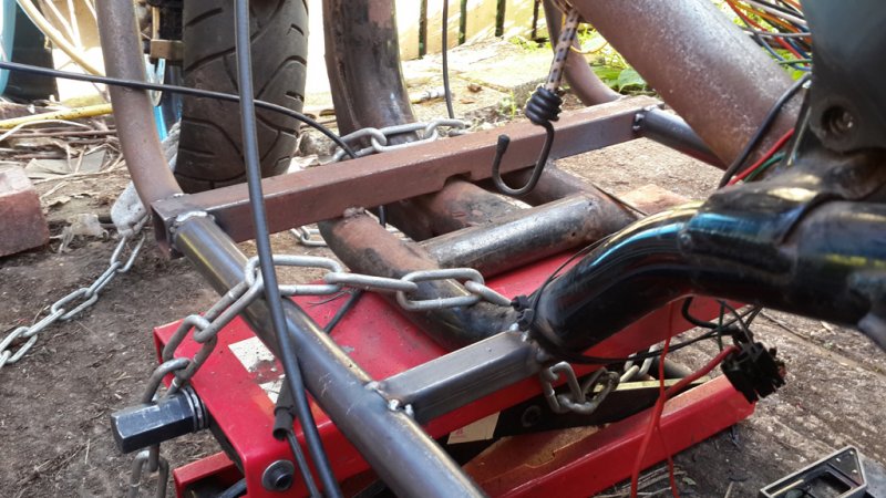

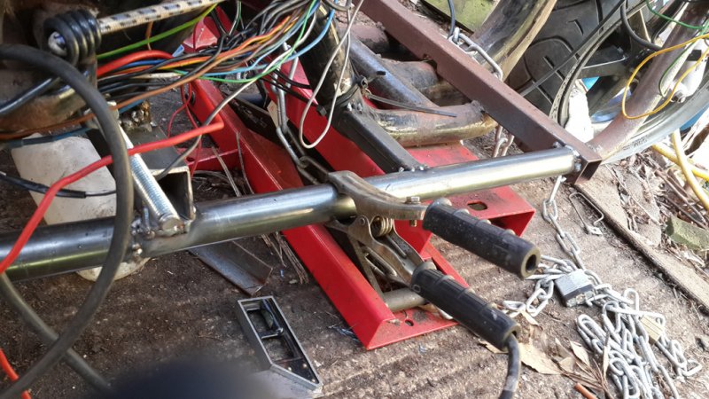

    frame bars - *finally* \o/
    The rear mounting isn't pretty but it'll hold them in place till i figure out a neater solution. In these pics I've taken one of the rear shocks off so it sits level as it would with rider on rather than riding up like it did in the previous pics.
    i now cannot move.
    I'd also quite like to get some of this going on (the green lightning bit) particularly on the back. I might have figured out a way to achieve something along these lines without adding any rotating weight at the outside of the rim like the tyre-valve ones you can get on ebay do.
    possibly something with green leds projecting outwards reflecting off the dish of the rim, activated by motion switch etc. I need to test but I think it's doable. the idea would be that it only activates momentarily when you gun it (like in the film) so batteries should last a reasonably long time.

  6. BunnyMum
    got the first couple of cross-structs cut and tacked in place. These should form the support for the checkerplate foot-plate. They're only little bars but for some reason took a long time to shape so that they fitted properly.
    There's currently a box-section beam which is supporting the back of the frame bars which is going to be replaced with something a bit more elegant, or at least tidied up, but I haven't decided on how yet.

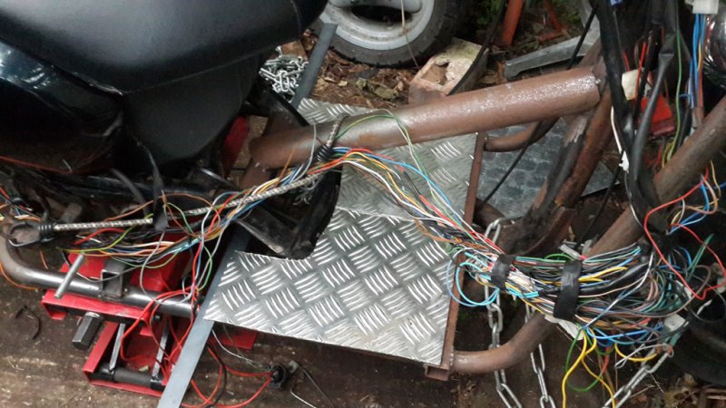

  9. BunnyMum
    so - little bits of progress... I've acquired some checkerplate tiles from a friend's bathroom floor (with his permission) and started seeing if/how it might go together. I'd like to extend it futher back and further forward (up the curve of the bars to stop spray etc) but these are the key bits.
    It'll need some extra support bits adding and I haven't had the spoons to do that yet but it's next on the list.
    Also - I fixed the front brake so was able to take it for a little test run up and down the drive. Obviously cables and crap hanging out everywhere but it moved under its own steam for the first time since the stretch, which is significant progress.
    The steering felt a bit weird, like if you got off centre it would tend to pull to that side. It seems like a rake/trail thing based on the adjusted geometry so I might have to flip the fork legs around and see if that helps. Wasn't a complete surprise...

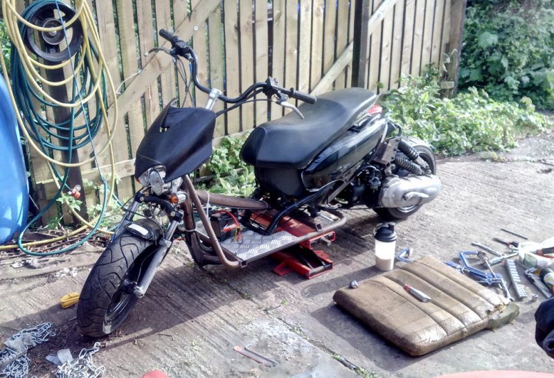

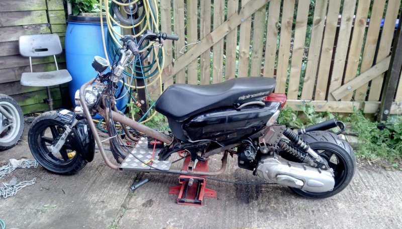

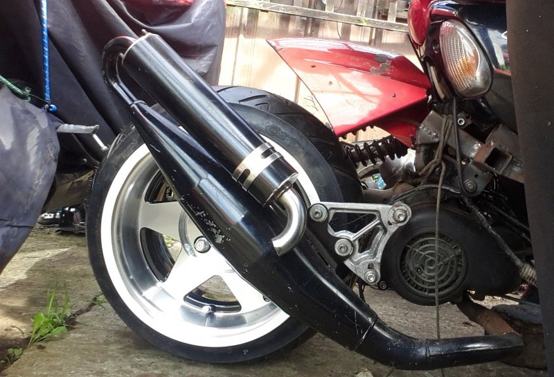

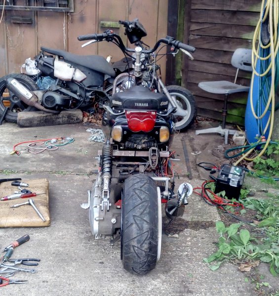

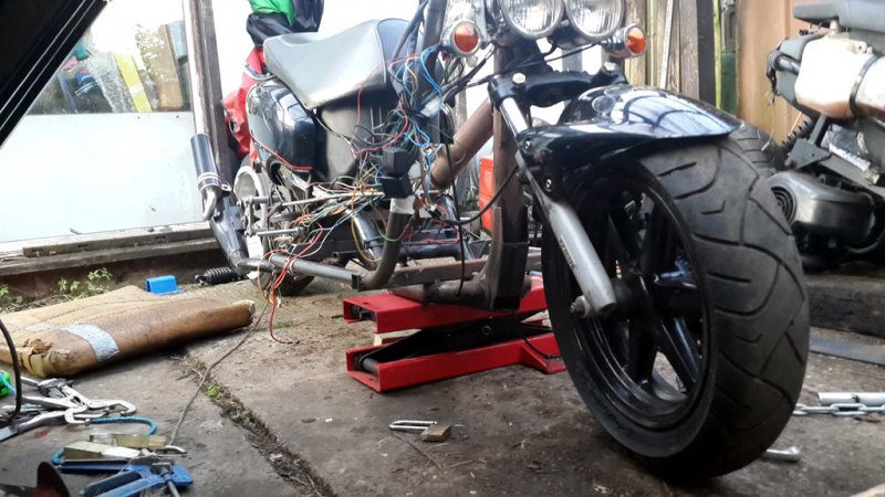

    first time I've been able to work on the scoot for a while, was just trying to see sorta where I got up to and check it still runs etc, which it does \o/. Remembered to drain the carb this time and she fired right up.
    This is how she's looking - sorry for the terrible pic. New phone, camera sucks.
    I feel like the lines of it are actually coming together nicely this time. Tapering the vertical bars inwards made all the difference so was worth the hassle i think.
    It does still look a bit odd when parked since there's no weight on the back and it pops up a bit, but when you're sat on it all the lines are as they should be...like a long, low land-sled or something :)
    I've just done new brake levers on my yamaha daily bike and I think they might fit on these mounts which would be nice since this is a bit of an odd set. I'm sure the brake lever is shorter than it should be.
    Oh I rode it too! After the first test where the steering felt weird I guess I flipped the forks round at some point but never tested it out. Today I ziptied all the cables and the battery etc down and gave it a little blast up the drive a few times just to get an idea of how it moves. I've not taken it for a whizz up the road yet but I don't think we're far off being able to do so.
    It's surprisingly keen to go, which I like. and it does burnouts lol, so, good start :) The steering feels way better now too so I can stop worrying about that.
