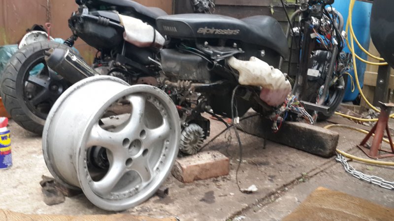

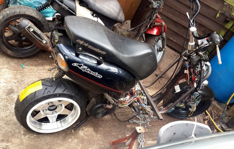

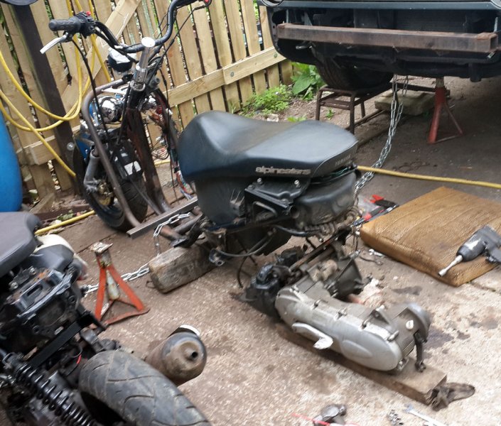

    been dancing around this for long enough and finally got some scooter time today, so got stuck in...
    as it was..

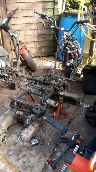

    back end off, trying to figure out the positioning of things..
    I couldn't get my head around it initially. There seemed to be space to fit everything neatly but somehow I just couldn't "see" it in my head. Until I propped a wheel up in place and then it all clicked.

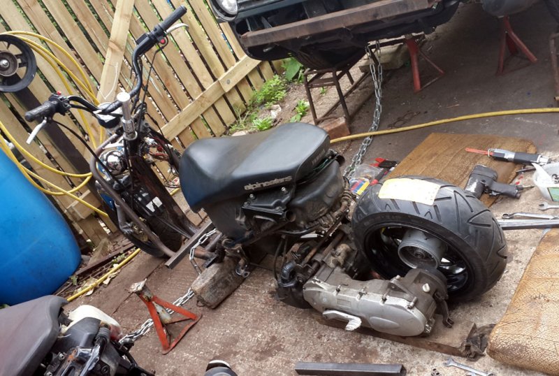

    Yessss! Now *that* is more what I'm aiming for.. (but obviously stuck together)
    This time around I'm trying to get it quite a bit lower than when I stretched the jog, and also trying to get the back wheel fully behind the bike like the japanese "big scooter" style modified scoots (which I like a LOT) so it'll be a slightly longer stretch than the jog. Dropping it that low makes the whole frame noticably more "leaned back" and means the bars sit/suit better (imho).

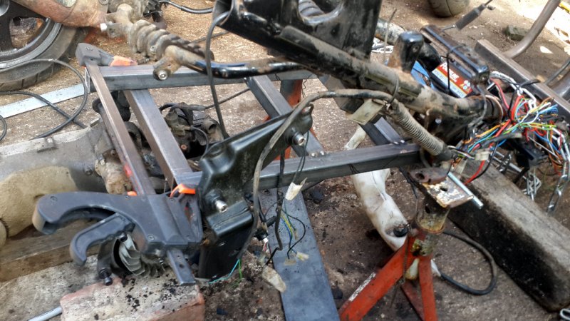

    I've not done the maths yet re rake & trail, but if having it so low ends up with the steering not feeling right then I'm thinking possibly do what I've seen on one of the other stretched yamahas (pic below) where they look to have flipped the fork legs round which moves the axle in front of the fork leg and should reign in the trail a bit if it's too much. Tbh I'm not really aiming for super-maneuverability, I'd rather it's stable at high-speed so it might not be an issue.
    Annoyingly the motor and box on this scoot are overall not in quite as good shape as the jog, but I *know* they run so am reluctant to use the bits off the other bike. Also the main engine mount bolt isn't separating from the tube it sits in so I'm going to have to stretch using the "pre" mounts.
    It should actually work out slightly better since it'll mean the stretch frame shouldn't foul the carb etc like it did on the Jog (which then needed the carb relocating) but it means the stretch-frame will be a bit more complex which is annoying since complexity adds scope for it not ending up square/aligned right. So it's a bit of a mixed blessing in all but I'd still obviously rather it all came apart nicely. The kickstand bolt was also totally seized (did you ever get yours loose Tamiya?). Again, not really a problem as I wasn't planning on using a stand anyhow but still annoying hiccup. I suppose it means I have something I can weld little feet to so that it rests nice & stable when aired-down.

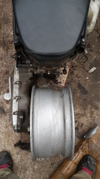

    While it was in bits just out of curiosity (and given the amount of offset using the mini-classic rim) I tested out how it might sit with a 15"x7 golf rim and actually it fit a lot better than I thought it would. Realistically the 15" is a bit tight but perhaps a 14"x7 might be workable, and the offset seems a bit better than with the mini rim. Noted for future reference ;)

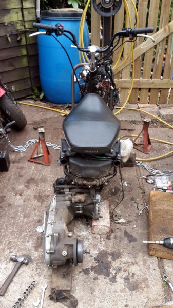

  20. BunnyMum
    BunnyMum BunnyMum (aka Northcust)
    202
    YZF-R125 (180cc)

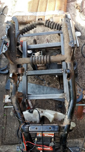

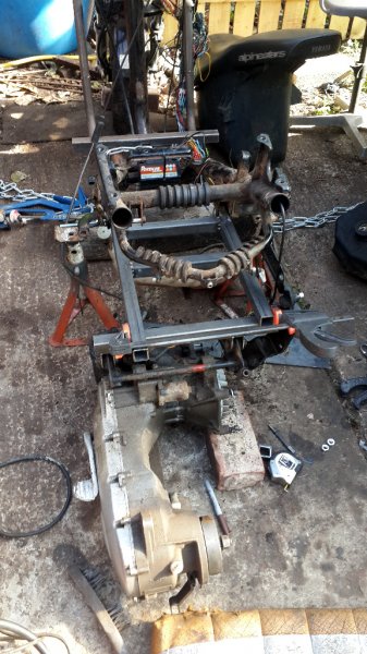

    had a super productive day yesterday - the stretch frame on this one has been a bit of a head-scratcher but it's finally taken shape. It's not like there's anything amazingly different/more complex than the one for the jog, but it's been lots of little annoying things...like the main logitudinal struts of the frame have to slim down at the ends so they fit into the mounts on the frame, where when using the other mounting bolt it didn't matter...
    Also with having the engine offset slightly there's been more issues with carbs, throttle cables etc potentially getting fouled by bits of metal.
    *However*, I have worked through it, the basic frame is built. It's currently in two parts - the bit which does the stretch and the bit which holds the engine (and will attach to the stretch bit).
    Once I have finally decided on what hub/adapter arrangement I'm using and hence what offset I'll need I'll sticko-extra the two halves together in such a way that the wheels line up properly, then reinforce the join with gussets and such.
    Although this approach has been quite a bit more complex from a fabrication/details point of view, I do actually think it's a better solution than the stretch frame I did for the jog. Somehow it just fits more snugly with the lines of the frame and even though it's a longer stretch (~18" vs 12" on the jog) it just seems to fit nicer overall and somehow be less obviously a stretch frame.
    Somehow it all just lined up nicely too - there's no big gaps between the seat bucket/potty and the engine - I always think that looks a bit naff on the super-stretched ruckus scooters when there's yards of empty space under the seat for no apparent reason so I'm pleased that's not the case here.
    Also due to using the other mounting points for the stretch frame the longitudinal beams are a bit wider apart so I don't have to relocate the carb on this one...and it all sorta just *fits*. Also because of using these mount points the longitudinal beans go either side of the potty rather than under it so I think it's gonna end up being able to go quite a bit lower than I had expected which makes me very happy (I want it low as possible :cool: ).
    That being said - at the moment it just looks like some big metal monster has eaten most of my bike.... :eek:

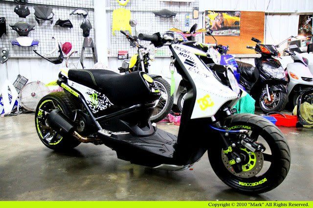

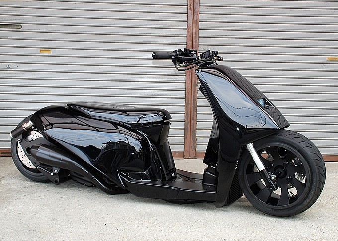

    In terms of general lowness/stance I'm aiming for somethign along these lines...though a bit more stripped down in terms of body panels etc
