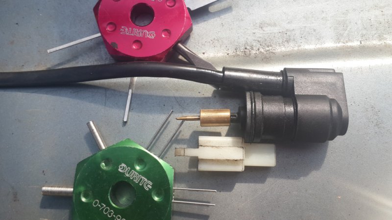

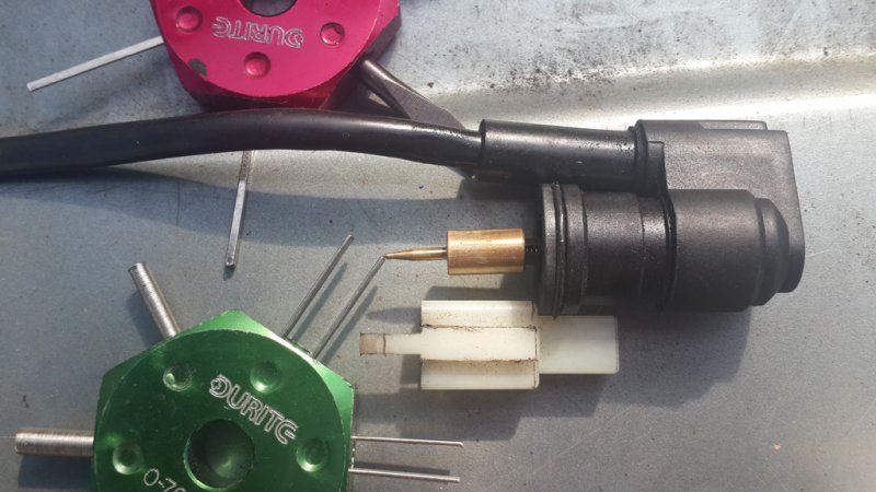

Just unplug the choke and remove it then put 12v across both terminals and it should extend out after a couple of mins. http://www.pedparts.co.uk/blog/automatic-choke-unit-50cc-mopeds
thanks, yep someone posted how to test it earlier in teh thread, I just hadn't got around to actually doing it yet with my other projects...ditto the easy start. cheers
Ah yes didn't see that. It's just that a lot of people don't realise it only works with the engine running.
no worries, thanks for trying to help At this point it's down to lack of user action than lack of helpful input . Just knowing that it runs though and I don't have to rebuild the engine has encouraged me to pursue it though so testing the auto choke will be up next.
tested the auto-choke today and it looks like it's doing something - only seems to move about 5mm but it's a start...
yeah it dont move much but that 5mm is the choke closed off , its working like a boss buddy . i would look at the chokes port give it a blow through, check the float valve is opening and closing , leave the float bowl drain screw loose pop the fuel hose back onto carb and just gravity feed the carb with some fuel if it goes in the top and out the bottom the floats opening the valve and allowing fuel to flow in. hook it up to scoot then give it a few blasts, then chop plug out see if its getting wet . if its bone dry theres a leak somewhere between carb and manifold inlet on motor, the leak means your not getting enough vacuum draw to suck fuel from carb into motor

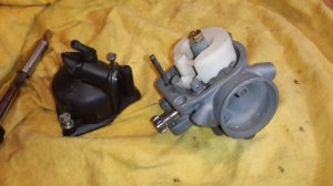

so I got an ultrasonic cleaner and after an hour or so in that the carb came out looking virtually like new \o/ before: after: I got the bike started on easy start as before, but kept the revs up and it stayed running. Now the bike starts without easy start, albeit grudgingly, but only seems to like running at high rpm, and produces quite a lot of blue smoke. Gonna play with the jetting etc but the quantity of blue smoke makes me wonder whether piston rings are shot...thoughts? Also having had the neos in bits I don't think this one has a 70cc kit after all - the cylinder on the neos looks identical (also iron/rusty)..which is actually good since it means I might be able to ride the jog in the mean time once I get it registered and running nice (and add some working brakes etc). Progress update: seems bigger jets made it worse and 64 is the smallest I have currently...ordered a new set of 50-74 jets so will see how I get on with them. further update: also ordered a cylinder kit (piston, rings etc) just in case. Chances are she could do with a fresh set.
