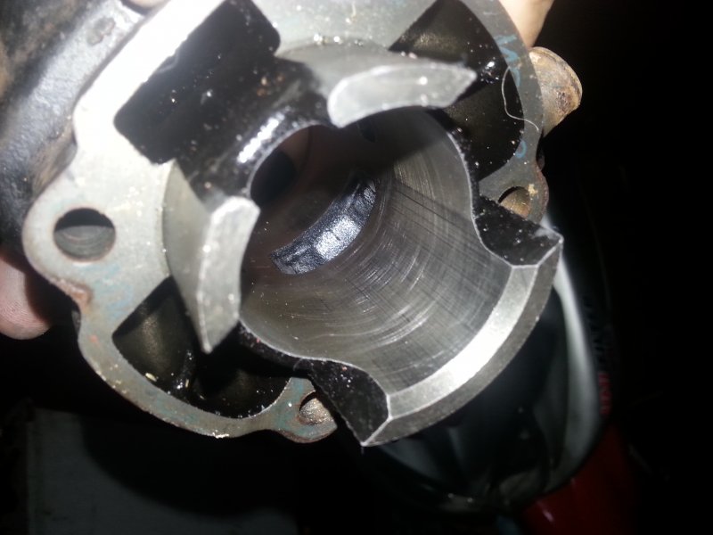

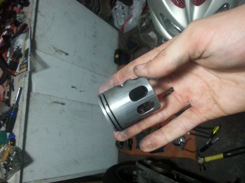

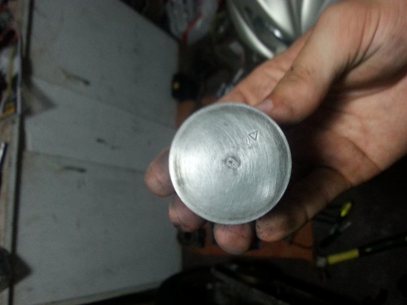

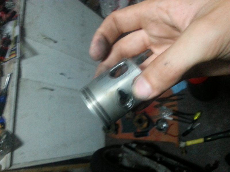

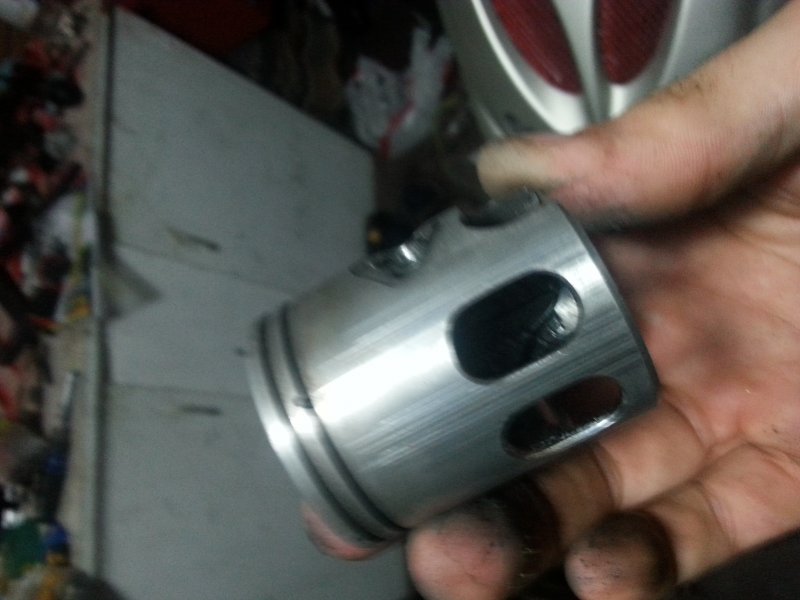

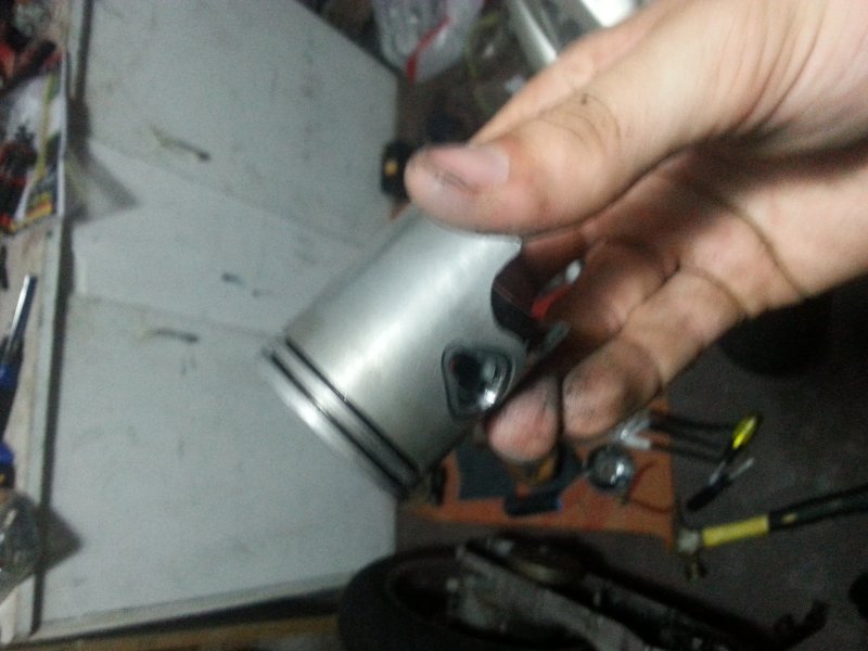

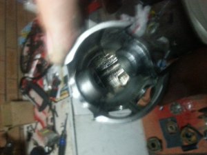

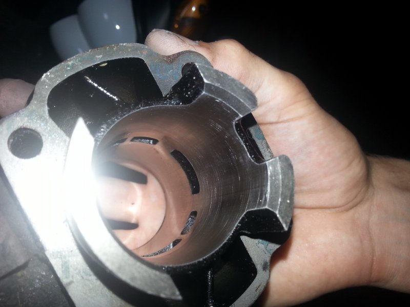

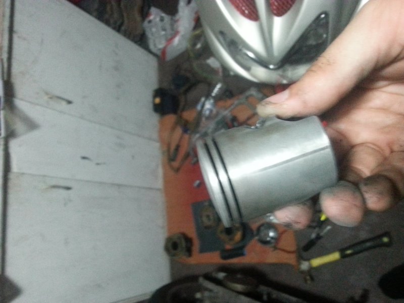

Heres the pics Would this 3 in 1 tools work just fine for the transmission? https://www.scooter-attack.com/shop/#!/en/Yamaha/Aerox-50-as-from-1999/Tools/Clutch-Holding-Tools-und-Compressors/ODF14569MIN-Universal-Locking-Tool-ODF-3-in-1.html Have just had a look at cylinder honing and its pretty intersting, ill just leave the cylinder and piston as it is now, im more than happy what the $2.15 worth of sandpaper has done For the piston clips i am just going to order everything online when i order a clutch and gearbox oil top performances cover, They are G shaped so not double curls just one curl is that still fine and easy to put in compared to just the normal straight ones?
Cylinder looks great. Piston could do with a bit more - attack it at 90° to the visible scratches. For the clips - yes. Still easier than those 'orrible stock ones. Grip the tight curl, put the 'tail' into the groove and twist/compress/turn it in there. Again - order 4 - that will give you some leeway for learning.
