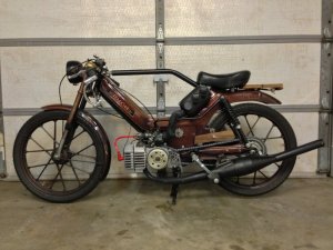

    Can someone help me out? I am putting this TNT airbox on my moped. Currently running a malossi filter, and will need to downjet and tune the carb again... Question is how far down do you think I'll need to go with the jetting to run this airbox?
    This is what I have with the malossi filter...
    21mm Dellorto carb
    96 main
    40 idle
    50 slide

    4
    Didn't mean to post the pic 4 times. Haha.
