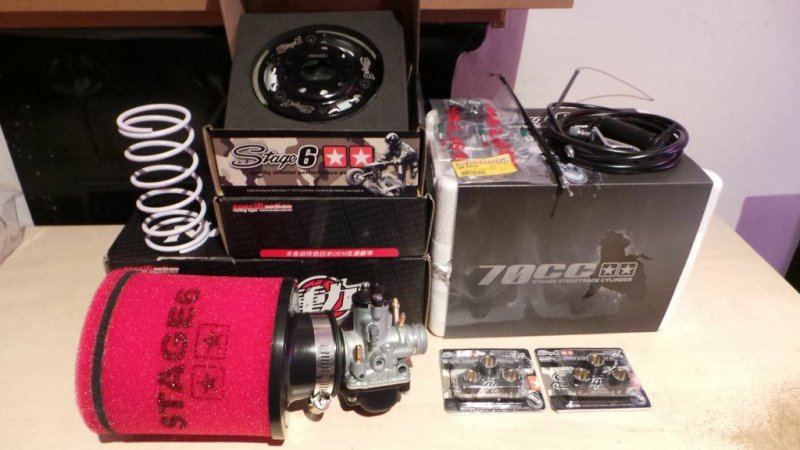

i have a sym jet sport x sr 50 (2012), which i bought from new a year and a half a go, i have recently purchased these parts: -Polini variator, -Leo vince zx-r, -Stage 6 street race 70cc, -Top racing crankshaft, - -Stage 6 clutch, -Malossi 19mm carb, -Stage 6 big filter, -1500rpm torque spring, -Motoforce clutch bell, -Stage 6 roller weights(4.75), -Malossi bearings and oil seals, -Malossi primary gear up kit,,, -All purchased and sitting here, just waiting for my local mechanic to give me a date for it to be fitted, -Total cost came to around £650, plus £200-£250 for fitting. and i am wondering what speed i should expect?!? thanks....

50ish. DOnt fut the torque spring, on a sports set up you tend to go softer not harder. Just use the stock one
Where did you get the crank from because there not the best. And for the same price you can get a motorforce that again is not the best but are bettet

he has had to make things to it fit? bolt on parts? i would keep a close eye on the bill. you have got nothing that should need custom work. 1hr to fit the lot by me so a garage with all the right tools and know how should have no problem. its the setting up that takes time.
hes had to make a fitting for the carb, hes made my mud guard longer so water doesnt get into the air filter, and 2 bolts on the cylinder didnt line up correctly so he designed 2 high tensile studs, also after all of this hes now having to make the exhaust fit.

there is only 6 bolts on the cylinder. 4 that fix it to the engine cases and 2 that hold the exhaust on, NONE should need modifying in any way. also if you got the right exhaust for the bike it should also need NO modifying. if you know anyone that as a clue about this sort of a thing i would take then to pick up the bike with you. at around £40 per hr(if he cheap), saying they had to make a few things is an easy way to charge you extra £120+ i hate garages i know a lad why paid £500 for a new kit+fitting, it was a stock 50cc runner cylinder. they see who dose not know anything and milk them.
i think i see the problem with the exhaust, and they may be right. -Leo vince zx-r, - as a flanged fitting to the cylinder. -Stage 6 street race 70cc - has a flat deck, the flanged fitting would pull the exhaust back about 10mm making it a pain to fit. i made the same mistake with an ZX-r and a athena HP
