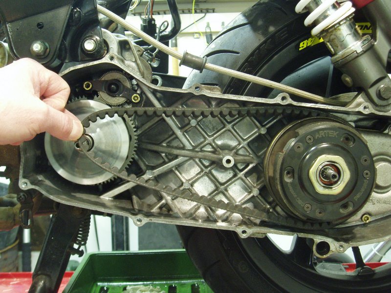

pull the clutch together to let the belt drop further down the clutch, gives you alot more slack in the belt. It will seem loose but once the engine runs it will push the belt back.

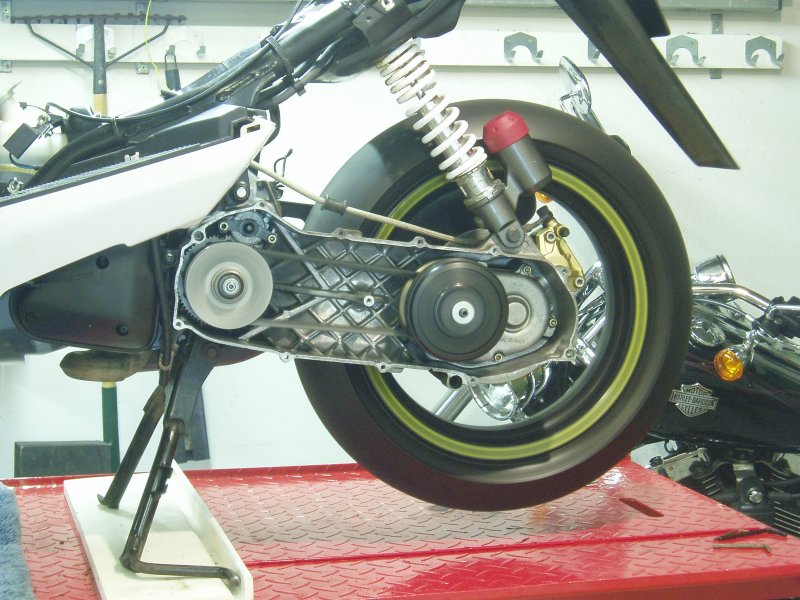

Thank you, it must be a strong spring because it was difficult to open the pulleys, it was so hard I thought I was doing something wrong, I got it back together now, the spring is a blue one, are they color coded for strength? the bike is starting to go back together now, I took the carb off , the air box, two stroke oil tank, exhaust pipe, running board, and all of the other peripheral bits and pieces, the battery well was full of road grit grime and sticky oil as was everything else, perhaps I should have taken a few more pictures, but I'm sure you've seen it all before

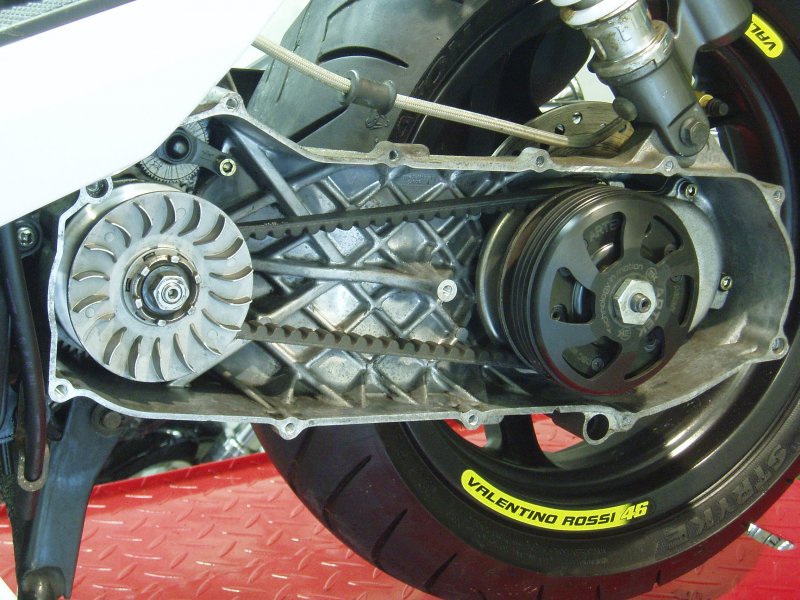

You need to find out what make the spring is as they are mainly different colours from different brands, find that out and google it that will help. And your clutch looks different to mine do you know if its standard or aftermarket?
I’m not sure, it’s the first Aerox I have had, I’m told that it has a racing clutch and vaireator, not sure what that means either

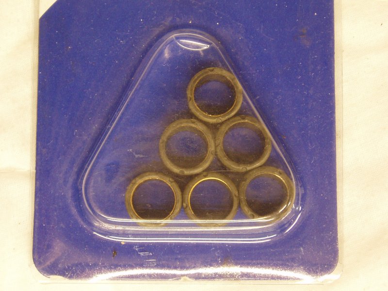

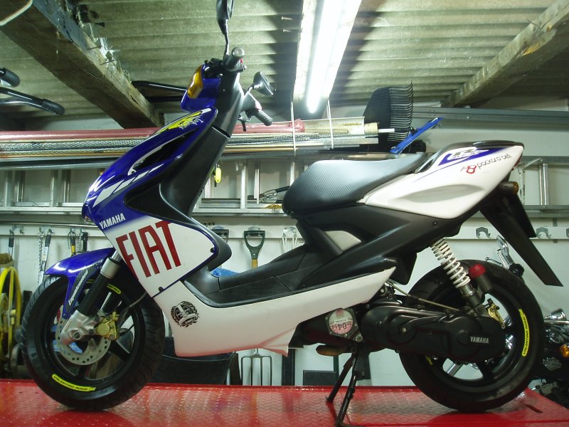

here she is, running ok, and back together with new rollers, the old ones are in the picture below, I will take her for a test run in the morning and see if she is any better, then I can look forward to a proper upgrade with my base line to start with, thank you for your help Guy's
