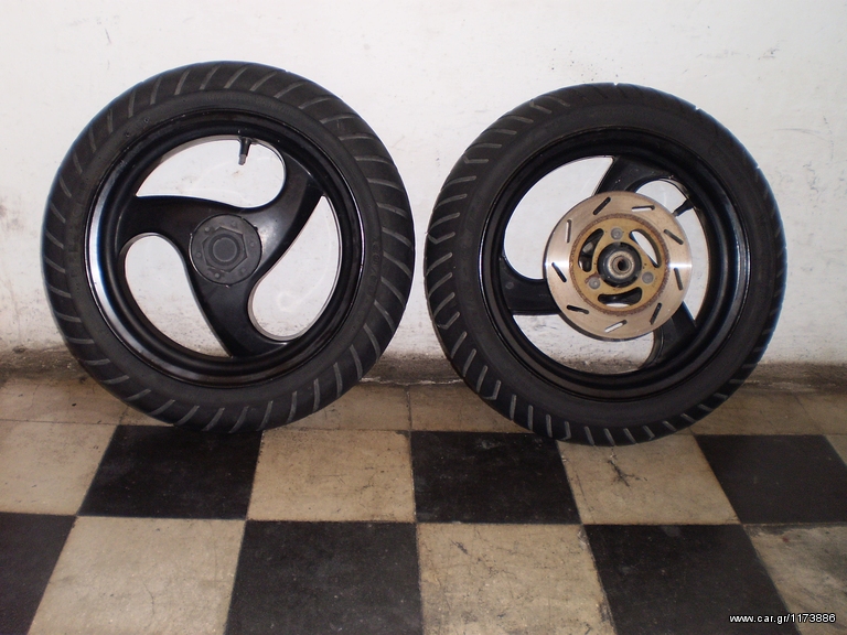

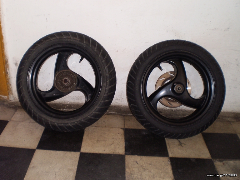

    pamarakos Member
    35
    So this is my case, right??
    You haven't uploaded any photos of the other side of the grey one that's why I'm asking:)
    Disk is the same as mine so maybe I don't even need it??
    Also if I put a bigger aftermarket disk like yours on the grey one, I'm going to need a spacer too, right??
    Grey tph is with 130/60-13?
    Thanks!

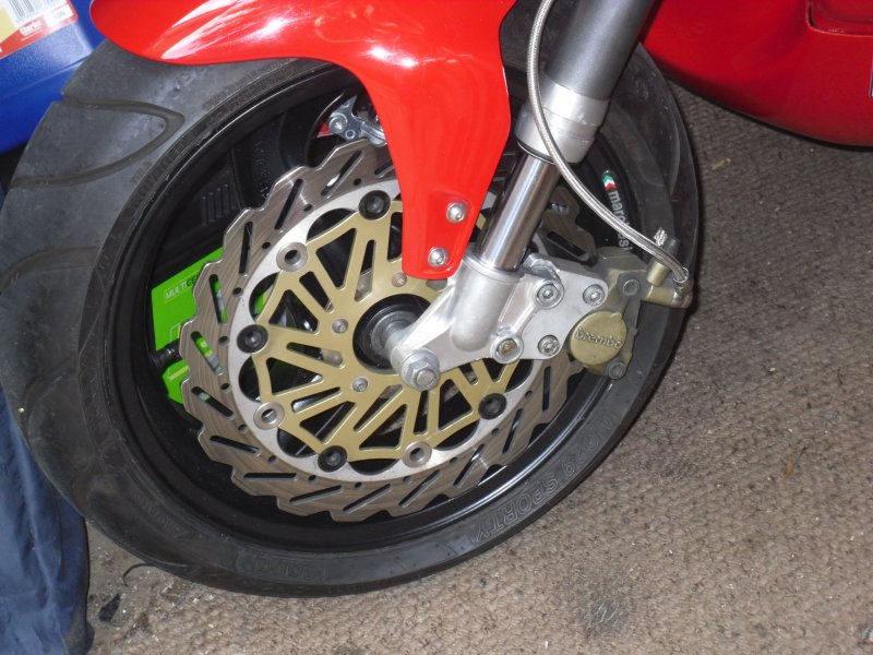

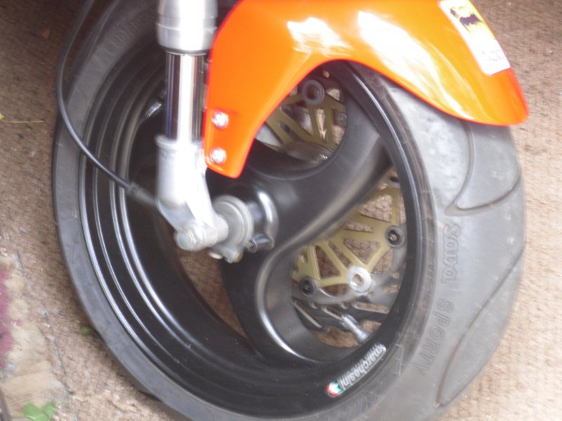

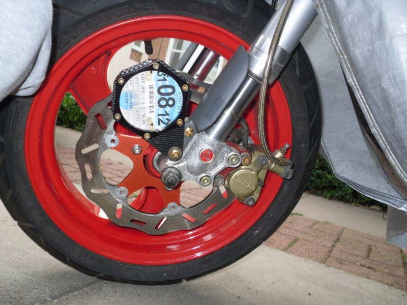

    Here's the 13" nrgfront wheel/disc on the grey typhoon, the disc is from donotlink pedstop and comes with caliper extension. The only thing needed was to space the caliper inwards so it lined up with disc.

    Shall I look for it as piaggio nrg brake disc??
  6. MARSH
    MARSH Whooooo!
    3,266
    Piaggio Typhoon
    Aftermarket Piaggio typhoon disc.

  8. pamarakos
    pamarakos Member
    35
    There is an issue with the rear wheel...my brake as in the photos avove was 108mm but the nrg rear wheel I received 100mm...now what??? Shall I return it back and look for an nrg rear wheel with 108 drum ??? What was the wrong part ??
    Please help!
    Maybe I can replace my drum with the smaller one??
    Front wheel is fine!!
    Thanks

    Measure up the Mc3 rear wheel, your trying to use Mc2! i could have measured them last week but i scrapped some old typhoon and nrg wheels.

  12. pamarakos
    pamarakos Member
    35
    Yesterday I ve received it...today I ve tested it and guess...success!! :)) Guy from uk that have sent it was right for the 110mm...so it fitted nicely...now there is the repaint to black (it came blue) and tire brand pick...most possibly metzeler!!what do you think??
    So it was mc2 with three bolts for the.front and mc3 for the rear!!
    Thank you fot the continued support
