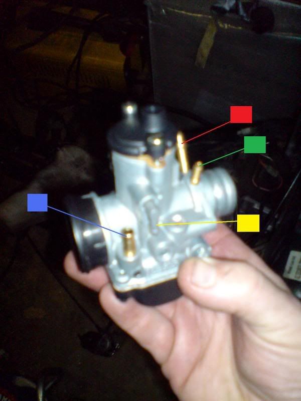

    This is my Malossi 21mm carb. My best guess so far is...
    Red=Large pipe connector on inlet=Vacuum for petrol tap?
    Green=small connector on inlet=thin pipe coming out of oil pump?
    Yellow (one on each side of carb) coolant from cylinder head?
    Blue=Fuel inlet?
    Anyone care to give me a pointer?

  5. MiNoR cOnFuSiOn
    blue is fuel.. vacume an oil are correct and the other's arnt water.. there overflows ;)

    So I'll have to cap off the outlets at the head then? I'll just connect them with a pipe. I don't suppose carb icining is much of a problem these days anyway....
    Thanks very much for the pointer ;)
