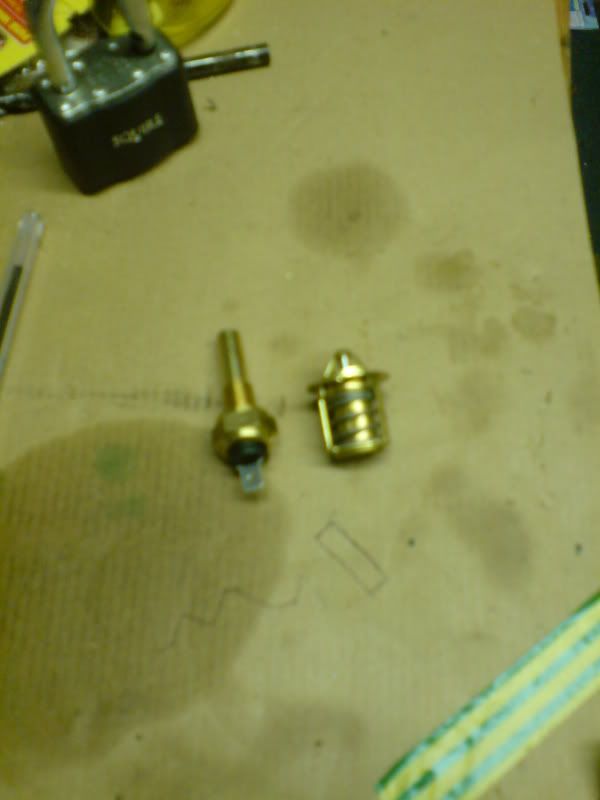

    One Yamaha Thermostat and one temperature sender.
    Guess what? The thermostat didn't come with the screws needed to fit it. :wallbash:
    Went back to the bike shop and he couldn't supply them but recommended a Lifestyle Ford dealer. I couldn't be arsed with all that old bollox so I tried a few screws I had lying around and cut them down to fit with a couple of small washers holding the lip at the side of the thermostat. It works. The screws which fitted in the end were the thin ones which hold on a lightswitch or powerpoint. (I think that's a 1mm thread)

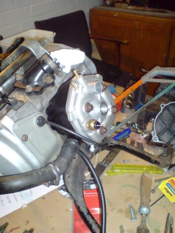

    FINALLY! Fitted the head and did the nuts up to 10lbf.
    Hopefully next week I'll fit the rear wheel off the other engine ans whack it back in the bike.

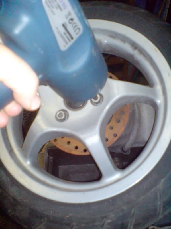

    Well I went to change the back wheel across from the old engine. I couldn't shift the allen bots till I used my electric impact gun on them, then they came off in seconds.
    Took off the caliper to find that the pads were down to the metal. Back to the bike shop again! :confused:arc:
