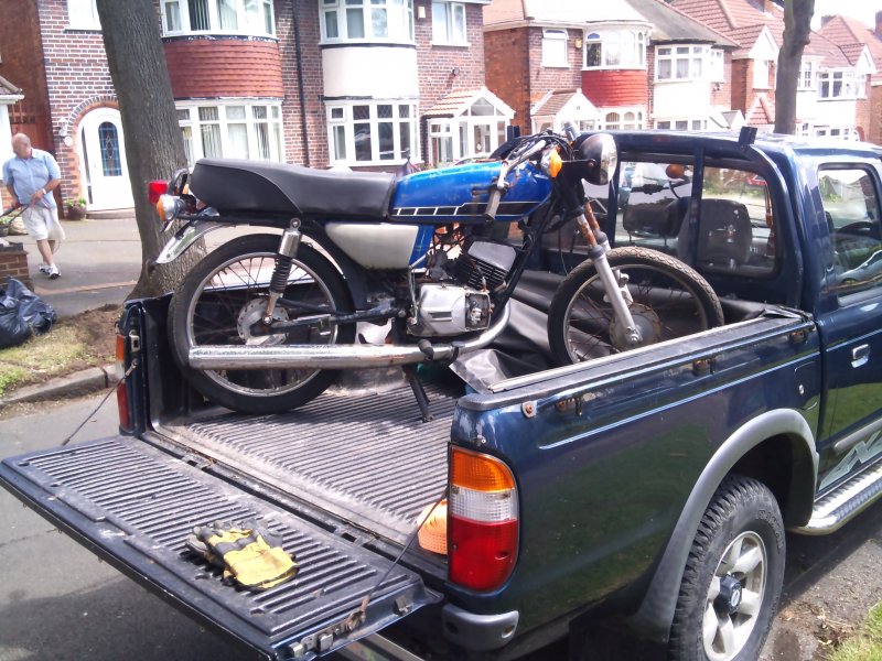

    It started life as this when I picked it up from a friend of mine.
    It's a 1975 Yamaha RS100. A little research turns up it was only made for two years, '75 - '76.
    The back story is this:
    It belonged to a friends wife way back when, then she passed her car test, used the fathers car all the time and this ended up sitting in the back of the garage for the rest of its years. Eventually the garage had to come down before it fell down and this got relegated to outside. But not for long. That's when I got asked if I would be interested in it. I hadn't got a clue what it was for the first few days, and a few members on here finally steered me in the right direction to correctly identify it as a RS100, and I hasten to add RS100 and NOT RSX100.
    I only got it because the lady owner would only let it go to someone who would restore it. She wouldn't allow it to be scrapped, emotional attachment. Understandable, we all get misty eyed over some of our previous bikes don't we....

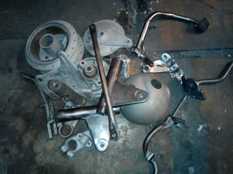

  4. Stevep
    Should be collecting the frame and swing arm from the powder coaters on friday hopefully.
    Plenty of parts stripped in the shotblaster, going to start painting them tomorrow.
    Some gloss black, some bright silver, some will get polished;)
  5. Stevep
    I think all the bright silver painting is now done, hubs and brake backing plates, lower fork legs, sprocket carrier.
    Not much to be done silver strangely, had to check a few times to make sure......o_O
    Black parts up next;)
    Itching to get the frame and swing arm back.

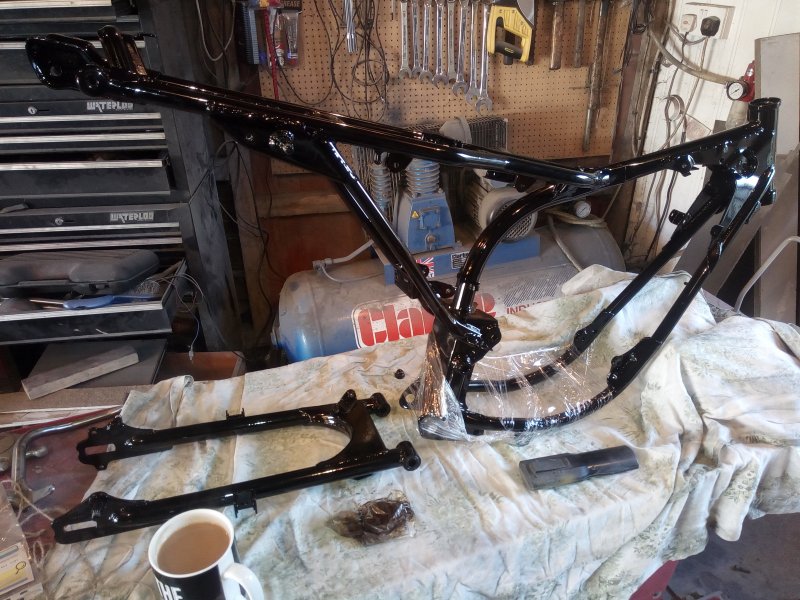

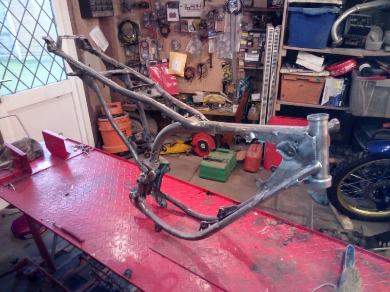

  6. Stevep
    Frame and swing arm back:)
    Looking forward to this one IMG_20190216_094409[1].jpg IMG_20190216_094513[1].jpg

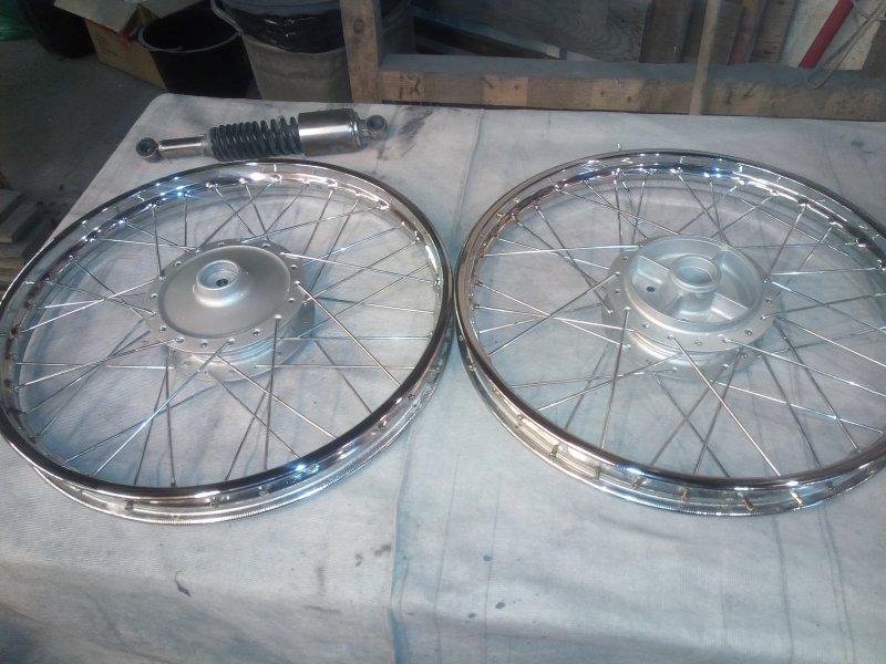

  7. Stevep

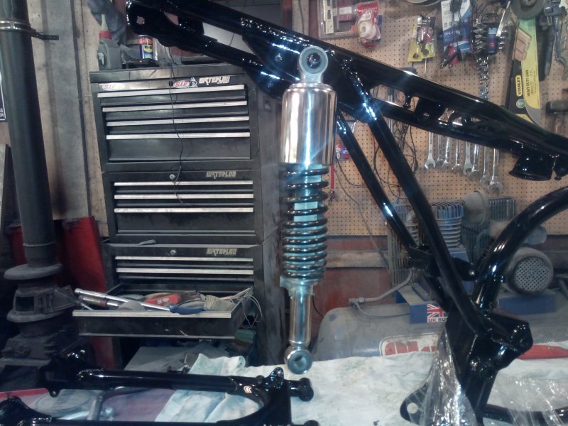

    Got the new rims laced up, not trued them yet. Fitted the top and bottom yolks then found I need new steering ball bearings, left them in for now though. Had a play at polishing one of the rear shocks, came out nicely. IMG_20190217_192217.jpg IMG_20190217_165442.jpg
  8. Stevep

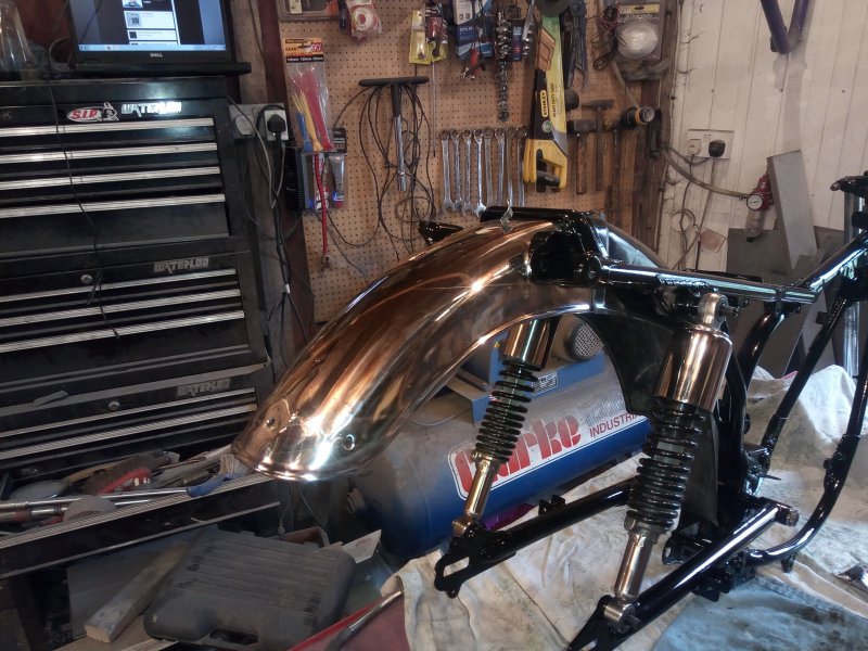

    Both rear shocks have polished up quite nice, got the swing arm in. Nothing bolted up proper yet.
    Dropped the old fork tubes into place just for stability at the front.

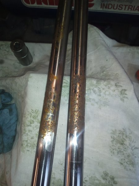

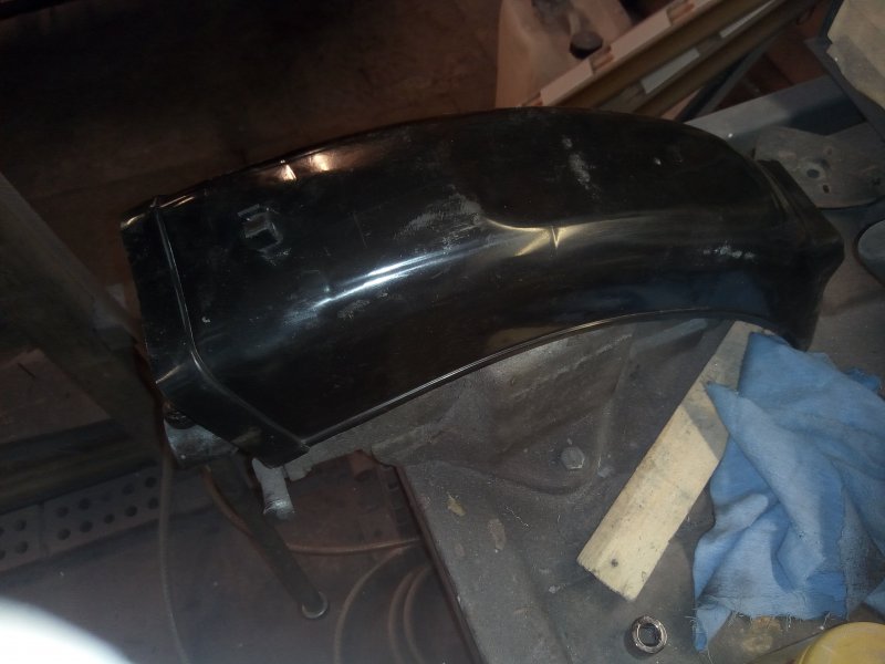

    This might clean up better
    Yup
    And so should this
    Dunno about this bit though, nasty scab.
    Yeah, that worked just fine
    Amazing what can be done with a couple of polishing mops.

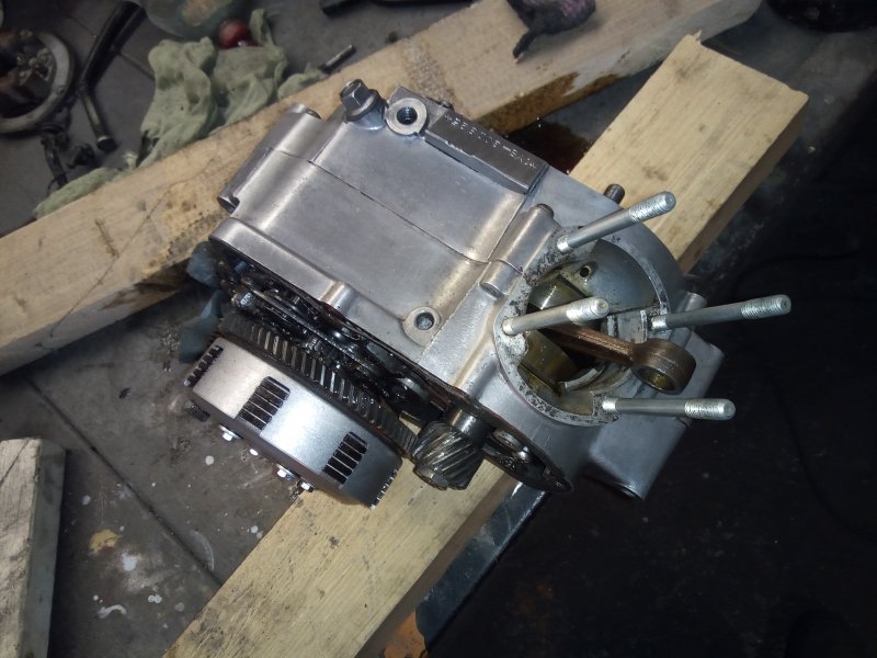

    Barrels in good order, no scoring, looks like there has been some blow past the rings though. New set of rings should sort that out. IMG_20190304_100101.jpg
    Wondering why half the engine is black.......

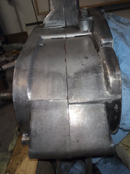

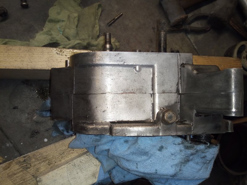

    You know....I'm halfway inclined not to paint this engine block.

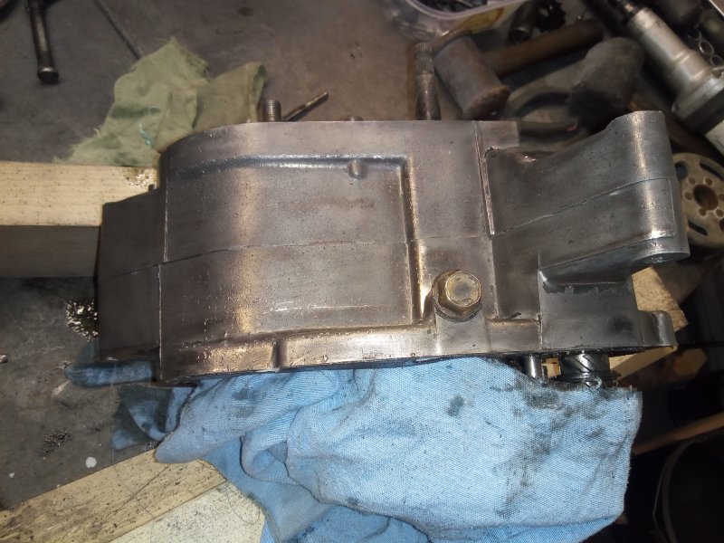

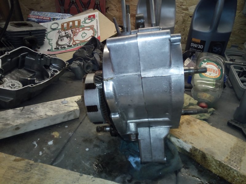

  18. Stevep
    Well that cleaned up nice didn't it
