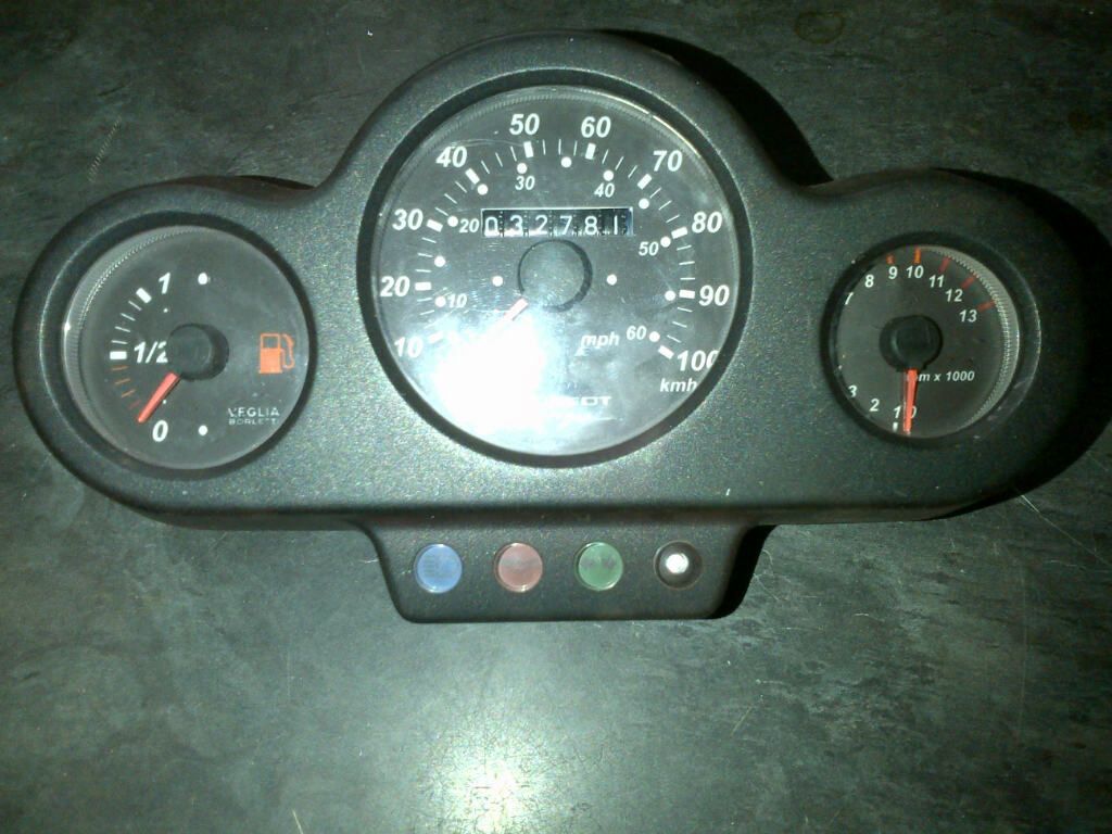

    2,305

    2,305
    2007 TKR WRC 50
    It's not fully assembled and wired up yet, but this is proof that the rev counter fits and that it can be made to look as if it was factory fitted. I'm really pleased with that result as it looks the shizzle, with the matt finish retro black dials.
    I still need to put in the screws for the new rev counter, fuel gauge and speedo dials, fit the needle end stops
    and work out how to wire in the right hand clock illumination bulb, as the original twist socket bulb won't fit now the rev counter is fitted. I have the bulb from the Chinese rev counter that has a rubber bulb holder, so I'll most likely use that and come up with some way to secure it inside the clocks.

    2007 TKR WRC 50
    Thanks, guys. It was a lot of measuring/re-measuring, Photoshopping, printing, laminating and fiddling to get it all to come together, but I've fitted the dial screws, added the needle stops and hard wired the clock bulb nearest the rev counter, as the twist socket had to be cut into to fit the rev counter. Five minutes with a soldering iron sorted that out.
    It lights up nicely too. :)

  11. Mark Emerson Trentham
    Like the way 90 corresponds with your line of sight,with the rev counter.....when you're heads buried in the clocks.:D.

  13. Merlin
    Merlin Old School Biker
    2,305
    2007 TKR WRC 50
    It's not as hard as I thought it was going to be, Scootz.
    I even got a spare set of Speedfight clocks, just in case things didn't go as planned. Cutting the hole in the back of the binnacle was the most nerve-wracking bit.
