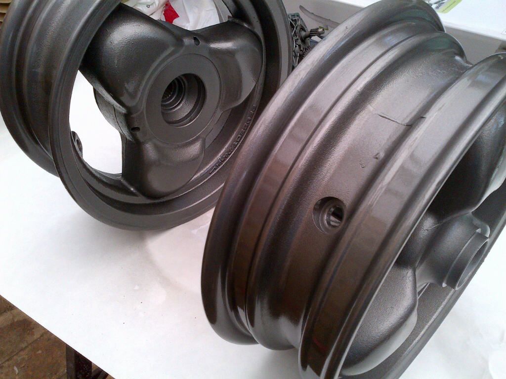

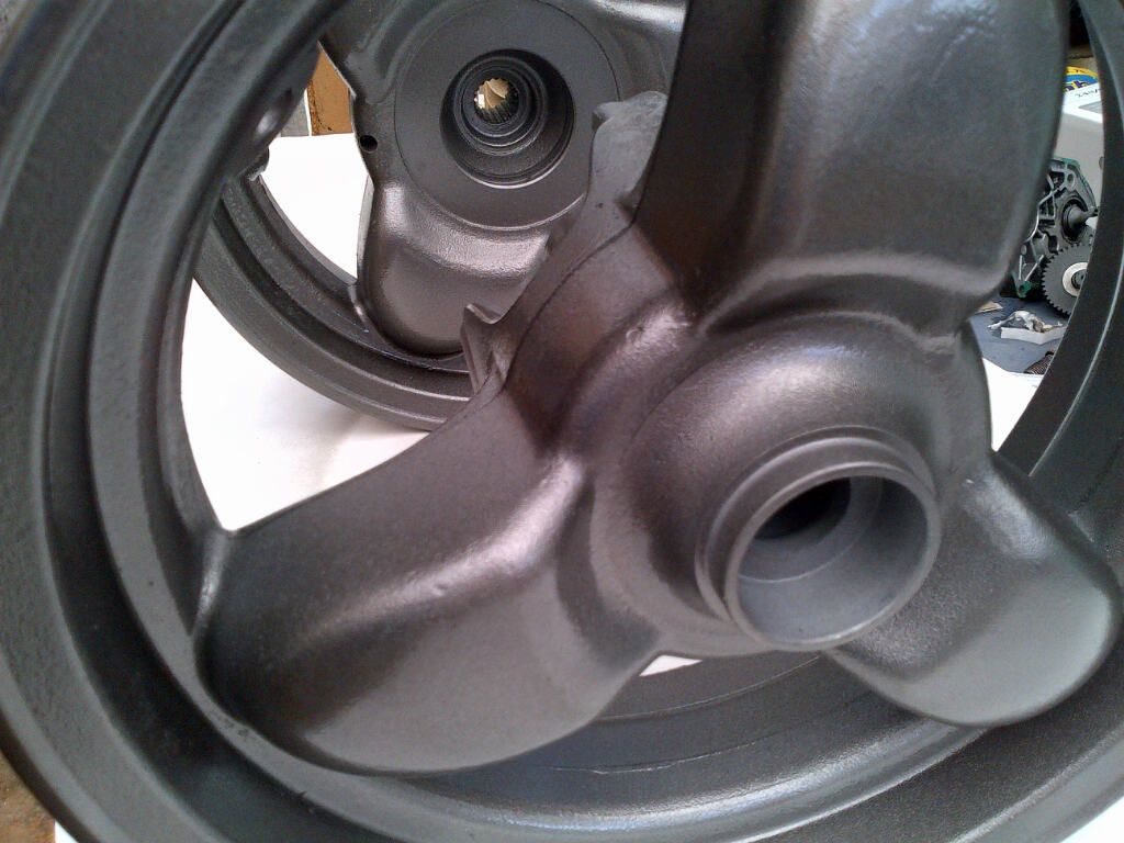

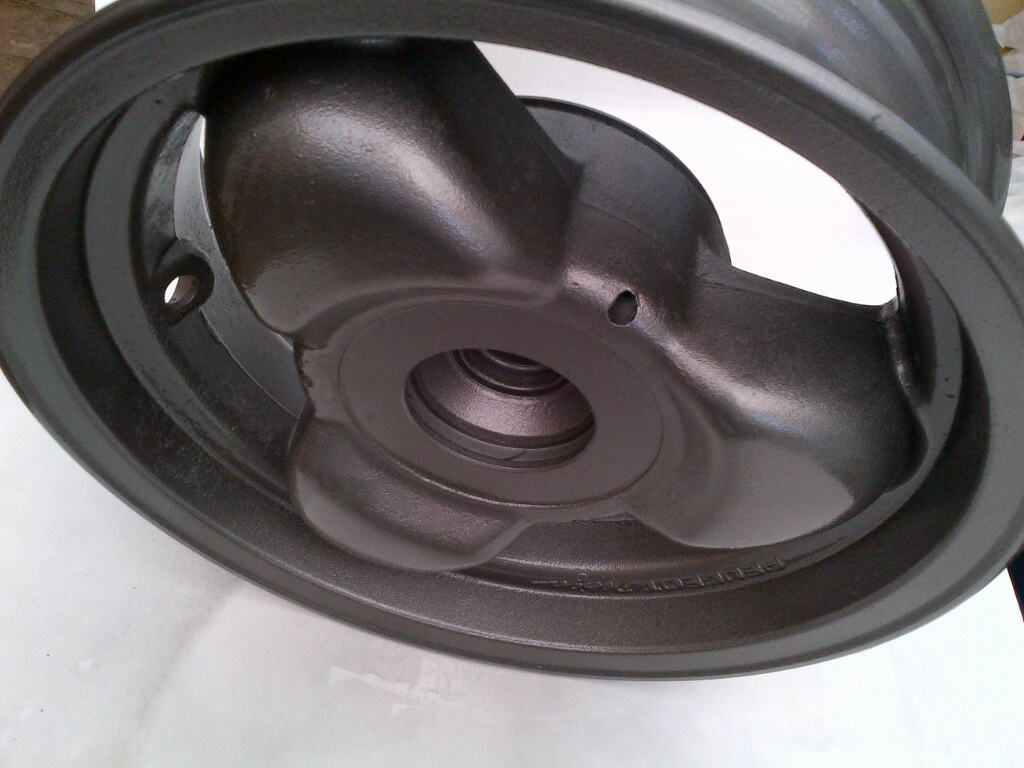

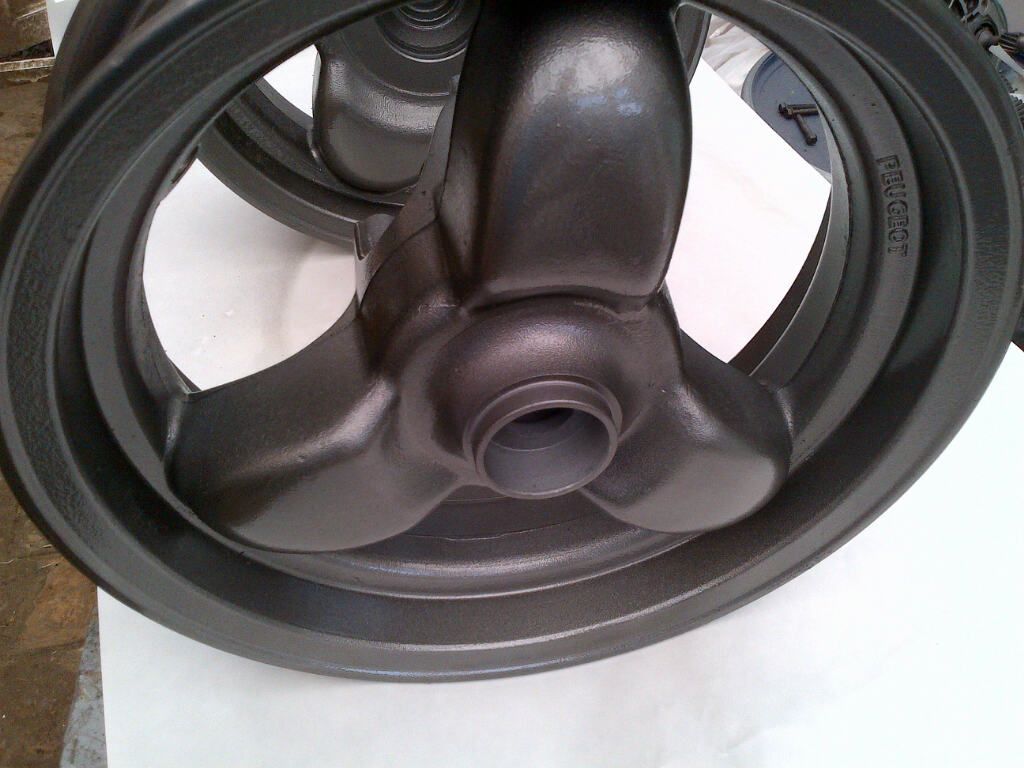

    OK, today has seen me finish off the replacement wheels for my TKR2. To recap, this is what the original back wheel looks like and the front is no better.
    Now for some scooter porn. Get a load of these replacement wheels.
    These wheels were paint stripped, acid etched using Oxalic Acid to remove the oxidation (much more effective and harsher than Citric Acid, but these wheels needed it), then two coats each of U-Pol No.8 Acid Etch Primer, two coats of Graphite Grey paint and two coats of heavy duty Polyurethane lacquer. You can't even see where I repaired the tyre bead rim at all. Now I need some tyre valves and some new tyres to make these look the absolute dog's danglies. The paint finish is flawless and the photos don't do them justice.

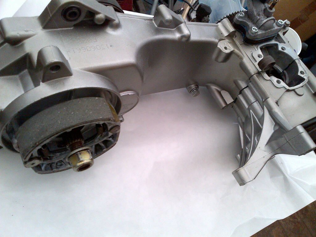

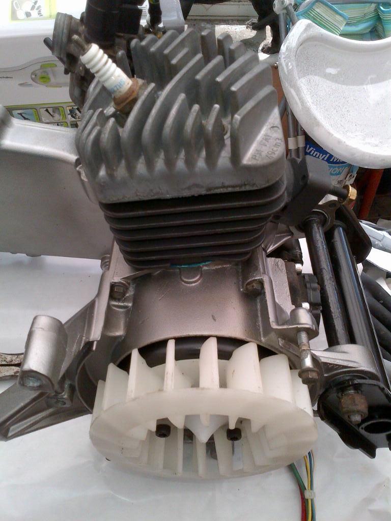

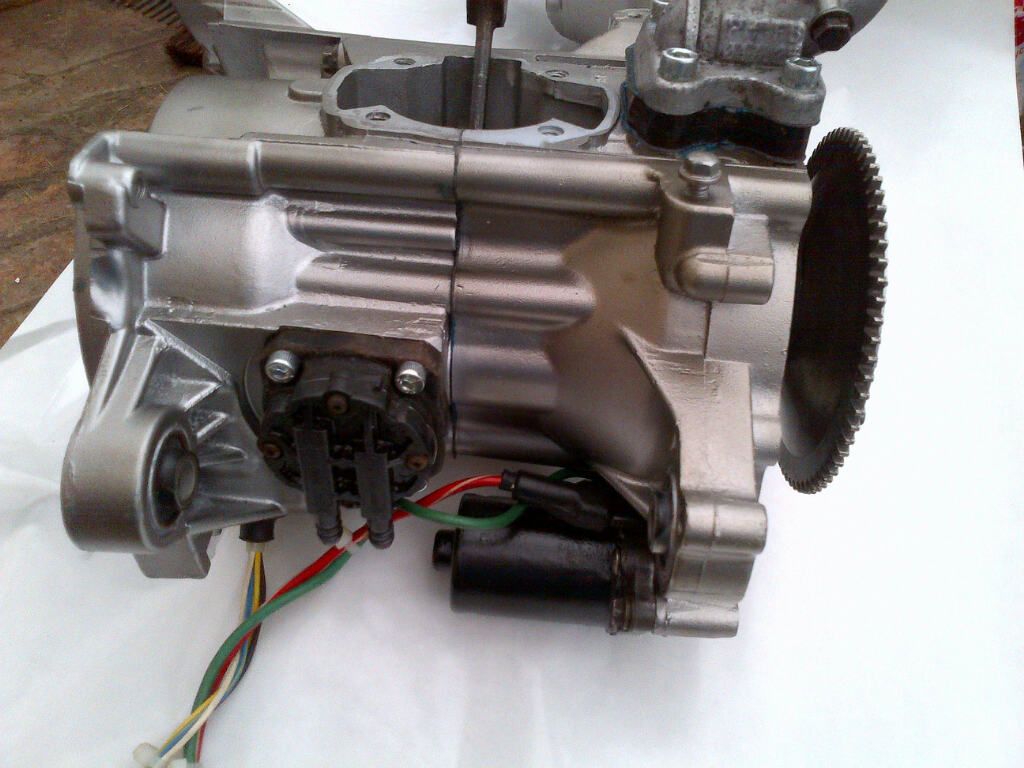

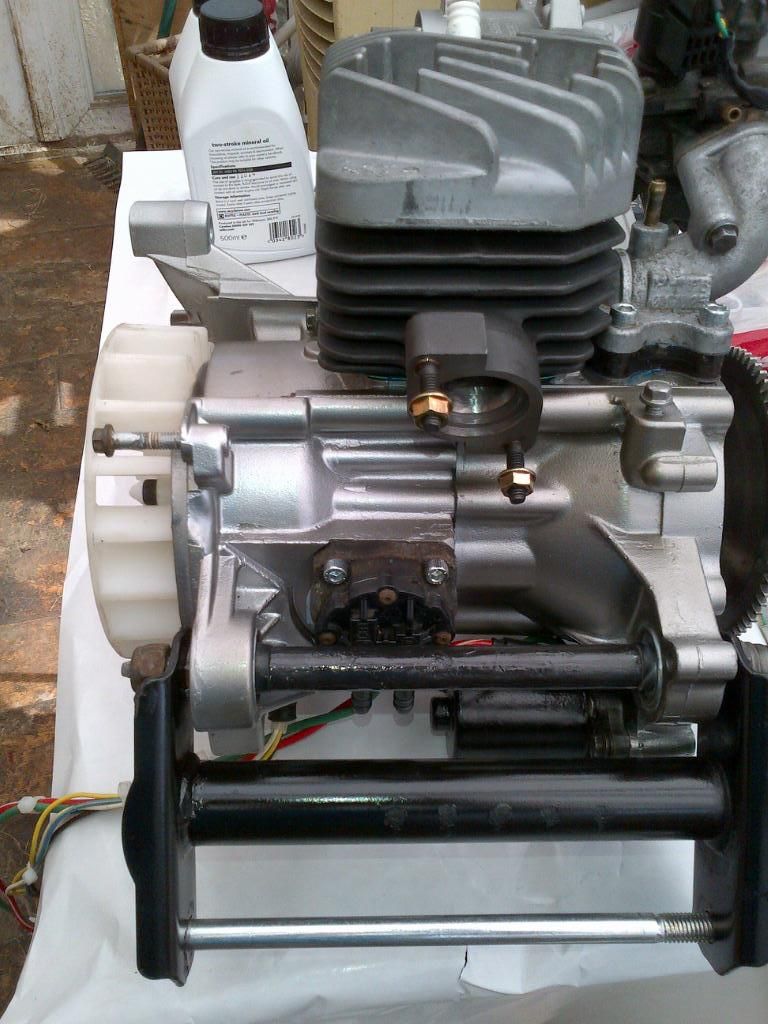

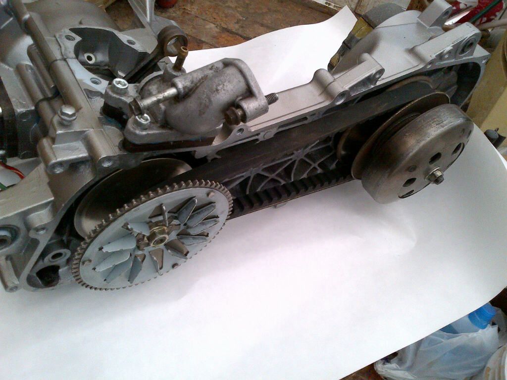

    I made some more progress on the engine re-assembly today. I've installed the crank bearings and new seals, re-fitted the crank and assembled the crankcase, then assembled the variator, clutch and the belt. I assembled the stator and flywheel and after fitting the reed block and carb manifold I've called it a day.

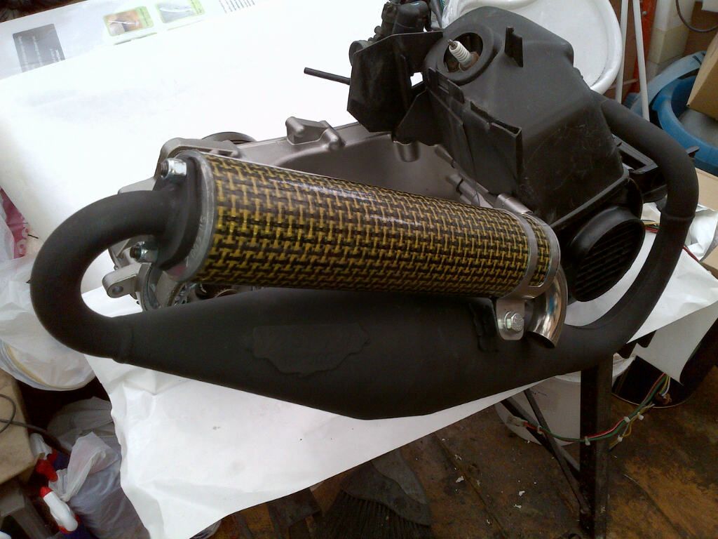

    Here's some more pron, starting with the £11 Yasuni (I paid £11.21 actually) that I mentioned.
    It looks brilliant after a good scrub, some black HT paint and some new nuts and a new mounting bolt. Here's where I am up to with the engine. Warning! Gratuitous open crankcase shots!
    Pretty smart, eh? I even painted the starter motor once I had got it working again. The engine's got Polini carbon fibre reeds in it and for now, I'm installing the stock 12mm Gurtner carb until it's done a few miles and bedded everything in. All gaskets have been given the Hylomar gasket sealant treatment, I've applied copper grease to the rear brake pivot and thread lock to the variator, flywheel and clutch nuts. It's got a Polini racing variator with 8.5g rollers and a Naraku Kevlar belt.
    One crankcase locating dowel was being a pain in the arse as it was slightly damaged and out of round. I couldn't get it back to round enough to make it fit both sides properly, so I 'MacGyvered' my way out of the situation, by cutting some 15mm copper pipe lengthways with an angle grinder and a cutting disc. I cut a short section off, at the length of the dowel that was required, then I kept trimming more and more off the tube lengthways to reduce the diameter until I could form it with pliers around an 8mm bolt, to make a perfectly round 10mm diameter locating dowel with close fitting ends. After a bit of filing to taper the ends I was done. Success!!
    I want to trickle some 2T oil into the bearings and the big end, before I assemble the cylinder and piston tomorrow. I've applied a tiny dab of grease to each of the crank seals to give them a head start and to stop them getting torn up at start-up. I've given the flywheel cover a spray with some black spray paint, to tidy it up before I install it tomorrow.
    I've an idea as to how to chamfer the corner of the piston crown slightly, to improve the port timing without having to modify the cylinder. I'll give the idea a dry run before I tell you what my cunning plan is.

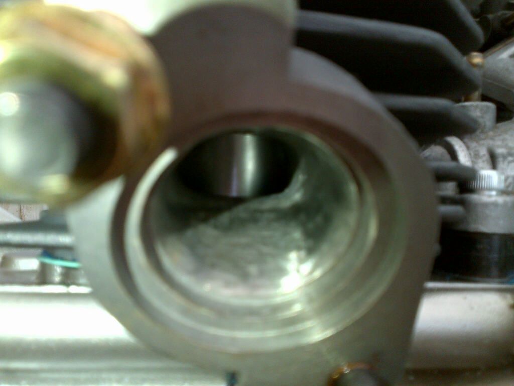

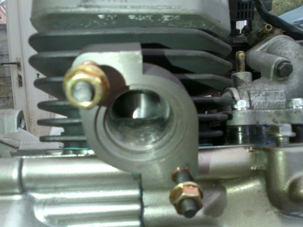

    More pr0n for you. Here are some nasty, filthy, wide open-port shots of the exhaust porting work that I did to the cylinder.
    It doesn't need to be super smooth, it just needs to promote better gas flow. For those of you that have read Jennings' and Bell's books on porting, I found a way to chamfer the edge of the piston crown, to slightly adjust the port timing without having to grind the cylinder and potentially ruin the Nikasil lining. The books say to use a file, but I found a much simpler way that is more controllable and I think gives better results.
    I found a piece of angle iron that was larger that the piston crown diameter among my junk/MacGyvering pile of stuff. I folded a piece of wet and dry sandpaper into the fold of the angle iron, then I offered the piston up to the L shape of the angle iron at an angle of about 45 degrees and then rotated the piston against the sandpaper with constant pressure, ensuring that the whole of the piston's edge was sanded. I stopped when I had about half a mm of a 45 degree edge to the piston crown and then cleaned up the piston, fitted the rings, then installed the piston and barrel to the engine.

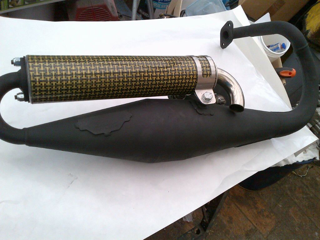

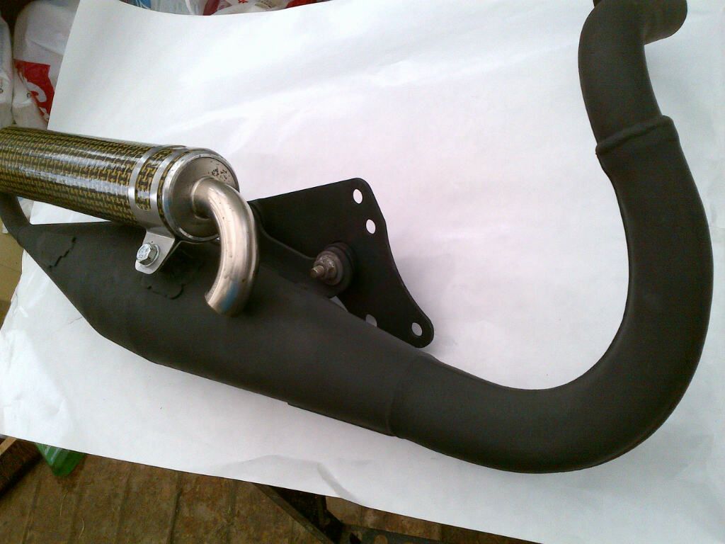

    I've found a 17mm Dell'Orto for my Peugeot for the princely sum of ten British pounds - get in! OK, so the electric choke and the carb top are missing (I don't know about the throttle slide and spring) but the 'wrong' Dell'Orto that I have can donate those parts to make a working unit.
