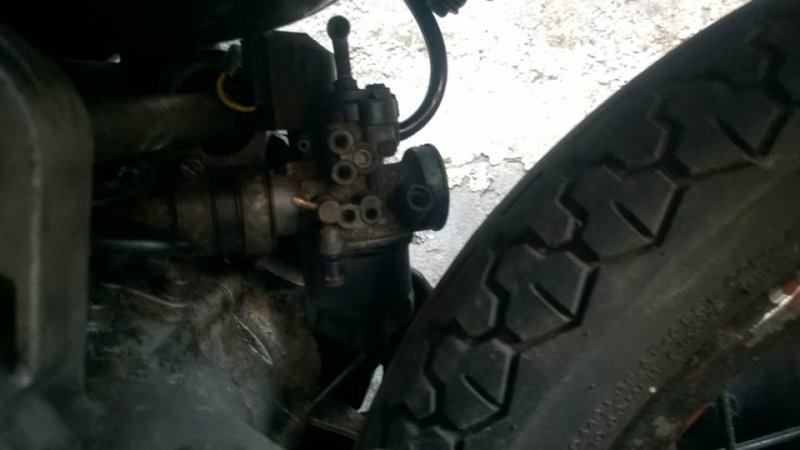

    I haven't been able to work on the Italjet much, but I got one step further last night. finally got a new carb (used but new to me) and cleaned the internals, made sure it was all good. fitted it to the scooter, auto choke works fine - my idiot brother couldn't figure out that there was a manual choke on the old carb so he was starting it with easy start constantly. all I need to do now is add a drain pipe, block off the oil inlet on the carb and fit an old airbox from a Chinese scoot or one of my brothers old Hondas, then the engine wont get messed up from water getting inside it with a open air filter when ridden in the rain - guess who has a idiot brother who did that a few times :rolleyes:

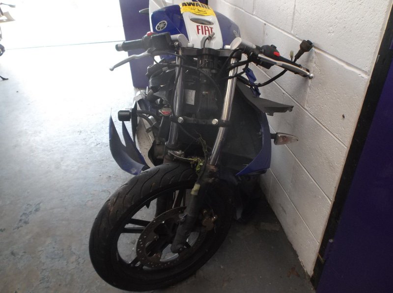

    just got back, after all that shit with Yamaha, having the bikes colour changed etc etc. this happened today. pic taken at work.
    2.jpg well I best start searching for a new bike.

    WTF,happened?.

    didnt go on my trip because there was a emergency at work. sorted that out and decided that I would follow my brother from Walsall to Solihull and then back, so I did, then on my way back from making sure brother got home ok, going down dual carriageway, my lights were on green, doing 30mph through the lights on a 40mph road, just to be carefull.
    vauxhall cavalier just goes through a red light and i smashed into his wing, bike bounced and went into the lampost/traffic light thing and he carried on across the junction. frame is bent. never to be put on the road again.

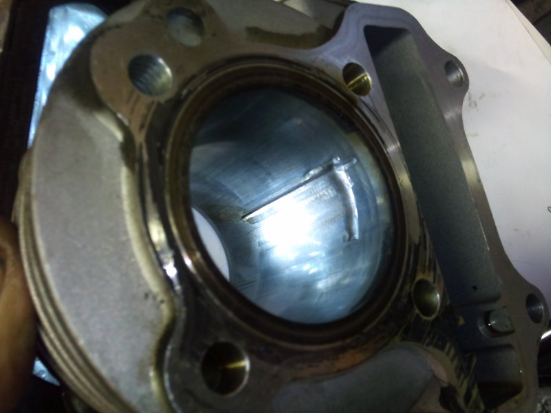

    That POS v-clic that keeps coming back in....................done the 70cc barrel. Never actually seen a 4 stroke go like this:

    V-Click = Chinese built Peugeot = made out of Craptonite, chocolate and old newpapers.
    The damage looks like either the piston ring snapped and rode over the locating pin, or one of the piston circlips came out. I can't think of anything else that could cause that sort of damage.

    Both circlips in place, oil sraper ring is broke though just above the gudgeon pin

    I've got another gy6 engine on the shelf that i took out of a sukida, standard 50cc jobbie, didn't think it would ever get used or put into another bike, but guess where the piston and barrel is gong tomorrow??????
