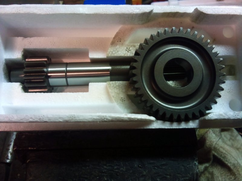

    Straight cut gears can howl like air raid sirens though, are you ready for that? You might end up sounding like a Stuka dive-bomber.

    Fecking wimmin's knickers ! Naw - just kidding. Merlin is correct. But the noise of a decent pipe will drive that into insignificance......

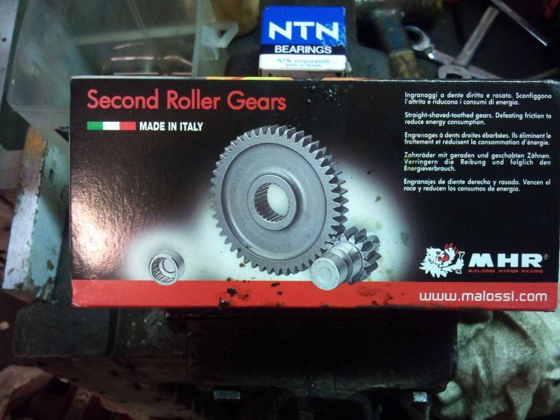

    Just ordered it. The new Malossi 15/38 gear-up that is. And the new bearing and seal.
    I've got the Malossi Pipe on it, the MHR Team Racing i think, which sounds nice as it is, deeper than most but you know i'm coming behind you:cool:

    look what arrived today:
    woohoo :D

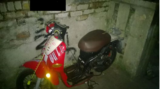

    Well at 23:20 it was finally bought home, I was greeted by my big smiling idiot of a brother and I thought he was just happy to see the scooter. well turns out my brother may like me. just a little. since my scooter got stolen and written off, he said I can have the italjet for absolutely nothing. v5 has been signed over. its officially mine.
    that is how it looks now. I had to edit picture to censor quite a rude word that my brother thought it would be hilarious to spray paint onto the wall. needless to say, now that it is mine, unlike my brother who has shelled out ALOT getting her to this stage only for me to plaster stickers on it and to rip the seat, I will be doing a proper job of this. to date this is what has been done -
    bore has been bored out to 60cc`s along with brand new piston and rings
    new crank seals and bearings
    new gearbox bearings, seal and oil.
    new gaskets all round.
    Kevlar drive belt.
    5.5g rollers.
    new clutch springs.
    new rear brake shoes.
    new front brake pistons and seals and pads.
    new bulbs all round.
    new fork oil.
    to do -
    reconnect all the wires properly.
    fit new carb and modify seat bucket to hold my air filter.
    change the fuel lines again
    get it running properly.
    derust and hammerite the frame.
    paint the wheels.
    paint the variator cover.
    fix rear mudguard.
    fix lugs on panels, respray properly and refit.
    recover seat.
    fit new rear tyre (idiot brother thought it would be hilarious to do burnouts last time we had it running)

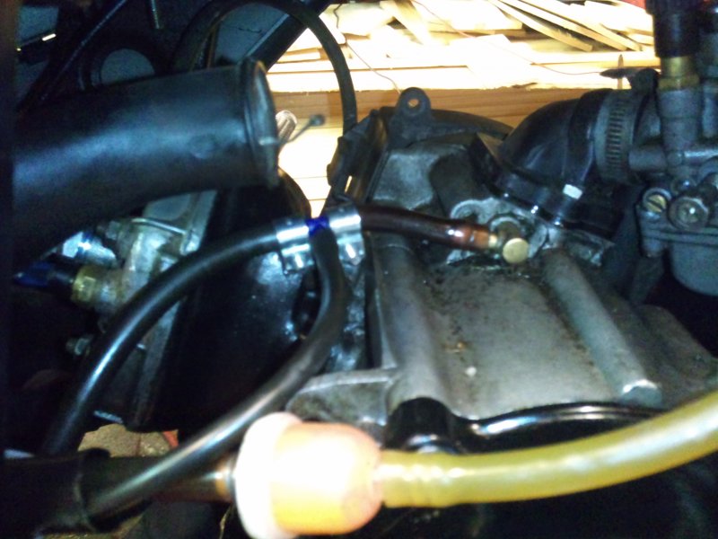

    Had an old model runner come in with running issues, would start, bog then die. Cleaned the carb, changed the filter, still the same. Checked the plug, compression, changed filters, found a pipe flopping about, turned out to be the taps vac pipe. Strange because the carb doesn't have a vac pipe on it. Also found the running fault at the same time; fuel supply didn't work properly.
    It would seem that the tap had jammed in the open position in the past and allowed the fuel to free flow, however it now seems that it has gone back to working properly, so needs the vacuum to be there. Trouble is, there's nowhere for it to go; they dont do a manifold that has a vac pipe fitted in it for the runner that i can find, but only had a quick look for one, so came up with an idea and it works nicely.
    I used a 'T' connection into the crank case pipe as below. Works lovely.
    Will give it a road test tomorrow to make sure all is well, then tidy up the pipe work a bit.

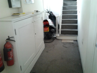

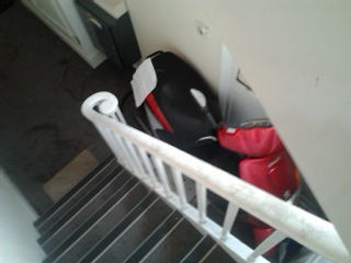

    Parked the V/C in my hallway,did'nt have a problem at all,in getting it in the front door-
    once I gunned the throttle........a bit.:D. 2014-06-21 15.16.22.jpg 2014-06-21 15.17.19.jpg
