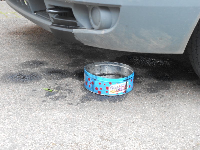

  18. technodimwit
    technodimwit Active Member
    321
    Honda X8R

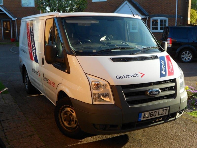

    you should be ok steve,
    looks like its left the other half of the sump load on my drive...
    dont go near the park farm estate tomorow, as i'm dropping the van at the ford dealers about 8:30ish..
  19. scootzmadness
    and im picking a ford focus up from near there :confused: ill possibly see you on the road steve :cool:
  20. technodimwit
    321
    Honda X8R
    Just avoid me tomorow.....
    i will have refilled the engine with oil,,,,
    hope i dont leak to much on the 2 mile drive to the service center:oops:
