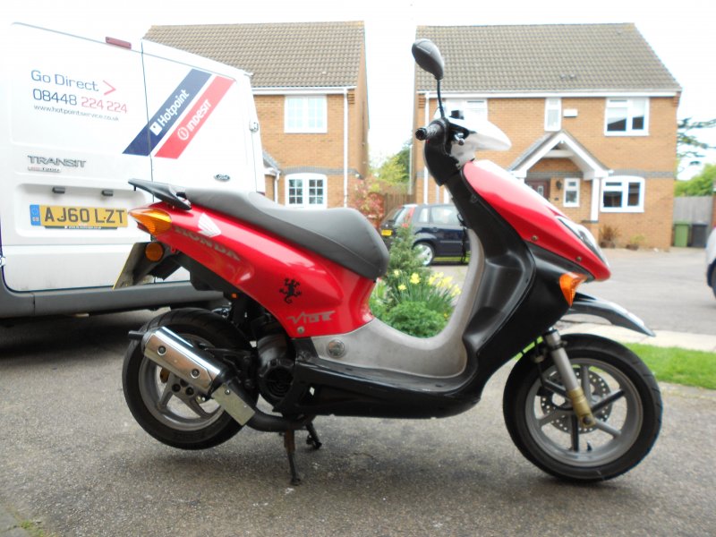

    my baby PASSED the mot
    yiiiiiiiipppppppeeeeeeee
    so out came the bucket and sponge, all nice and squeeky clean..

    look at it! why wouldn't it!

    intended as a compliment on the condition of the machine. And a subtle rant at MOTs.....

    hi,
    required, new rear disc, rear suspension and stearing bearings to pass.
    one small bad point, the front disc now needs replacing at some point.
    mark
