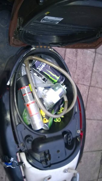

    organised under my seat ready for tommorrows ride. lots of tools under there, both my locks, but mainly filled it with all the tools i could ever need/probably will need.
    this is how bad it was before :/

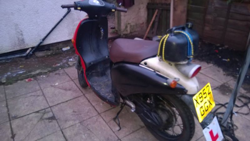

    and got the scooter ready in general for tommorrow, new spark plug and filled the tank right to the brim, going to fill the petrol can up tommorrow morning.

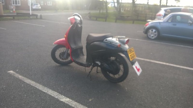

    decided to go visit the wall roman site. saw 60mph on the clocks on the A5 with head down, legs tucked in and everything. just sat in a small car park for a while let it cool down and i went off to visit the site.
