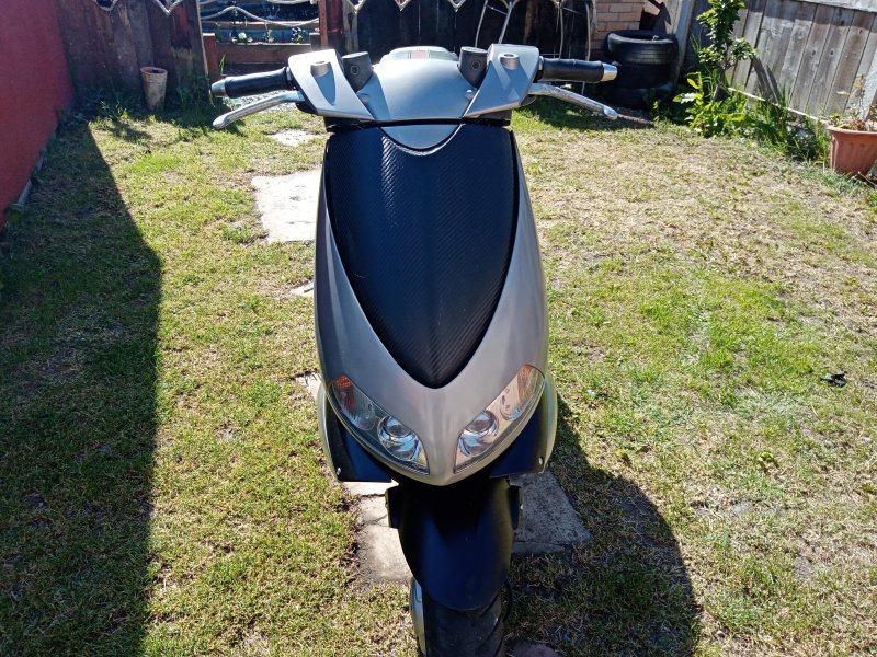

Well the old girl passed its first mot in 10 years no i didnt have it that long lol after 3 year of me owning it and the never ending mechanical issues and parts to find here it is. Funny thing is i still have not tested it yet so aint got a clue on how fast it goes it seems to run good first time start with no choke smokes a bit for a min or so but that fades thanks toy you guys and the help you have given i will test it when its taxed and insured and update u with speed etc at least now i can try different things then legally test it on the roads without risk.
Yeah the problem was i couldnt get it to go any faster that 20 25 mph i gave up risking road tests just bought the required stuff with the help from the guys here but not tested since i thought id bite the bullet finish it get it tested insured this week etc then i can mess with it more n test as i go without worry of getting pulled hopefully its ok it sounds a lot better now revs up on point so im hopefull
Oh yeah m8 now taxed insured etc took it for its first legal run in 10 years and im getting flat out now 34mph the wind hits me im down to 28 mph god help me uphill lol and me mate was behind me in his car weird i know lol but he said its smoking to the point of getting pulled by the law i reckon its letting too much 2 stroke in so im going to kill the tank and mix direct in the fuel tank i believe its 100ml 2stroke per gallon not 100%sure lol if its not the fact of too much oil what else am i missing here its got new everything im now at a loss as its cost me more than i believe its worth but i declared war on it and this P O S is winning lol @MARSH you aint wrong on that like its took nearly 3 years to find all the parts LMFAO

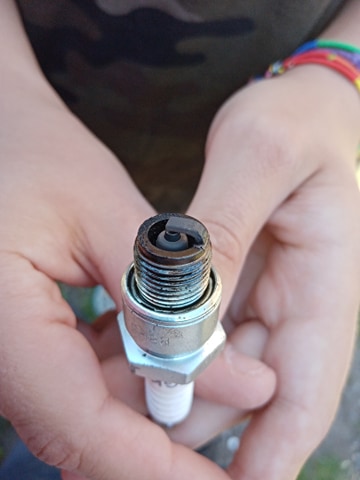

Update ...I took the airbox off to find what seemed to be petrol in there so i started it up gently covering the carb by hand and it seems the carb is spitting fuel out also thought id remove the sparkplug to see if its normal for a new plug its done about 4 mile on test run
Was also wondering if it could be the head or piston any ideas what results of a compression test should be around im going to pick up a compression test kit its a new piston n rings on a old head....just a thought behind this speed issue
Plug look's ok, head won't be a problem. P.S.I. should be around 100+/- I'm guessing. Stevep would know better.
