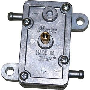

    fuel pump got rebuild - cleaned and meter tested its giving correct measure of fuel to carb. i even got a mikuni copy pump shop fitted it kicked bike over and the motor couldnt run a high enough pressure to pump, fuel just trickled out ( still have the new pump here to) but it runs the stock peugeot/ sym pump just fine with a strong stream of fuel.
    fuels working ok now, its just lean as hell up in wide open throttle , you pull over and the bike stinks of overheat ( that tell tail sticky heat smell) . sym sell the bikes overseas non europe derestricted (45mph ) and every one is sold with a 17.5mm carb fitted . so i am in hope the new 17.5mm carb is what is needed , ( yep they still run the same fueling pump on the none eu scoots ).
    added a attachemnt of a mikuni pump ( mines a octane 101 copy of that pump )

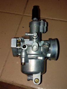

    New carb turned up..... i took it out of the box grabbed the bag and carb fell out onto the floor ( from about 3ft). it snapped off the whole carb drain nipple :( .
    now onto euroscooterparts to find out if they sell replacement float bowls. looked at the Dellorto L-DEL1438 carburettor and is float bowl is nothing like the one the naraku has, yet its a direct copy of the dello carb so it states. the oiginal dello carb does not have a choke jet fitted where this naraku one does :confused:
    booked bike in to have the carb fitted and re-jetted - set up could only get it in next wedensday so i have a very short time frame to find a replacement bowl.

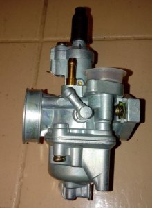

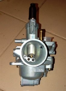

  5. Tamiyacowboy
    Tamiyacowboy Pippa's Owner
    1,850
    Piaggio Skipper

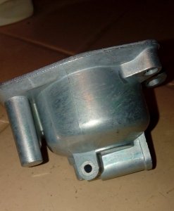

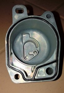

    Naraku no brand name carb ( meant to be a dellorto copy R1438 carb)
    i am unable to find a shallow bowl , all bowls sold for this dello carb are large bowl and will not fit scooter due to bowl resting upon variator cover/engine cover. notice inside the bowl its got a 60 size choke jet to. also notice the blocked out port hole and screw hole in carbs air inlet side and beside the idle/mixture screws ( any idea ? i thought maybe a choke adjuster or possible a seperate fuel mix screw).
    also be handy if someone could nail down what the carb is a copy from ie PHVA -PHVB etc etc
    added attachments of the carb and the flakey fuel drain nipple where it snapped off, quality wise its pony and trap 100% china made .

  7. Stevep
    You know...........I don't think I'd worry about that too much.
    Looking at the photo's, the drain screw will still shut off the fuel properly.
    The only bit that is snapped off is the 'spout'.
    If it really is an issue, where you can't get a container under it to catch the fuel while being drained, (which may be the case)
    have a thought on this:
    It looks like it might well be threaded into the body of the carb bowl, but then that's only how it looks on the photo.
    If it's part of the casting itself, then it could be a different matter altogether.
    If you suspect it to be threaded into the bowl, try a small stud extractor on it.
    Or:
    Measure the hole in the middle. (where the fuel would come out)
    If it's the size I'm thinking about, try putting a piece of the straw that comes on the WD40 spray cans in there and use chemical metal to hold it in place permanently.
    Chemical metal is petrol resistant so is suitable to use.
    Then use some oil feed pipe to extend the straw to a suitable place.
    And if the WD40 straw is too big, try some red inner sheath that is used on throttle cables.
  8. Stevep
    Or..................
    get the depth of the replacement bowl, and use a spacer on top of the reed valve block to adjust the difference
  9. Tamiyacowboy
    1,850
    Piaggio Skipper
    yeah it looks threaded in to me but closer inspection its just moulded into the body, two trains of thought , recut the inder id to accept a small rc fuel barb nozzle . if not i was thinking of drilling out to a very thin id copper brake tube and then bending said tube into shape so it flows from carb to between wheel and motor rear case ( copper i thought a better option being heat resistant and will not flop around like a silicone tube) . just gotta wait another 5 days before its in the shop and fitted and rejetted .

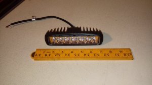

    Decided on a light upgrade. installing a 18w 6x cree led light bar.
    going stealth and hiding it under the front panel above the mudguard but suspended below the fork yolk clamps, on my sysm jet theres a secondary dirt/water guard held on with 3 bolts two up front and a single at the rear. im going to use the rear single bolt to hold the lightbar in place, the run a homemade wire harness inc fuse holder to the main battery and a stealth fitted aux light switch.
    the light switch i am thinking of hiding under the horn switch, drilling a 5-8mm hole under the horn button and fitting a tactile rubber on/off switch. out of sight out of mind for when scooter is MOT'd and incase some little nerd decided to try and switch it on and drain my battery. at 1300 lumens it should light up a fair bit of road ahead of me and means i can take trips out down the dark country lanes without worry whats coming up ( 55w candle does not light up the road very much at all ).

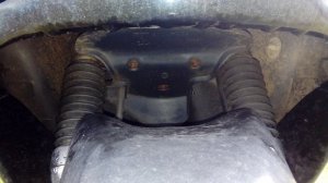

  16. Tamiyacowboy
    1,850
    Piaggio Skipper

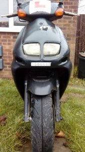

    Well the first image is where the led light bar will be fitted, its a space above the front mudguard and below the front fork yolk clamp splash guard. the two front bolts will not be used, but the rear single bolt will hold the light bar tucked up out of the way. the power lead will use the speedo cable run and be fed upto the front fairing panel then join a homemade power leash with fuse holder to power switch.
    second image is of the light bar and a rule giving folks an overal measurement of the unit. about 6 inch wide end to end about 150g weight full alloy body, plastic lens cover and holds 6x 3w cree SMD with small projector lensers. current draw is around 18w @ 10-30v and a light output of 1360 lumens and a 60 degree spread
    third image is with the light bar just resting ontop of the front mud fender it gives you an idea where its mounted and the look on the sym with it roughly in place, does not look out of place and will be tucked futher back and more inline with bottom of front fairing.
    added a fourth image, i G.I.M.P'ed up the original mock up but changed the light bar to be fitted in the front cowl right below the headlamp ( just a rough clone tool job ) , i think it being direct under the headlamp is going to have more impact on drivers seeing me and me seeing more of the road ahead.
