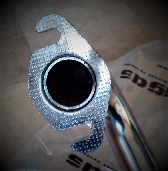

    first off here are some pictures of the new Tecnigas Trek in chrome from Adrenaline pedstop ( props for a fast delivery service ), as usual our Sport pipes are restricted, usually in one or two places, a cone in the manifold end and/or a cone in the rear tail pipe of the silencer/ muffler.
    i already had the dremmel tool out ready with a carbide cutting/grinding bit fitted. and was shocked to find the Trek came WITHOUT RESTRICTIONS , now thats unusual for an EU legal exhaust system, so it wonders if the pipes been detuned via new methods, ie backpressure - acoustic wave forms. anyways here they are as attachments . and yes its shiney ( not for long lol).

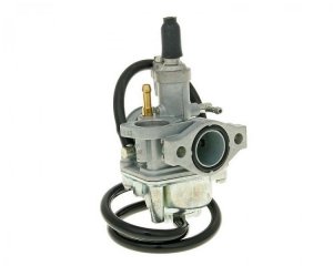

    Naraku 17.5 carb ( fits the sym jet manifold thats got a funny like inlet manifold coupling ) what your opinions , as i am looking to grab a 70cc kit when i find one.
    Polini HS variator ? again whats ones ideas on these, they do not come with a uprated contrast spring, is it worth going for this and a seperate contrast spring, or should i grab a malossi multivar ?

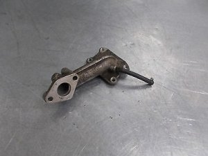

    heres an attachment of what i have to work with manifold wise. and heres a naraku 17.5mm carb that fits that manifold , but keep in mind thats a 12-14mm restricted manifold and the carb is 17.5mm.
    if i am semi seizing a larger carb would deliver a more fuel charge cooling effect that the little pokey 12-14mm carb , but the larger carb is running a 90main and 35pilot . onto a manifold that is 14mm ID. that manifold as it sits is how its installed on bike the manifold carb join keeps the carb sitting beside the wheel hugger/mudguard and inline with the stock airbox. any changes me drastic re-conifguring of the airbox using flexi tube , and puts the carb in the way of possible water spray from the rear wheel / dirt flap / drip guard
    So question is What Do I Do ? fit the carb and hope it works or try and find something i can re-pattern the mounting holes to fit the basix crank case manifold port and go with a decent known branded carb. ?

    looking at fitting say a seedfight 100cc manifold (they look the same pattern holes as syms) and should be ok for around 20mm id.
    then im thinking either that naraku carb or something around the same price but bigger . its shorter than that sym jet one so should give better throttle response to
    Airbox i was going to vent mod it , add some extra holes and vinyl wrap the outer cover, so short testing i can cut out and fold in the vinyl making more flow where needed saves running an open filter and the worry of water ingress ( sym jet gets a lotta water spray from the rear wheel even with a mud skirt and a rear hugger fitted ). also while at it enlarge the rubber hose hole from airbox to the carb and fit a larger ID hose so theres a good flow and drag out the restriction hose inside the box itself ( i think i would be better off with a larger carb and bigger jetting 17.5mm comes with a 90 main 35 pilot )
    the scoot was fine for like 4-5 mile and i rode fairly hard some of the way, but that total drop out on power really seems like its just to lean. i gave the mixture screw a good 1/4 to half turn out , but did NOT have it re-set when they stuck the new trek pipe on ( so its 100% to do with the new pipe install , so yeah maybe its now running even more leaner, pipe is meant to be a bit better on hp than the tt )
    if the speedy manifold dont work i will try grab some 6mm plate scrap, oh and i lost top end speed max now is 40mph from 47 with the vince fitted :( ... so its gotta be a gear up or a multivar fitted. but bottom end preformance doubled , 0-30 swift as hell 30-40 swift to then im at max rpm and it just dont go no futher , downhill 47 but its ragging like hell ( still staggered 6g and 8g rollers)

    purchased a naraku 17.5mm carb with the funny looking flange thats a direct bolt onto the restricted manifold on the sym.
    going to then dremmel the inlet area that 14mm out to around 18mm ID with a scooping flow to 14mm somewhat compressing the fuel/air flow as it travels down into the reed block.
    going to see how if that changes anything first, if so i may then remove manifold and open up the exit where it flows into the reed cage a little. as the sym jet manifold is just a hawking long pipe with 2x funny angled bends i am unable to find a reaming tool to bore out the manifolds ID along the tube. but going from 17mm to a flat edged 14mm flange is not a great idea hence the re-working of the flange area on the manifold inlet side.
