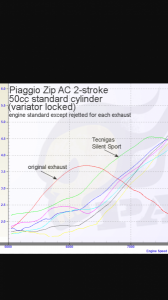

    Here is an interesting graph showing a standard pipe versus various other pipes. The silent Pro looks like a good bet. I know the rollers have been changed (surely for lighter ones) which I think I am right in thinking moves the revs higher for a given speed. So that would fit with what my son says, acceleration is a bit lacking as with a standard pipe the power starts declining after 6000rpm. If with the rollers fitted his motor is running closer to 7000 he will have a power disadvantage. If my theory is incorrect here then please let me know.
    My thoughts are that the silent Pro will be more forgiving if everything isn't matched perfectly. I am about 95 percent committed to purchasing one as it's an easy bolt on job.

  6. Stevep
    Found that on ped parts?
    Useful innit

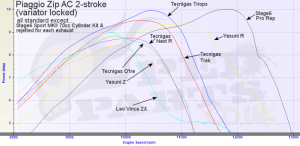

    if you willing pop on a technigas trek , this will give you a really forgiving powerband spread, so even if he went with heavyer rollers it would still do ok.
    the trek pipe powerband spread is from around 8000 rpm to 9000rpm , so as the motor builds its rpm the pipes soon going to kick in and deliver that kapow punch .
    at the mo your stock pipe holds you back due to its tuned for low rpm so at around 6000rpm its at its optimal and above its falling away , so if he is producing lets say 3.4hp now @ 6500 rpm when the bike starts to rev higher the HP will drop down to around 3hp. with a propper sport pipe like a technigas triops / trek that base 3.4hp its gonna shoot up to around 5.8hp.
    throw on a malossi multivar hi speed variator his little scoots going to top out somewhere between 45-50mph flat out on the rpm ( he going to be hitting around 9000+rpm or just shy )
    heres a couple attachments showing whats possible and another putting the sleint pro up against sport pipes ;) the slient pro makes just over 5hp at around 8600rpm ...... but if we look at the trek pipe its producing a max hp of around 9hp but this is with a 70cc barrel, so a standard 50cc barrel your looking close to 6hp maybe 6.05 hp and its operating around the same rpm and a little higher than where the silent pro hits its max

    Yup! Very handy comparison. Lots of very useful info on their site. I've learnt a lot from it in a short space of time.

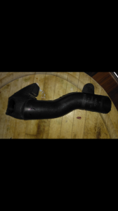

    Also found in the bag with the rollers and inlet baffle was this rubber pipe. Anyone know what it's for?
    Cheers
