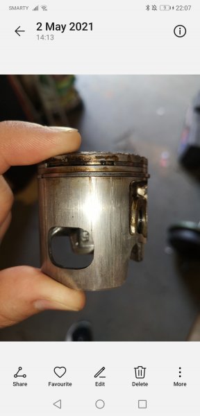

  5. Paul Smith
    Paul Smith Member
    77
    Think I've found the issue the be piston doesn't have this hole for some reason.
  6. Stevep
    Can't see that making a difference. Compression isn't measured at the side of the piston.
