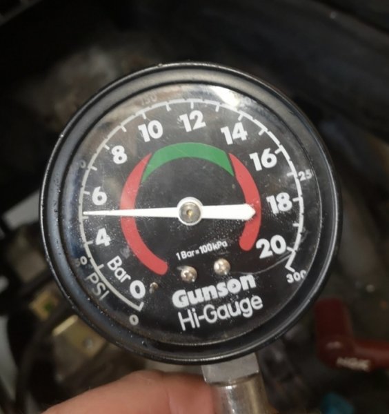

    Ok, so what could stop fuel getting from the carb to the plug?
    The carb is definitely getting fuel and I've replaced the petal but not convinced the fuel is getting to the plug. I tried easy start and no joy so just wondering how I could test if she would start if I can get it to the plug
  6. Stevep
    If it's cranking and the plug is staying dry then the vacuum created by the downstroke of the piston isn't good enough to open the reed petals and suck fuel in.
    The compression needs to be 100psi or above.

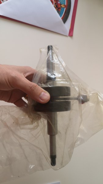

    Ok cool so I ordered a race crank and have stripped her to bits.
    Just got to work out how I can fit the new bearings in to the casing fit the crank and fit oil seals so they don't leak :-/

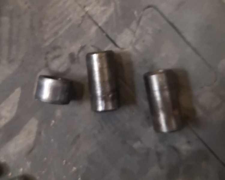

    When you split the casing a small dowel thing fall out. Can you recall where that came from or goes as mine did the same but can't see anywhere obvious for it lol
  10. Stevep
    It's a locating dowel, there should be two
  11. Paul Smith
    Paul Smith Member
    77
    I have the 2 longer ones that stayed in the casing but this was a short style one. Maybe like a little spacer?
  12. Stevep
    Ah no, not a spacer.
    I just watched the video back.
    That thing that fell out was one of the oil pump nuts.
    They are square nuts that go into a slot in the cases.

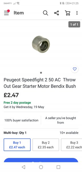

    Where does this go?
  16. Paul Smith
    Paul Smith Member
    77
    Ignore the eBay bit but it's the part I'm not sure where it goes lol. Does it just rest in the starter hole?
  17. Stevep
    Yes goes in the hole furthest to the front of the belt case. Not quite rest in there, but should press in easily.
