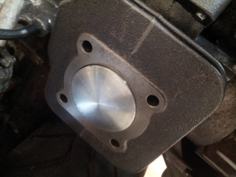

  9. andrewt
    andrewt Member
    51
    The problem am having the piston on my 70cc comes up to high i ordered another base gasket and head gasket to see if that would work if that dont work when they come 2mozz can anybody cut it down for me
  10. andrewt
    andrewt Member
    51

  12. Scooter-Noob
    Scooter-Noob God among idiots
    870
    AEROX in box's :-D
    that as to be wrong piston????? you would need like 3mm of gaskets to pack it out
