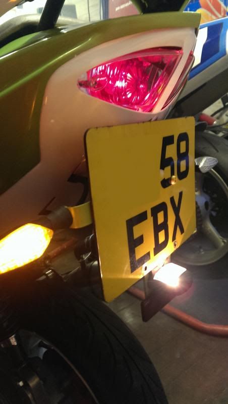

    On a plus note. The flasher relay turned up yesterday, fitted it & all the lights seem to be working spot on. I'm really pleased with the indicators, in fact, for less than £6 for the set, I'm over the moon with them :)
