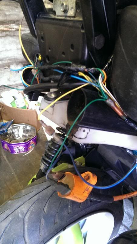

    The back light turned up today, so got into the shed after work to be hit by a right ballache. Both of the lugs are broken off on the tail unit :(
    I've moved the ignition module in readiness for the new undertray. I strapped it on with a zippy tie to the frame.
    I've made a couple of brackets & glassed them onto the tail piece. I will see how far out they are tomorrow when it's all dried.

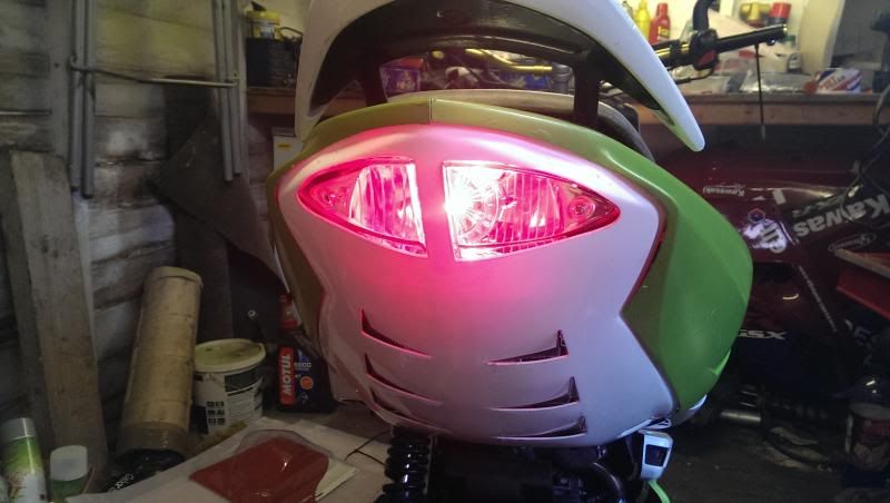

  5. croozenooze
    croozenooze Active Member
    117

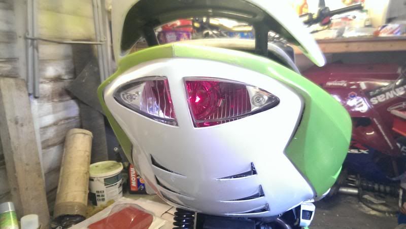

    My MTKT Undertray turned up today, not bad saying I bought it from Germany on Thursday. I'm not too pleased with the back light as it doesnt seem to be very bright. I may have a go at swapping the wires around to see if it makes any difference. My measurements weren't far off with the brackets I made. I just need to space the left hand side out just a tad. Now I have a quandry....... Green, or White lol.
    lee mason and Subw00fer like this.
  6. Subw00fer
    Subw00fer Snqʍ00ɟǝɹ
    594
    70cc NRG
    looks mad!
  7. ginge
    ginge Active Member
    589
    Looking good as always mate id keep it white looks sweet

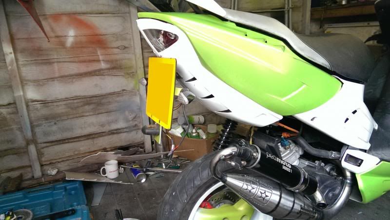

  8. croozenooze
    117

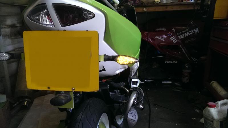

    Cheapo led indicators arrived yesterday. £5.46 for the set delivered. Just hope tgey work now lol[​IMG]
    lee mason and Alex Barnes like this.
  9. croozenooze
    117
    Spent today making a tail tidy & trying the bike out. Got a couple of issues.
    1, The indicators come on, but don't flash, so think that the flasher unit is knackered
    2, the engine seems to be getting very hot (100 degrees after only riding about 2 miles) so will check for air in the system & also the thermostat.
    I've now glued the clocks together, hence the Zippy ties holding it together.
    So, it's virtually done. I need some handlebar grips, but that's it really, just hope that I have as much fun riding as I have building it.

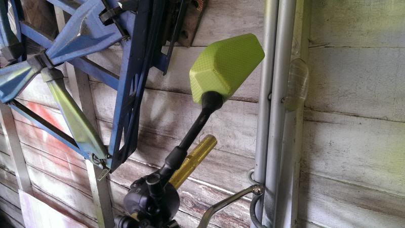

    dump the mirrors.rear facing cam and a screen.now go fit a trakker.£30 max and your find it if its nicked. L.e.d. lights might need the resistors or an l.e.d flasher to work.
  13. croozenooze
    117
    I've ordered the L.E.D. flasher after reading up about it. Thinking of going back to the original mirrors, but didn't think about colour coding..... That might be my job for today :)

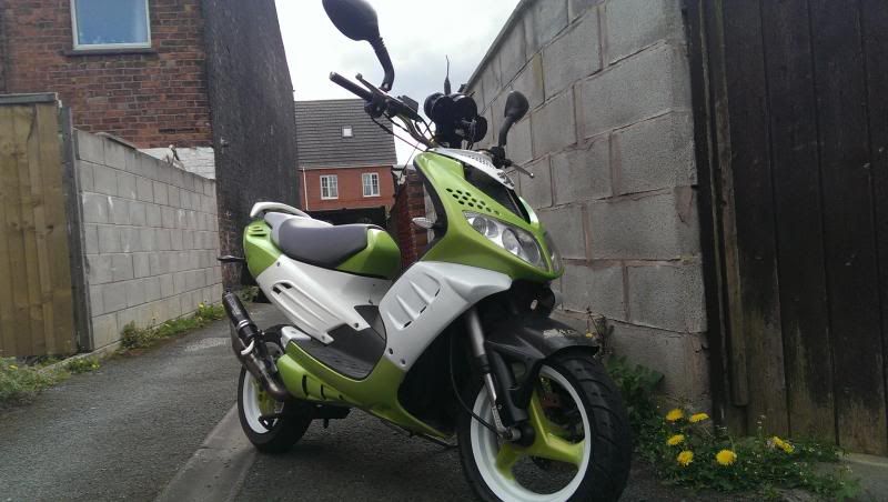

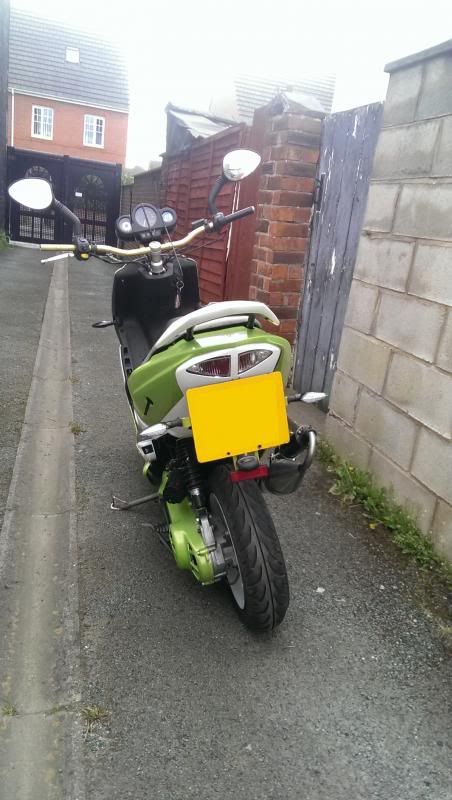

  14. ginge
    ginge Active Member
    589
    I know its probably the right ones but them tyres look too skinny especially the back one and looks like its sitting dead high
  15. croozenooze
    117
    You're dead right, it's got 2 front tyres on at the mo lol
  16. ginge
    ginge Active Member
    589
    That might explain it ;) good eye eh ;)

  17. croozenooze
    117
    Right, well, I've painted the old mirrors & Quite like them, so they will be stopoping. I also checked the spark plug. She seems to be running a bit rich, which i don't mind while I run it in a little. I also opened the coolant bleed screw on the top of the engine to be greeted by a "Pssssst", so looks like she had an airlock. I've bled it through now, had it running in the shed ticking over & revving it up for a good 10 minutes & it never went over 74 degrees, so that's hopefully solved the overheating problem.

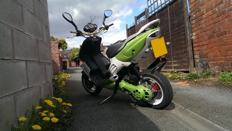

    Ooops, looks like I may have a problem with the Speedy. i took it out last night, she was running ok for about 1/2 a mile, then the temperature rose quite rapidly again. I stopped to let it cool down then headed off home. The Speedy then lost power & wouldn't pull above 6000 rpm, so I ended up pushing it the rest of the way. I will strip the barrel tonight to see what has happened. I'm hoping not too much seeing as I didn't travel too far, but knowing my luck I'll be on the hunt for a new piston & barrel.
