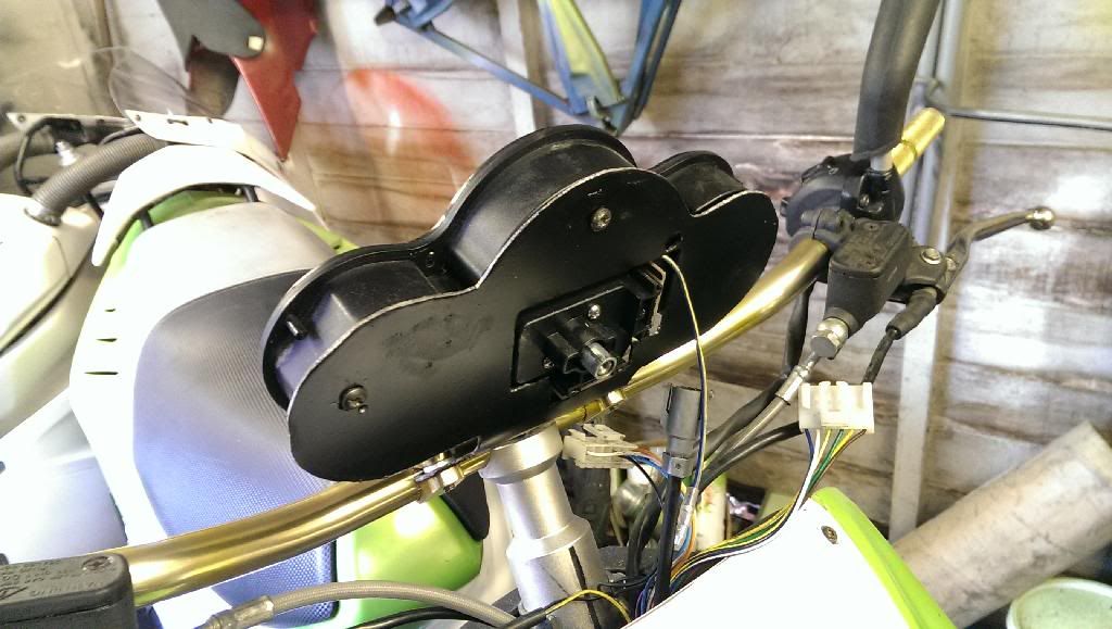

    Been busy over the last couple of days, but did get time to play in the shed. I really need to tidy my bench off, it's looking a bit full :)
    Fitted the crapflap & spark plug lead.
    I took the belt cover off to fit the new kickstart assembly, so thought I'd fit the new variator weights from 6g to 7.5g
    Also done a bit of painting.
    & dryfitted the front end & footboards. It's looking something like now
    lee mason likes this.

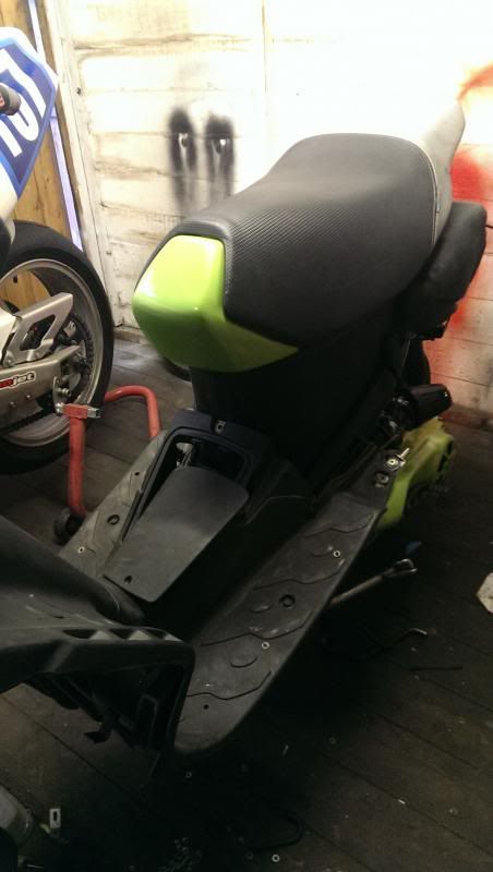

  7. croozenooze
    croozenooze Active Member
    117

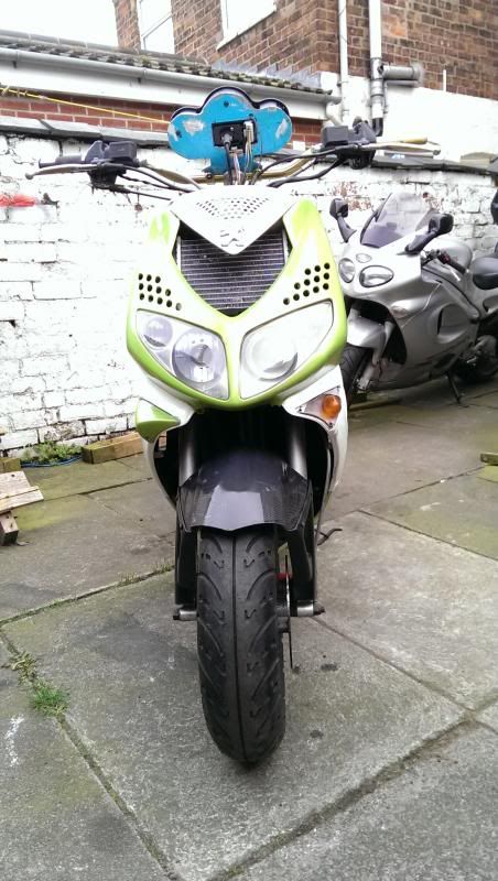

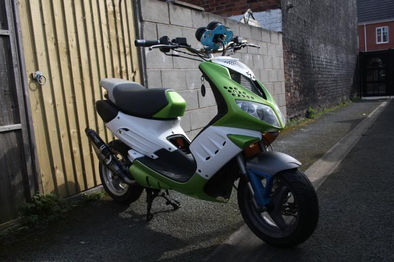

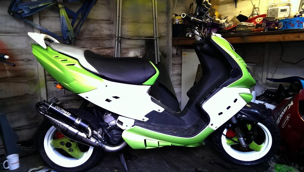

    The Speedy had the bodywork removed, bellypan painted & refitted most of it. I do have 1 problem, the Vivacity forks are hitting the Speedfight's headlights when I put it on full lock, so, if anybody knows why, please let me know.
    Want to get hold of some plastic to make an undertray, so am asking around my builder/ double glazing mates to see if they can get me some. I've got a Gixxer 1000 tail light that I want to have a go at fitting & also a carbon Fibre mudgaurd off the same bike that I will have a go at modifying. Also, seem to have a problem with coolant. Should there be a hole at the top of the expansion bottle, or does it just circulate round?
    Anyway, here's some pics of it's first time outside since the rebuild.

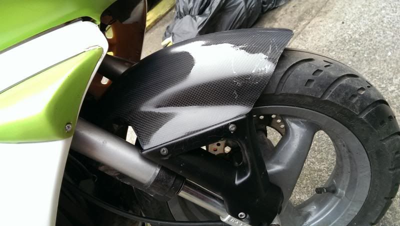

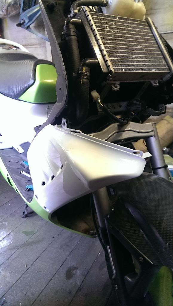

    Right, well, today was all about messing with carbon fibre mudgaurds & being disappointed at the end. Like I said in the last post, I had a carbon front mudgaurd from a Gixxer 1000 K1 & thought i might be able to do something with it. So, while the tailpiece paint was drying, I set about with a hacksaw & dremel.
    After hacking away with the hacksaw & test fitting i got to this stage. The Metal X side pieces came in handy.
    I tidied it up, drilled the holes & fitted it to the bike. As you can see, there are some nasty cracks in it, which I thought were just the laquer, as you can see later, i was wrong :(
    I painted up the Metal X side pieces black because they have lots of Glass Fibre cracks in them I sanded & Laquered the mudgaurd. This is where I got cheesed off because the cracks go all the way through, so will have to find a sticker to cover it (but I know it's there which will bug me big time).
    I cut the back of the mudgaurd off & will try to adapt something to make it look cleaner than it is.
    I do like the look of it though :)
    So, next installment will be how to fit this little tinker & make a rear undertray.

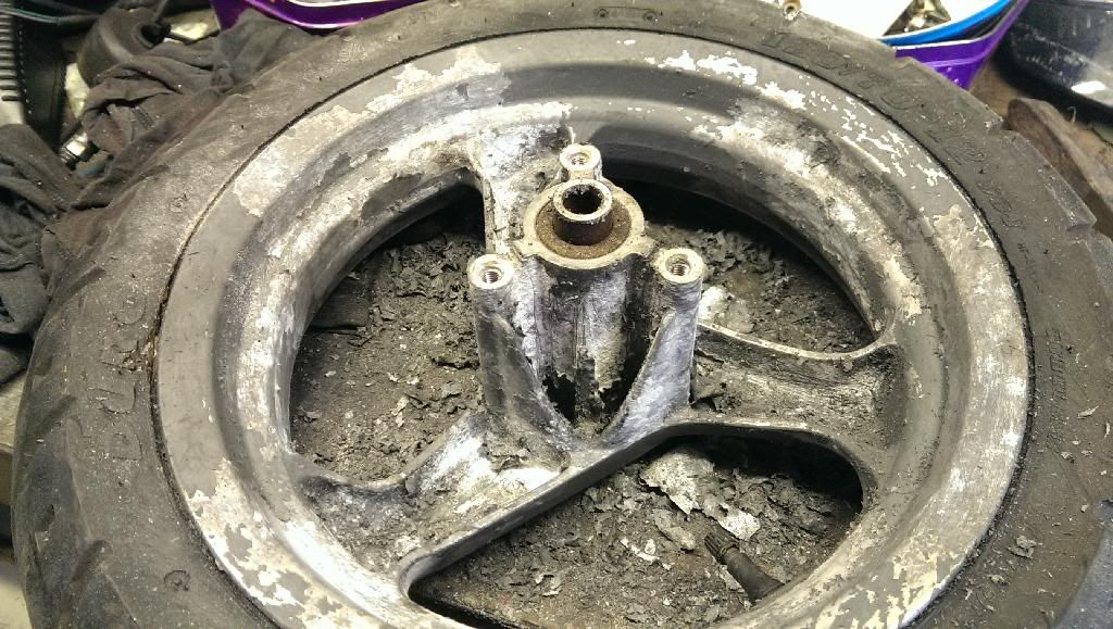

    Started on the wheels today.
    The front was a right mess, so after 4 hours on paint stripper & sanding i got it down to something like & started to paint them. I've gone & rushed them, so will be sanding them down tomorrow & making a better job. Can't make my mind up if I like them or not.
  15. turbovetto
    turbovetto Well-Known Member
    1,561
    tweaked ovetto
    I like them. Sand the living excrement out of them and then paint! MHR POWAAAA! Handy tip - sanding flappy wheels and some turps to lube are your friend.

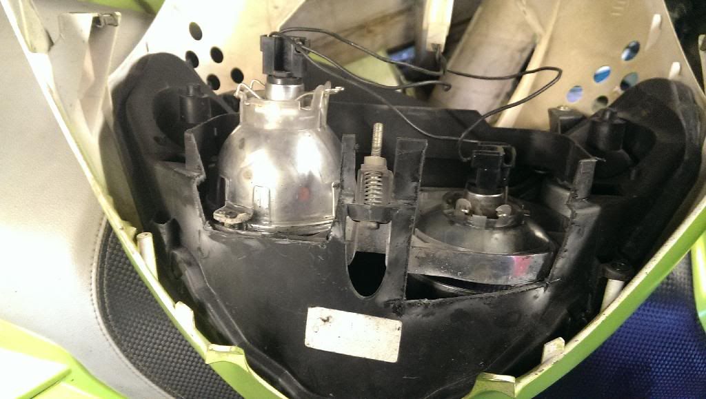

    Found out where the forks were catching......Care of my angle Grinder, They're not now ;)
    I've also filled the indicators into the bodywork, just waiting for my new indicators to arrive.
