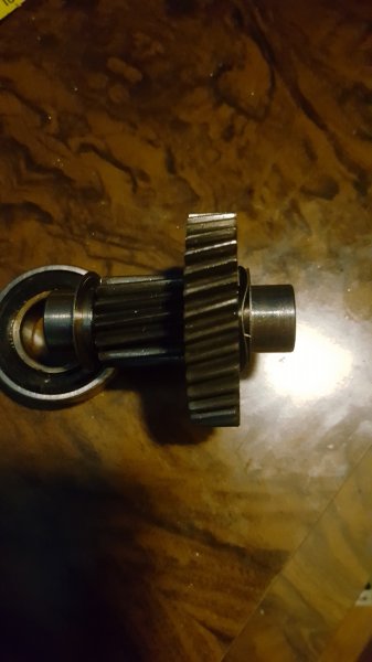

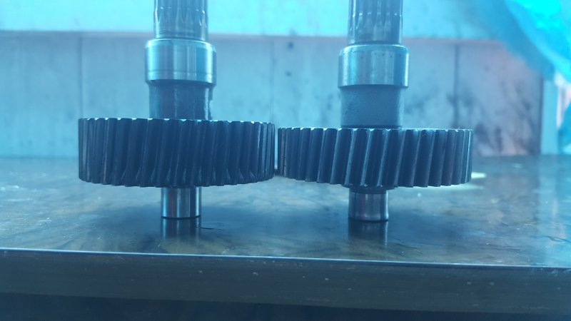

    Ok so I stripped it all down again and tried a few different things the only thing that works is if I take the washer off the front and leave the wavey and normal 1 on the back it spins freely I know it's meant to be there but what would happen if I run it without the washer also just noticed there is a few mm difference in the gears my old 1 is on the right and the new 1 on the left

    Sorry to sound numb I'm a bit confused as to what you mean I have 3 washers in total 1 wave 2 normal this is the order they go on but the final drive shaft is slightly different to mine the gear is a few mm wider
    Mine is on the right and the new 1 on the left
  8. Merlin
    Merlin Old School Biker
    2,305
    2007 TKR WRC 50
    OK. If the problem is the final drive gear (the new one you have bought) then I think I may have mis-understood. The thicker gear is fouling the gearbox casing when you tighten the bolts up, is that the problem? If it is, then the only solution is to get another final drive axle.

    Yeah that's it I've just ordered another 1 hopefully this 1 will fit haha I'll find out Tuesday when it comes and you was right with the bearing size thanks for that :)

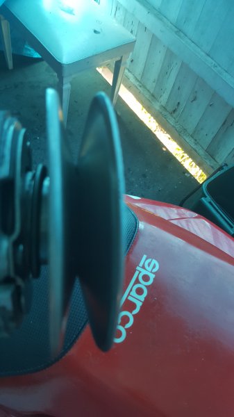

    Ok so a little update I got the original gear pressed off and onto the new shaft put new bearing in rebuilt the gearbox and all is good it moves nice and free now :) all I need now is a new clutch pulley but can't find 1 anywhere can anyone help me with where I can get 1 thanks

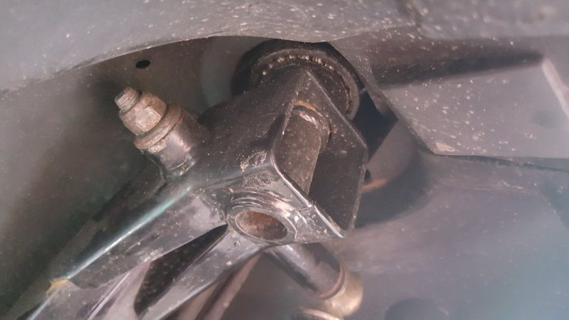

    I've got the clutch i need the pulley where the belt goes
  13. Ricky.H
    Ricky.H Member

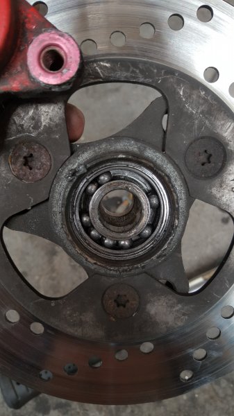

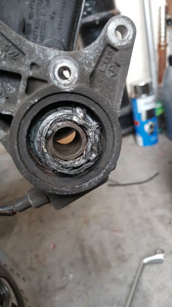

    Ok so I go to check everything over and clean only up a bit as I moved the front wheel I noticed a slight movement so I lift the front end up to check the wheel and end up finding this
  14. Merlin
    2,305
    2007 TKR WRC 50
    Yikes! That is one seriously dangerous front wheel.
  15. Ricky.H
    Ricky.H Member
    135
    Peugeot speedfight 2
    Yep lol new hub and new speedo drive

    I must admit when I rebuilt my son's knackered TKR as the Speedtrek, I automatically changed the front and rear wheel bearings when I refurbished the wheels from the original white to dark metallic grey. The only bearings I didn't change on the bike were the steering head bearings as, they were fine.

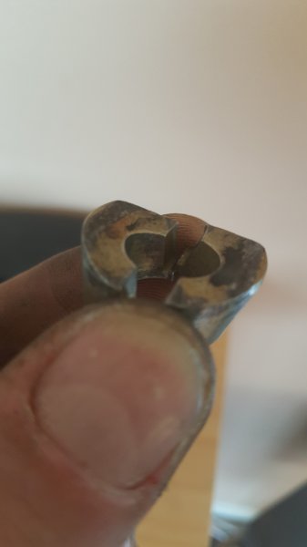

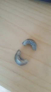

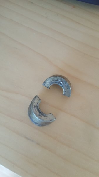

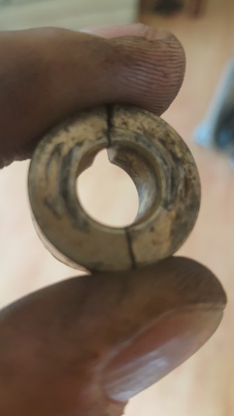

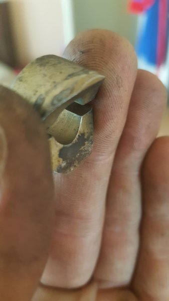

    Hi guys can anyone help me as I'm looking for a steering spacer as mine is snapped
