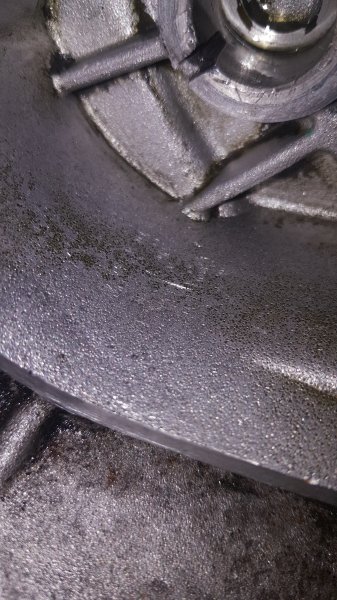

    Thanks it dose look a bit blueish inside
  2. Merlin
    Merlin Old School Biker
    2,305
    2007 TKR WRC 50
    It will be as blue as a Chelsea shirt and warped like the surface of the sea if it's knackered :p. Does it look as if it got as hot as a Phaal curry?

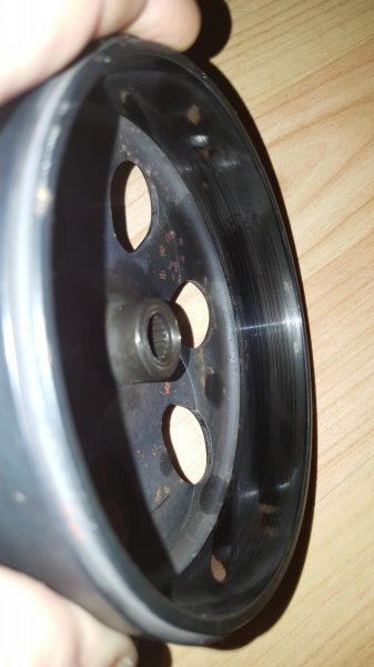

    This is what it looks like it also looks like it's been catching on the face of the old clutch you can see a line all the way round on the inside pic
  4. scubabiker
    it looks a little thin, you need to measure the inside diameter to be sure

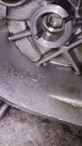

    Thanks for replying I've already got the clutch just waiting for the bearings to arrive then I can put it all back together and see if it's still knocking I've noticed some marks inside the gearbox it looks like the gears have been hitting it but I can't see see any wear in the Teath
  10. Stevep
    Possible but.......you will always have some play in the gear cogs, it's called backlash, it has to be there to take up the stresses. More than likely you have a very worn bearing.
    Don't forget to refill the box with oil:rolleyes:

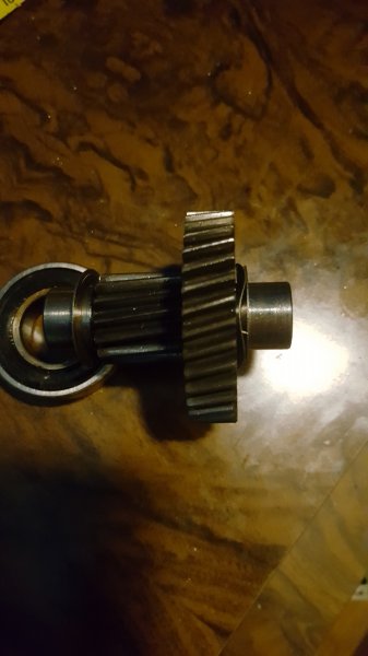

    OK, so did you note where the shims went in the gearbox when you took it apart? If you've got them in the wrong place it will lock things up. The wave washer and the shim go on the middle gear and face in towards the main transmission casting, with the shim washer closest to the transmission case. Put them both on the middle gear before you assemble the gearbox. If it locks up again, check that the new axle bearing you fitted is seated correctly, but only tap the outer race of the bearing, or you'll damage the ball bearings inside.
  20. Ricky.H
    Ricky.H Member
    135
    Peugeot speedfight 2
    There was 3 washers on the middle gear 1 normal 1 on the front and a wavey 1 and normal 1 on the back withe the wavey 1 closest to the gear and the normal 1 behind it
