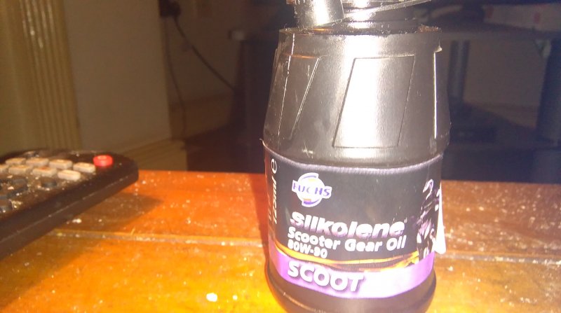

    Forgot to ask once you drain the gear oil and add this stuff how much do you put in would you need a few bottles lol
  10. scubabiker
    normally on scooters gear oil is around 300ml...
  11. SpeedyScott1
    SpeedyScott1 Member
    126
    Ahh okay as I see some at 150ml so will order 2
  12. Mark Emerson Trentham
    Maintenance figures for Final Reduction gear oil:-
    (SAE 90)
    Draining - 0.10 litre (0.11 US qt,0.09 Imp qt)
    At disassembly - 0.12 litre (0.13 US qt,0.11 Imp qt.
    That's outta the manual,when i get back tomorrow,i'll run you off the figures from the engine case,
    Don't forget to clean your Engine oil strainer screen when you change your main oil/located below an just slightly forward of where your kickstart attaches (03 model) - with that sort of minimal mileage i'd do it for peace of mind.
    Mk.

    So with 0.12 litres going back in what's what to ml would it be 1 or 2 bottles?
    Also do you happen to know what size washer the drain bolts use as going to replace that too and the o ring size?
  14. Mark Emerson Trentham
    Think that's c120ml - size of 1 of those bottles i showed you,

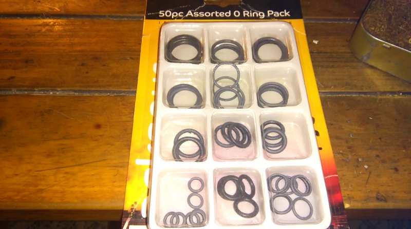

    Yeah I seen then lol was going to get a mixed bag of washers as didn't know the size lol and a mixed bag of o rings
  16. Mark Emerson Trentham
    Washers......you could measure what you have already... ;).,as for o-rings/ditto,
    £4.00/though there are some larger amount specific sizes ,always a no brainer weighing up against the cost of the 'actual' + you have spares,esp.if their in tens :). IMAG0164.jpg
