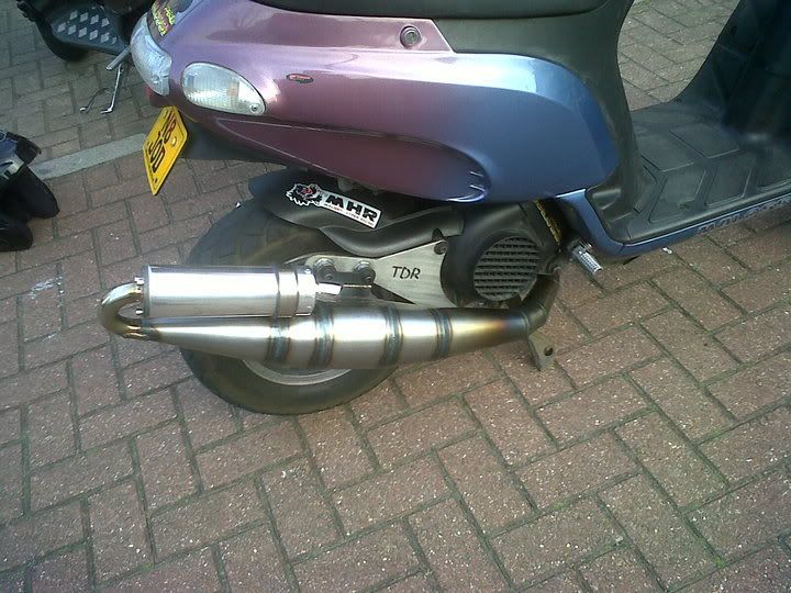

    Sneeky peek at the newest prototype fitted.
    hav`nt had time to put any pics up on our website but i will.

    looks even better on my mates typh although on a typh u cant 12 anymore as it scrapes tis a gd pipe so far, needs to be setup yet just over reving

    i like dat typh's and that number plate is to sick .saw it shack past me yesterday was sounding very nice .
  12. MiNoR cOnFuSiOn
    oi that typh looks nice you know..... any other pics of it?
    jus load the rollers up untill the revs drop off... :)
  13. jj180

    yh man exactly what it needs and yeah ill grab u some porn, specifically a pic of the brand new nobbly on the bk awwww, hes still blating around with 12.5 revvvvvin to fuk
  14. MiNoR cOnFuSiOn
    ye, the tdr pipes make good low down power..... meaning you can load the fuck out of the rollers and still not really loose any revs, you will just gain acceleration.. its the point your revs start to drop off the faster you go you need to stop and go down half a gram..... even then with this exact pipe, it wouldent slow it down, as it pulls almost as much at peak power as at the bottom of the range, so you could technically roller this one down to drop the revs RIGHT off (as in kill them completly) and let it use the torque... ie, running round at 6,800 rpm. it wont loose any speed. dyno shows it has power at this rpm so it will still pull at this rpm the same as it would at a higher rpm...
    throw some stock runner weights in there an see how it does.... would probably love half and half but ye, get playing..the fact its revving its tits off is NOT a good thing for this pipe.. your just wasting any real improvment.. if youve seen improvment then fuckinell your gonna love whats to come once its rollerd up right :)

    oh of course lol blaitent gain over standard obviously, but yeah can easily tell its sooooo thriving for more and the fact we havent played atall and can tell its got loads more potential already, gonna try get on it within the next week so its set up and flying
