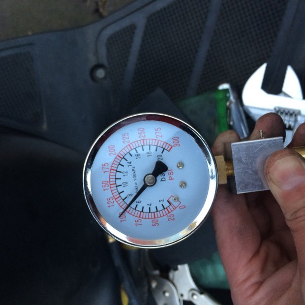

    Sorry guys I reacted like that because I thought he was either having a go or taking the piss. Apologies! Got a adapted to fit the compression tester and got 100 psi is that ok?
  10. scootzmadness
    100 psi is good.
    So that narrows it down to a air leak or wrong jetting.
    Most probable is air leak. Is there a GOOD gasket on the manifold? if not, fit a new one with a quick dab of gasket gunge, dont just use gasket gunge on its own. is the manifold cracked/perished/rotted at any point? if so replace. Does the carb fit onto the manifold securely and correctly? Is the air box secure and as with the manifold, does it have any cracks/perishment/rot? is there actually a air filter in the air box? if all of that is ok... then its time to start looking at jetting. Get a pack, work your way down from the biggest until its spot on. We cant tell you the exact jet because its different for every scoot regardless of the make/model.
