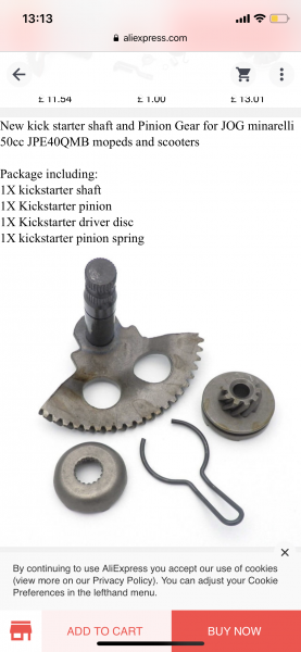

    I dunno what you lot were going on about the bendix I looked it up and this is what I think I need?
  2. GreenRanger
    GreenRanger Member
    222
  3. scubabiker
    That's it, but that's a piaggio one and not a Morini.
    That little sticky out bit of the spring thing needs to be at about the 7 o'clock position in that bit there.
    Looks like the mechanic put it in wrong and you just followed what he did.

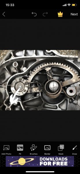

  7. scubabiker
    Second to last pic,
    The sticky out bit of the spring is at about 3 o'clock position.
    It needs to be at about 7 o'clock ish.
    It will only go in one way there.
  8. GreenRanger
    GreenRanger Member
    222
    I’ve uploaded a pic. Should it go in that little compartment then?
    That’s 7 o’clock mate...

    Did you have a look at the pic I uploaded with the arrows? Is that the correct position?

    I sent to you an updated pic. Where I put the arrow is that where the position of the spring should go?
  11. scubabiker
    Sorry I was out.
    Yeah that's the right place.
    Give it a try.
  12. GreenRanger
    GreenRanger Member
    222
    No worries ok mate will do and let you know. Should it be locked in that little slot bit or not?
